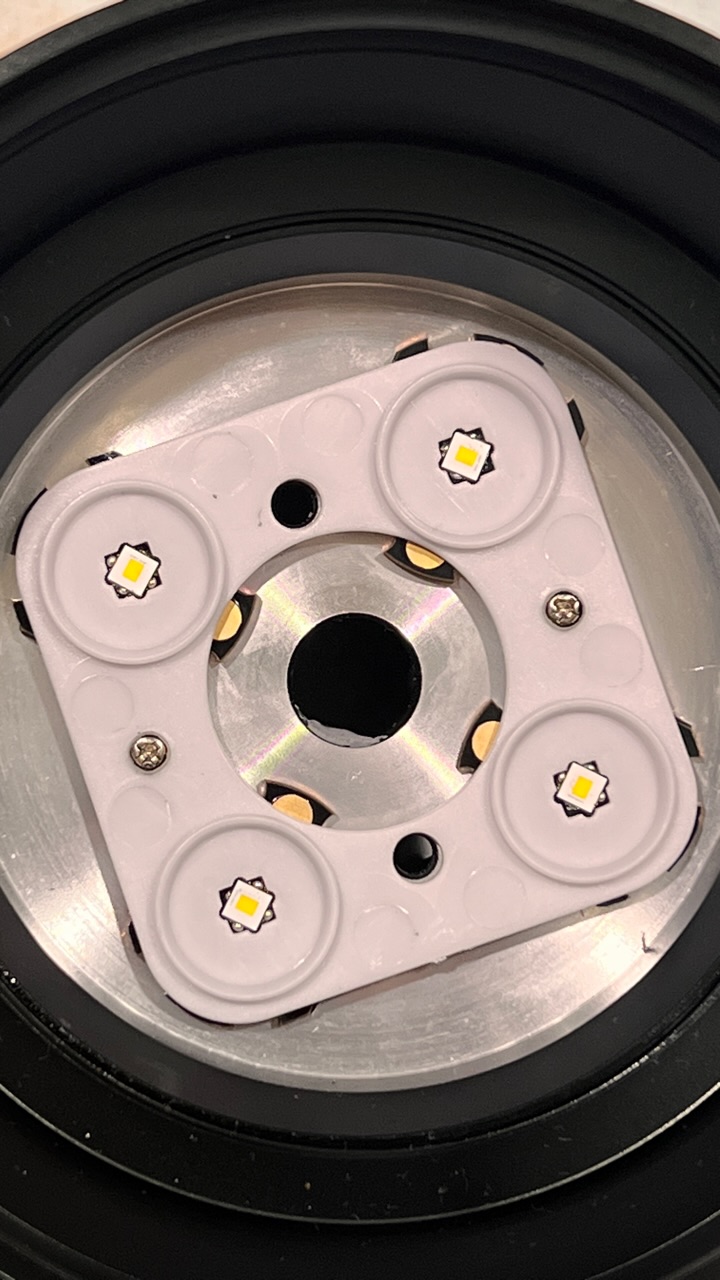

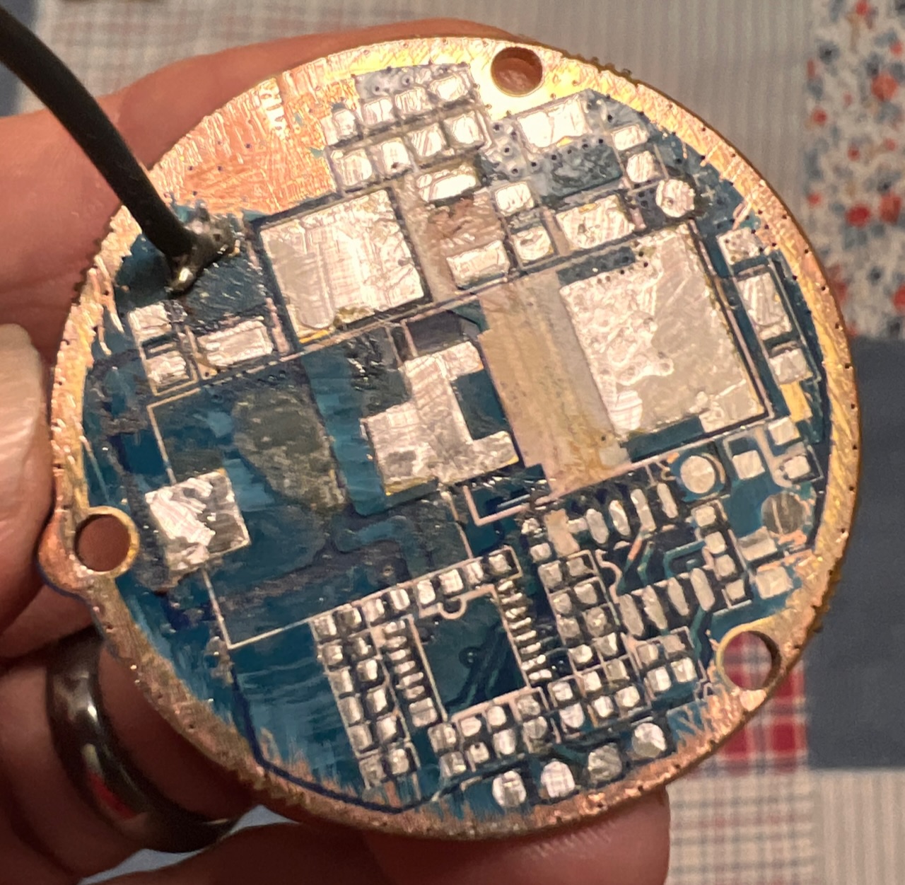

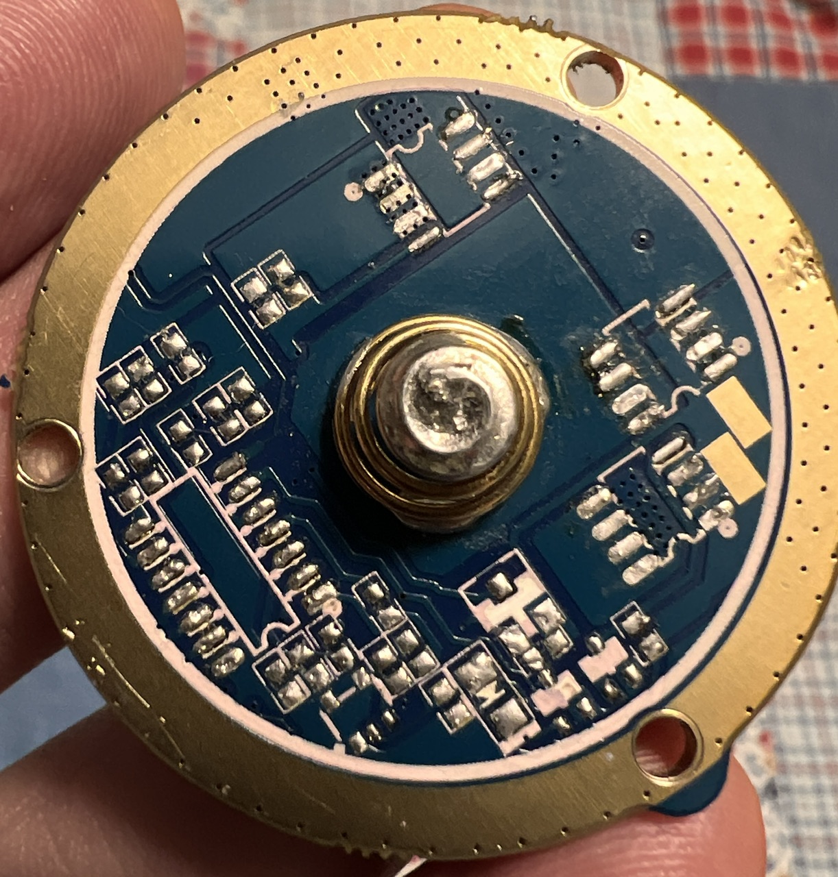

Started a conversion on a Thrunite TN40S. Rebuilt the carrier to 4P configuration to supply an FET+1 with Anduril. Will swap out the XP-L HI’s for MN1 W2’s.

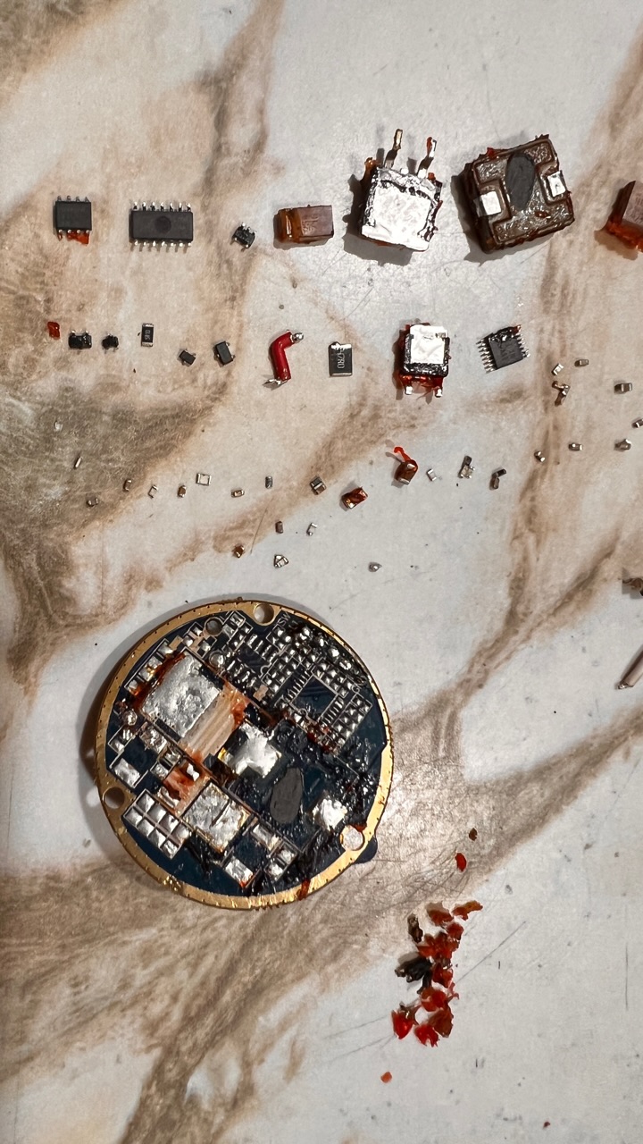

Got the dirty work of the carrier completed, ready to attack the driver and clean it off in preparation for the piggyback… tomorrow.

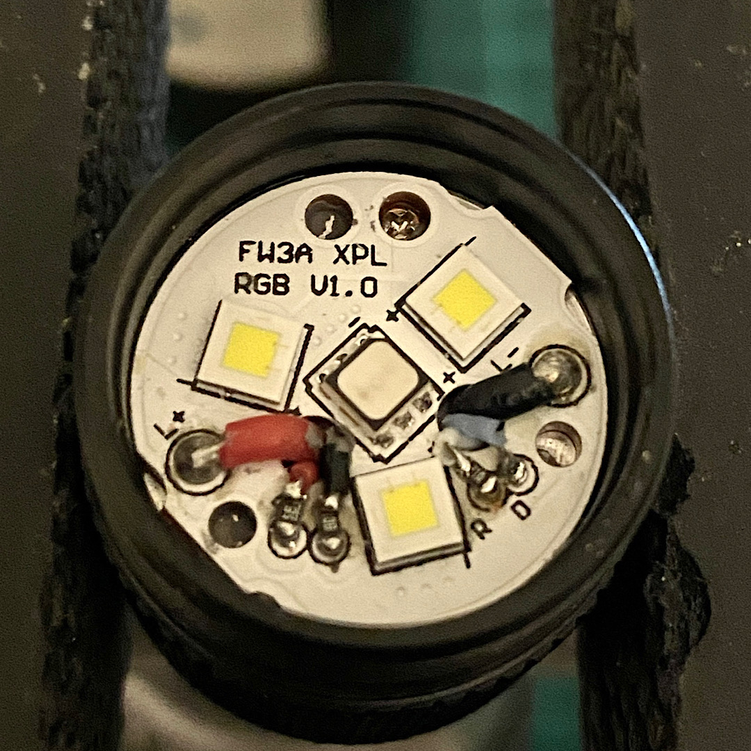

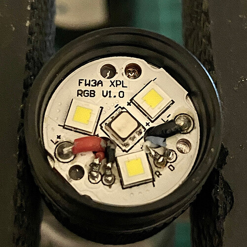

FW3X: add resistors, firmware upgrade, change fuses parameters. Now is near perfect
Committed to the Thrunite TN40S upgrade.

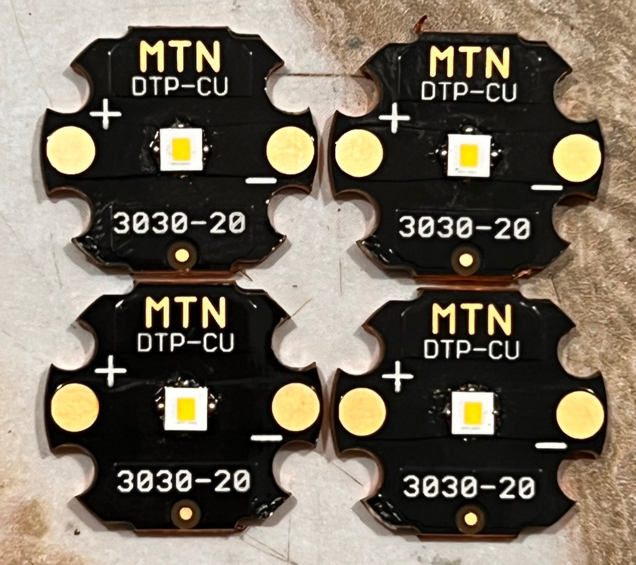

And reflowed W2’s to proper MCPCB’s , so now I just need to get an FET +1 flashed with Anduril and construction will begin! Lol
what kind of upgrade is it? direct drive after ripping off all the components?
Vandalism :upside_down_face:
Essentially a D4V driver will run four W2’s . The XP-L HI in series set-up was never very impressive in this light.
Something like 58 components on the Thrunite driver.
Should be 8 components on the new driver.
Why?:grin:
