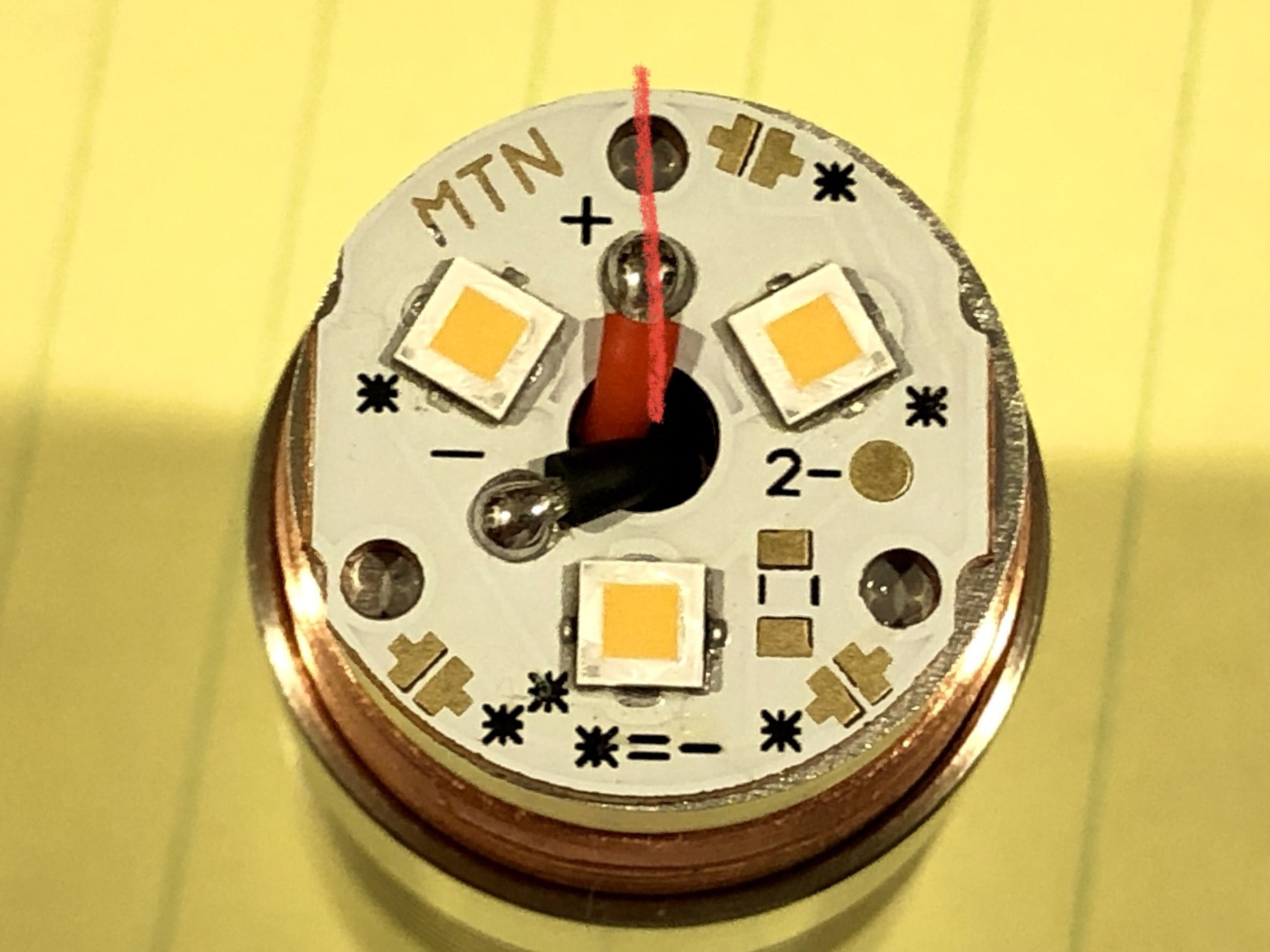

Made my last dedomed 519A triple, this time with a Ti S2+. Now I have all the dedomed 519A CCTs, and all are triples. No need to show the steps with it, since it’s been done so many times before. But I wanted to highlight a couple things.
First , I removed the black paint from the pocket clip and shined up the stainless steel using sandpaper. I think it looks much better with the Ti than black.

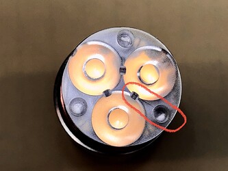

And second, I experimented with the position of the 10511 Carclo optic in order to improve the beam. I normally place the line that’s on top of these Carclo optics at the 12 o’clock position on the MTN MCPCBs. But with dedomed 519As, I’ve found that may not be ideal.
With these particular dedomed 5700K 519As, rotating the optic clockwise made the beam much better. Before it had an uneven blob on 1 side, but rotating it made the beam a nice circular blob.

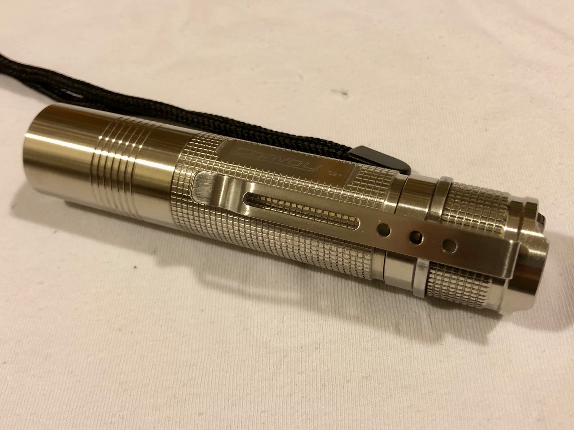

If I had gotten the stonewashed version, I would’ve left the clip as is after I removed the paint. It seemed like it would be a pretty good match.
Here’s a pic in case you’re interested:

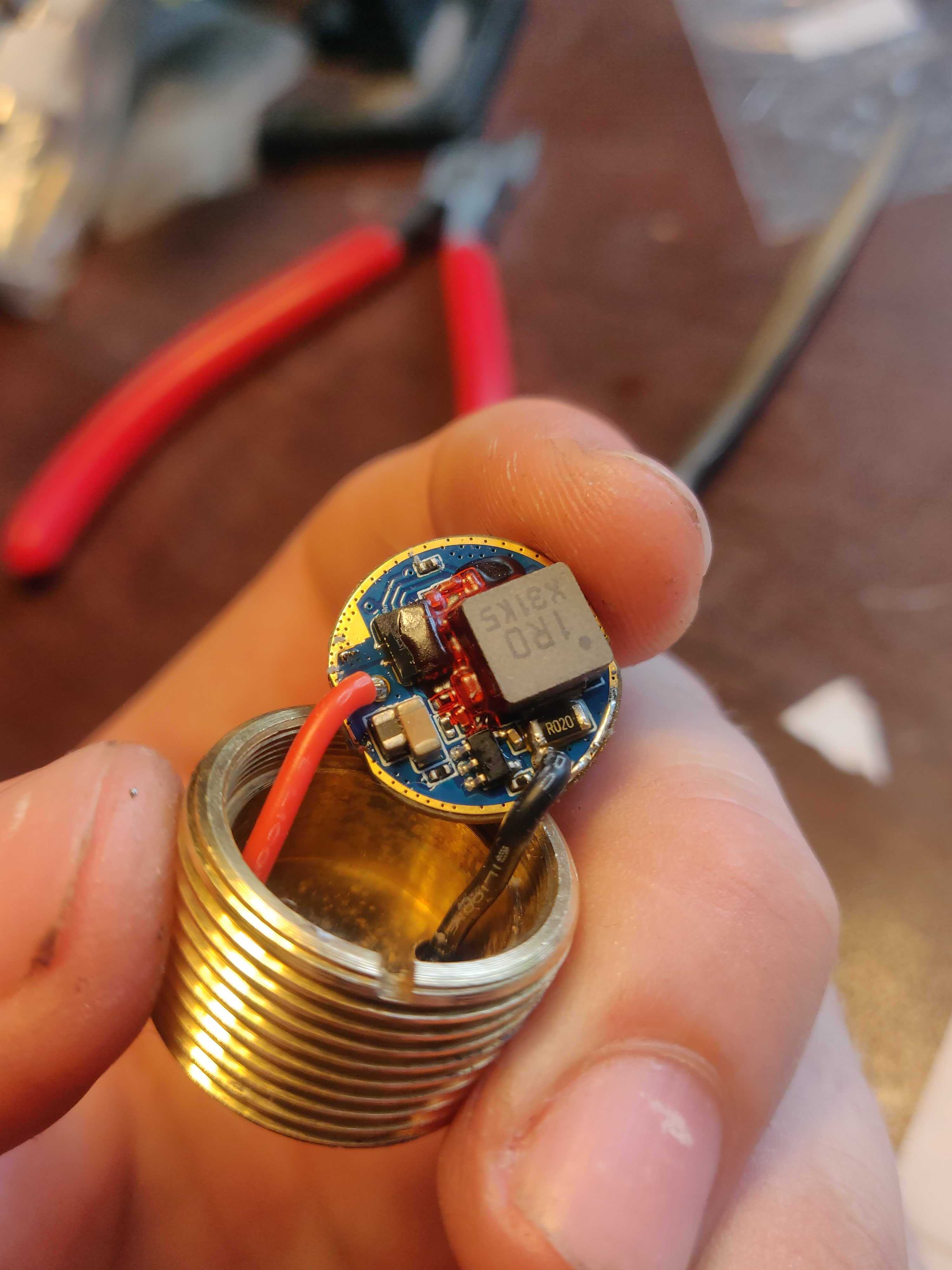

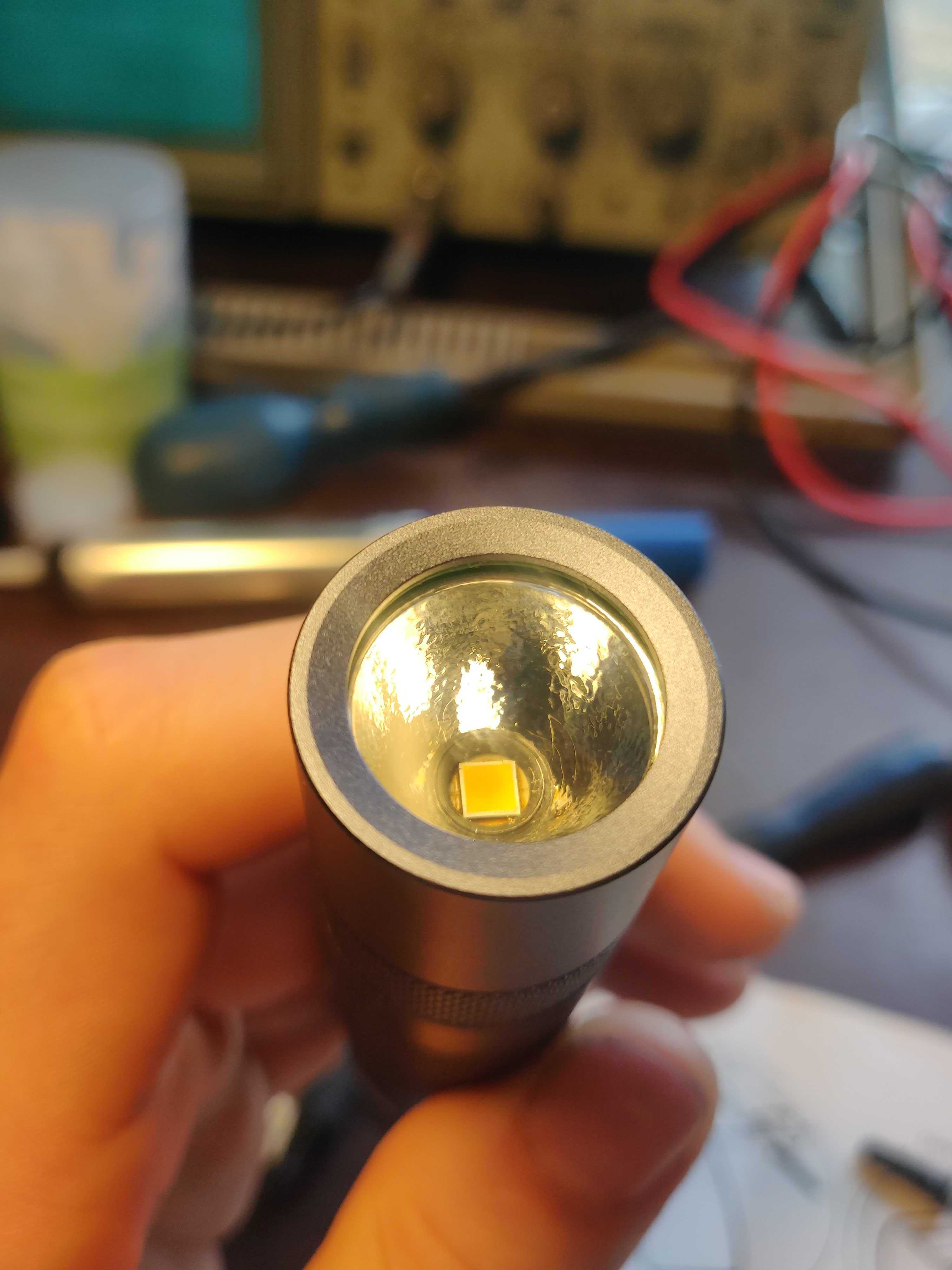

Today I put together an S2+ with a 4500K B35AM and one of Convoy’s new 17mm 6V boost drivers. I swapped out the sense resistor for an r020 to halve the current to 2A. A big benefit is the low mode is now much lower; a proper moonlight. It seems very close in brightness to the lowest mode of a BLF A6 with xpl hi, which is my standard for a useful moonlight mode. I don’t normally use such a cold light but the tint is great so it has won me over. It blows the getian fc40 4200k out of the water in terms of tint, though I may have just been unlucky with the fc40 I received.

Awesome! I think I have that same driver and emitter on the way. Is 4A too much for that LED? I just got a resistor kit so maybe I’ll do this exact mod.
Very nice @Merlot . Likewise All the FC40 I tried had bad tint :expressionless:
4A is too much yeah, I would say 3A is a good maximum with Eurekatronix boards.
Thanks guys. The eurekatronix boards are especially high thermal conductance, so 3A is safe. Normal non-dtp boards (such as convoy) the safe max is less, maybe 2-2.5A.

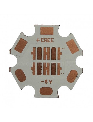

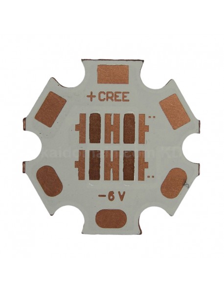

Now I’ve got a Convoy S11 that needs a new emitter. I’ll use the 12V driver for a high powered 3x series UV S12 build. I’m not sure what to do with the s11 host though, I suppose an xhp70 is the obvious choice but I’m not a massive fan of the tint. I might try something weird like a clumped together tint mixed quad of 519a or b35am, on a board like this:
Alternatively I could put in a single 519a with a 4A buck driver, but that seems pretty underpowered for a light this size.
