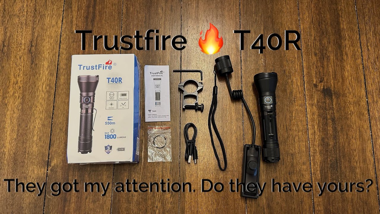

I saw something in a video by Marc Gossling that blew my mind And had to try it.
The tail cap of the SP35T works perfectly with the Wurkkos TS22! I couldn’t believe myself I had never tried… even the momentary function works flawlessly.
I swapped a warm XHP70.3 HI in the Ts22 and now is my daily carry.
And the funny thing is that that video was a review about the Trustfire T40R :rofl:
I even ordered a new tailcap from sofirn.
I’ll link the video so you guys can see.
