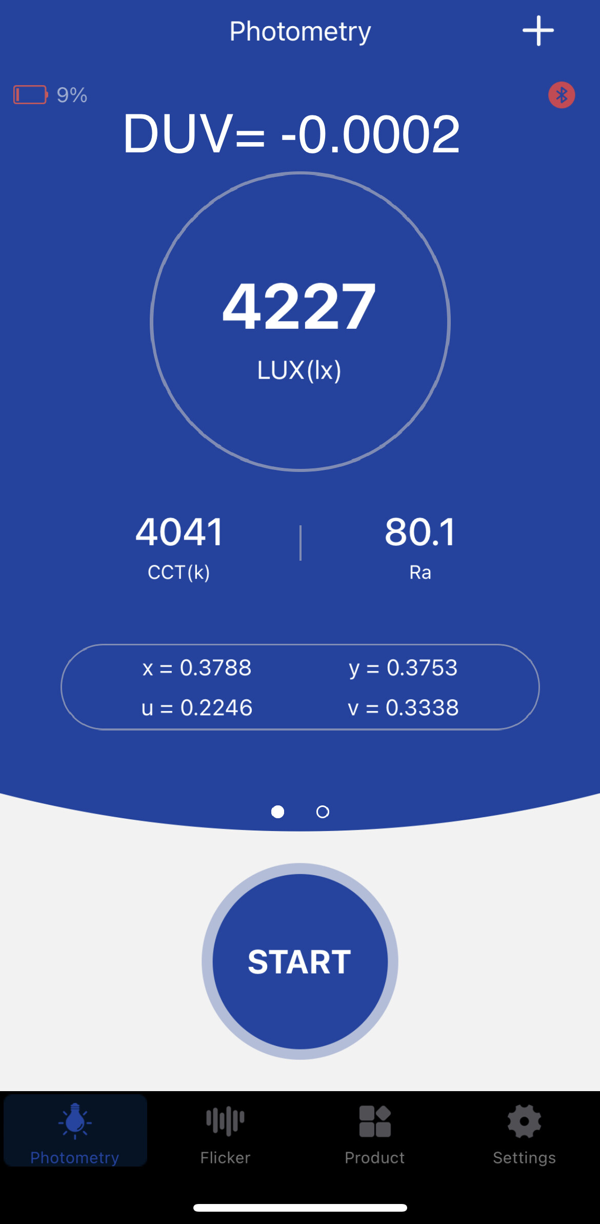

Swapped a 4000k 80cri MT-G2 from aliexpress into an Emisar D1v2. It was not the cleanest soldering job but it worked.
6 Thanks
The tint seems to be not bad?

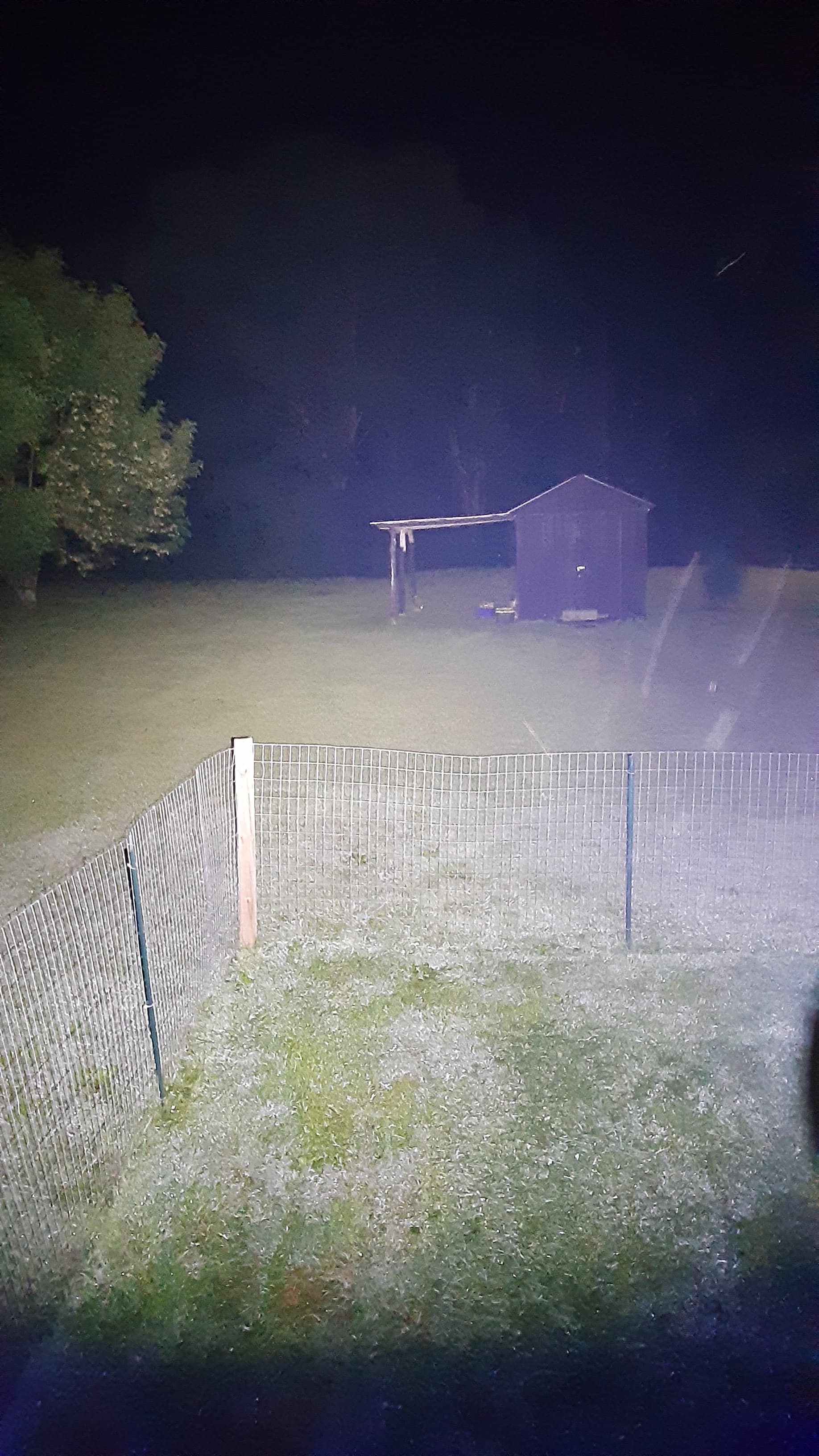

3000K 90CRI sfn55.2 in a KDLitker C21 with a convoy 12a FET. Total cost, <$25. Is it possible to make a brighter 90CRI light than this for <$25?
DUV could be a little lower. Beamshots taken with an 18650 in a sleeve, even though it’s a 21700 host, because I fear it’s full power…and cuz the springs are a little long, didn’t want to dent any terminals…but mostly the power thing.
Simon claims this driver with an sbt90 pulls 18amps. This emitter has a lower Vf than the sbt90 if sketchy chinese graphs are to be believed. Sure feels like >12amps, but I have no way to test. Sorry for bad beamshots, I’ll edit in better ones later, the bugs were attacking me.

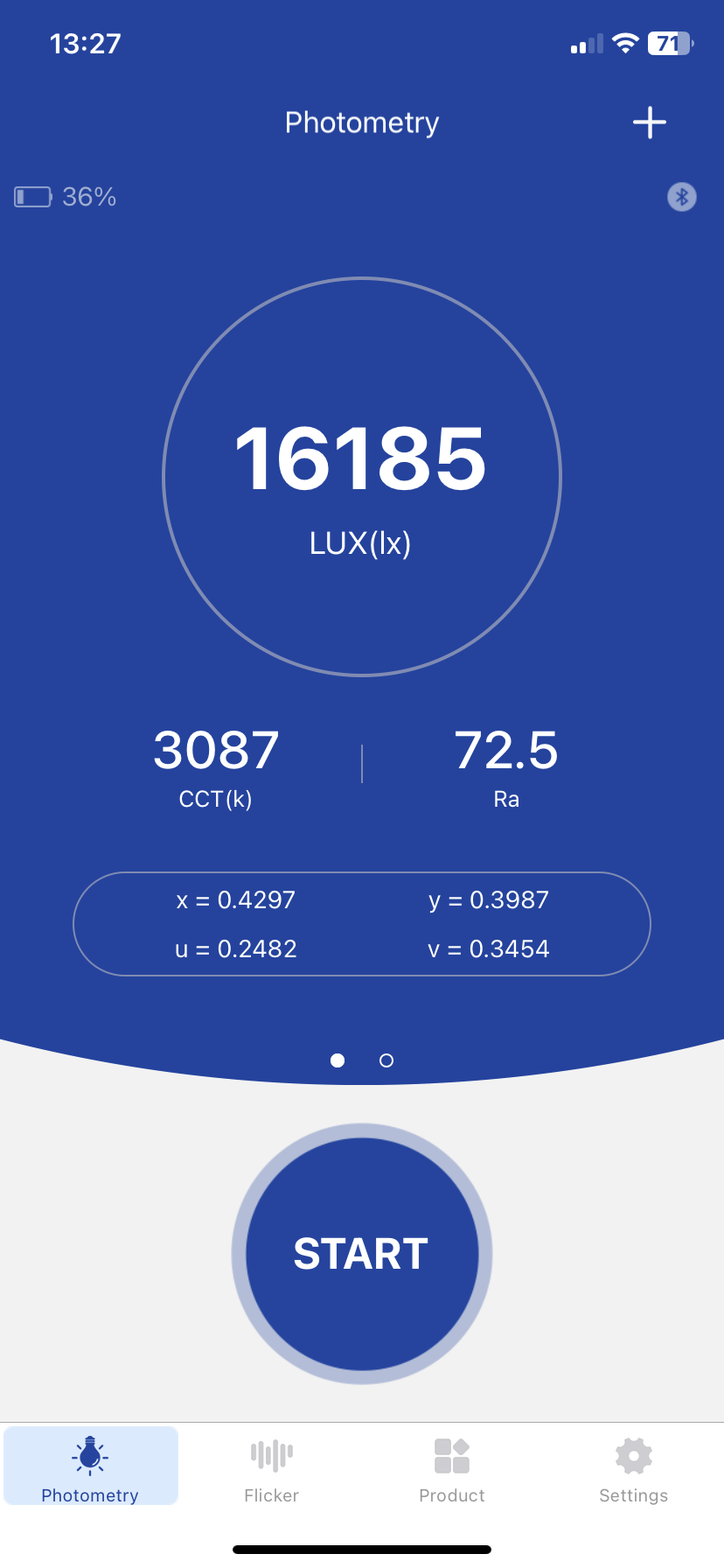

FW1A Pro Yinding 5050 3000K
I am honest… is very beautiful tint
My iPhone don’t do good pictures and I can’t lock the white balance so some numbers can help if you want to buy. :man_shrugging:
I think I have to try dcfix…
EDIT 4 July
Tint in last pic is very similar to what I see but a little less rosy because probably iPhone with procam auto correct colors and put less red. In real there is more rosy.
It’s not a super rosy DUV but to my eye it is a really nice tint. Pretty bright and floody as well.
Supposedly the bin is 2-step 80cri 4000k.
