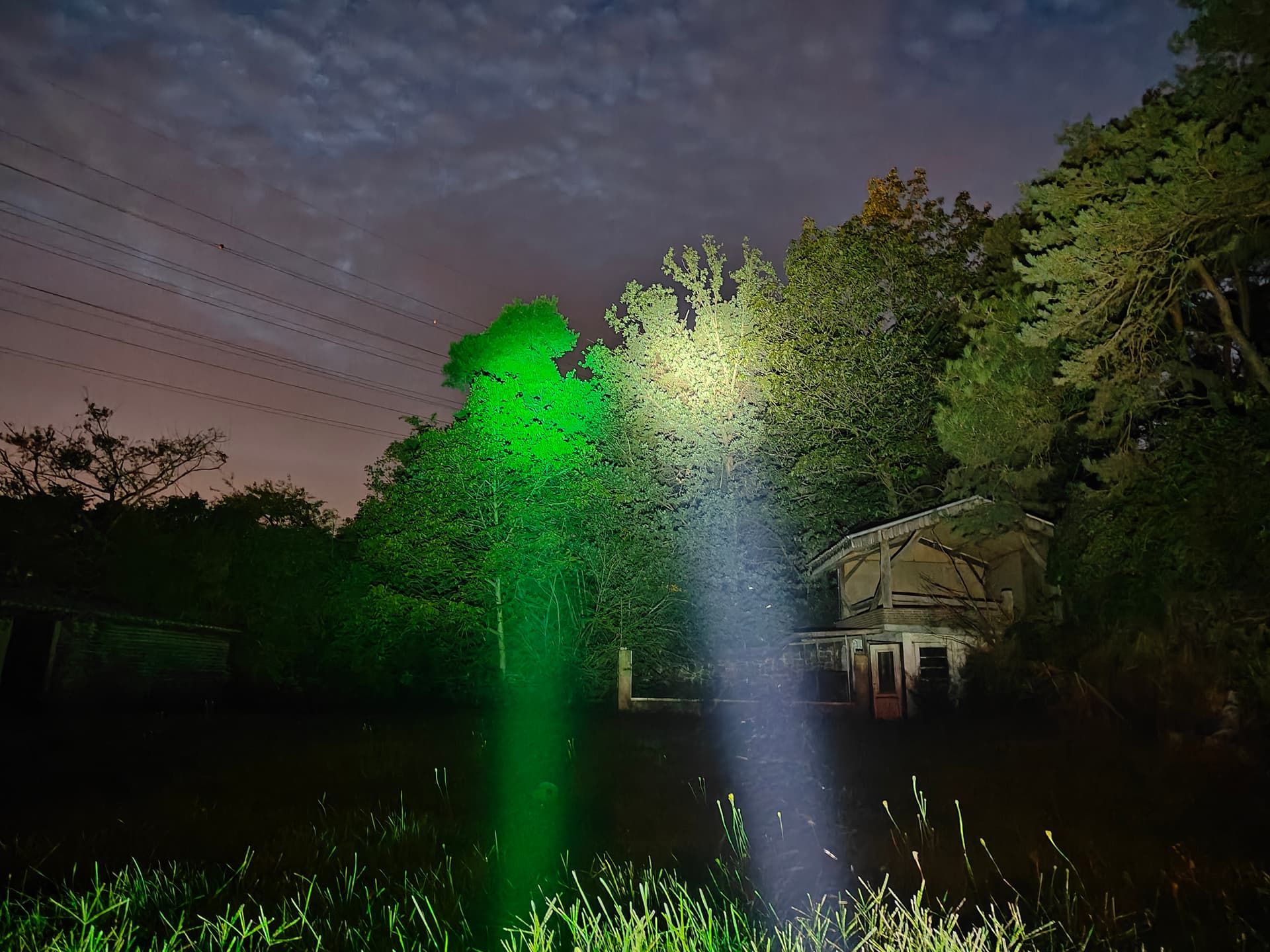

So I got a partial delivery from KaiDomain. Anyone else ever get only a partial order, do they ship the rest afterwards ?

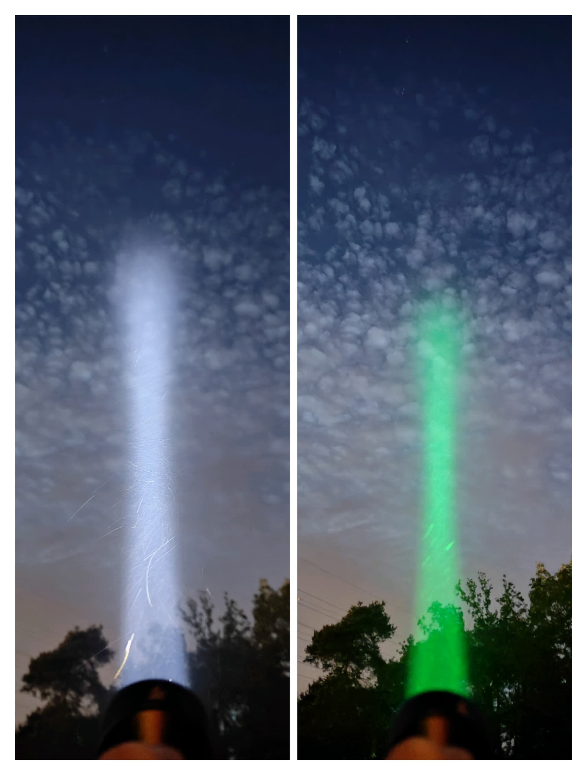

“yinding” L50 green
Host: IF22A
Reflow:
It’s alive!
Moonlight comparison to stock IF22A (SFT-40 6500K):
The hotspot looks smaller and cleaner with less spill, because of smaller LES and round die. My phone is not the best to show this but it is very apparent IRL.
Low to turbo:
SFT-40 does appear brighter in a dark room but also has a bigger hotspot. I’m also wary of the current, I don’t know if the L50 can handle whatever the IF22A puts out. 8A? For now it seems fine.
I will post some outdoor beamshots when it gets dark.

Beamshot comparison:
