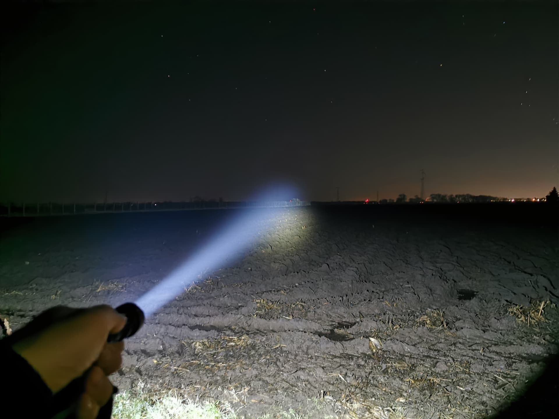

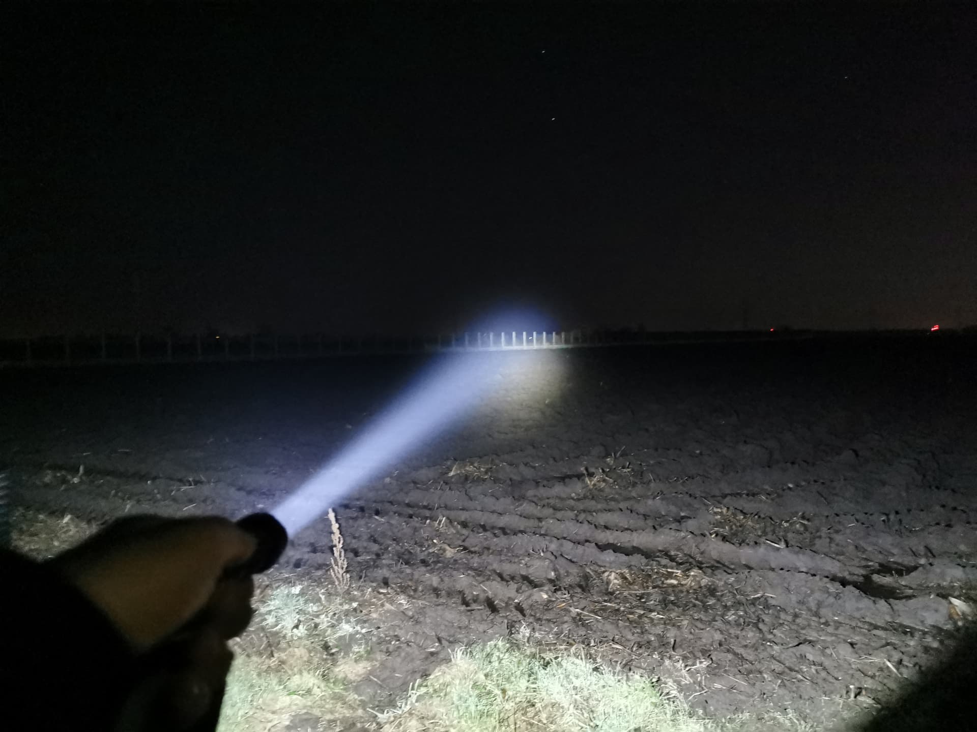

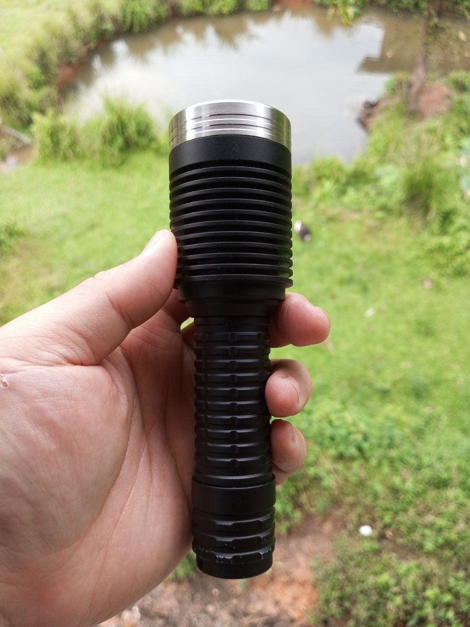

Updated one of my very first builds, on one of my favourite hosts still, the DongDongHai DDH-D2G
Upgraded to Convoy 8A buck driver and SFT40 3000K high-CRI
3KK on the left, 6500K on the right.
Lumens loss is noticeable, but still sufficient for practical use. And the trade-off isn’t that bad in exchange for quite nice colour and CRI.
And this is where individual taste speaks out. I’m happy you like this 3000K which means it suits your taste. For me the 3000K looks creepy like ā€˜hell mode’ while the ā€˜pure white’ looks optimistic like noon in the summer :wink:
It’s more likely because my camera is !@#$ and doesn’t do night shots well. It looks way better irl. I had to shoot this at 12800 ISO and that screws the colours up all the way to !@#$. 3000K is a warm soft comforting glow in person.

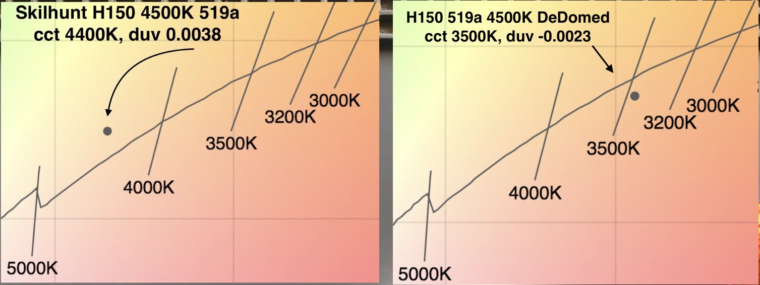

Just a simple 519a 4500K DeDome:
Imgur
before, 4400K, duv 0.0038
after 3500K, duv -0.0023:
dedoming dropped the CCT by 20%, and lowered the duv by 0.0061

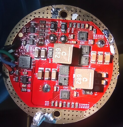

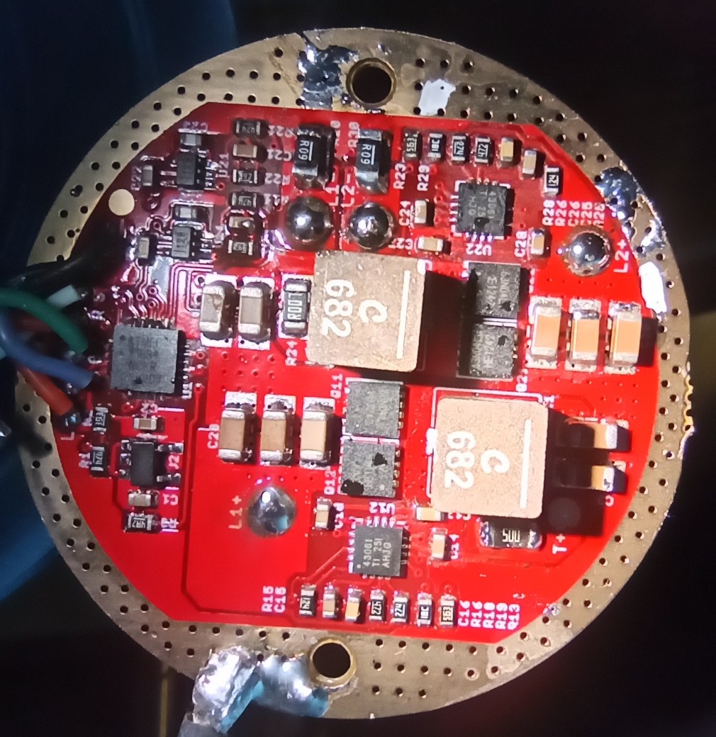

Today I played with Noctigon M44. Swapped some sense resistors for 3,2A@24V times 2.
If I get one I’ll do that mod, can you post what values you used and which resistors they are?
Up there next to screw hole with R09’s written on them. It’s 15mOhm piggybacked with 90mOhm for both channels, which by my stock driver measurements should have been 3A out, but ended up being 3.2A. I think clamp meter inaccuracies might be the culprit. I measured stock output to be 1,94A per channel.
Thanks, also what size are they? Gonna order some and I’m not too familiar with SMD components.
1206 size. If ordering some, might as well order 13mOhm ones. Then there’s no need for biggybacking. I just used what I had and therefore had to stack them.
