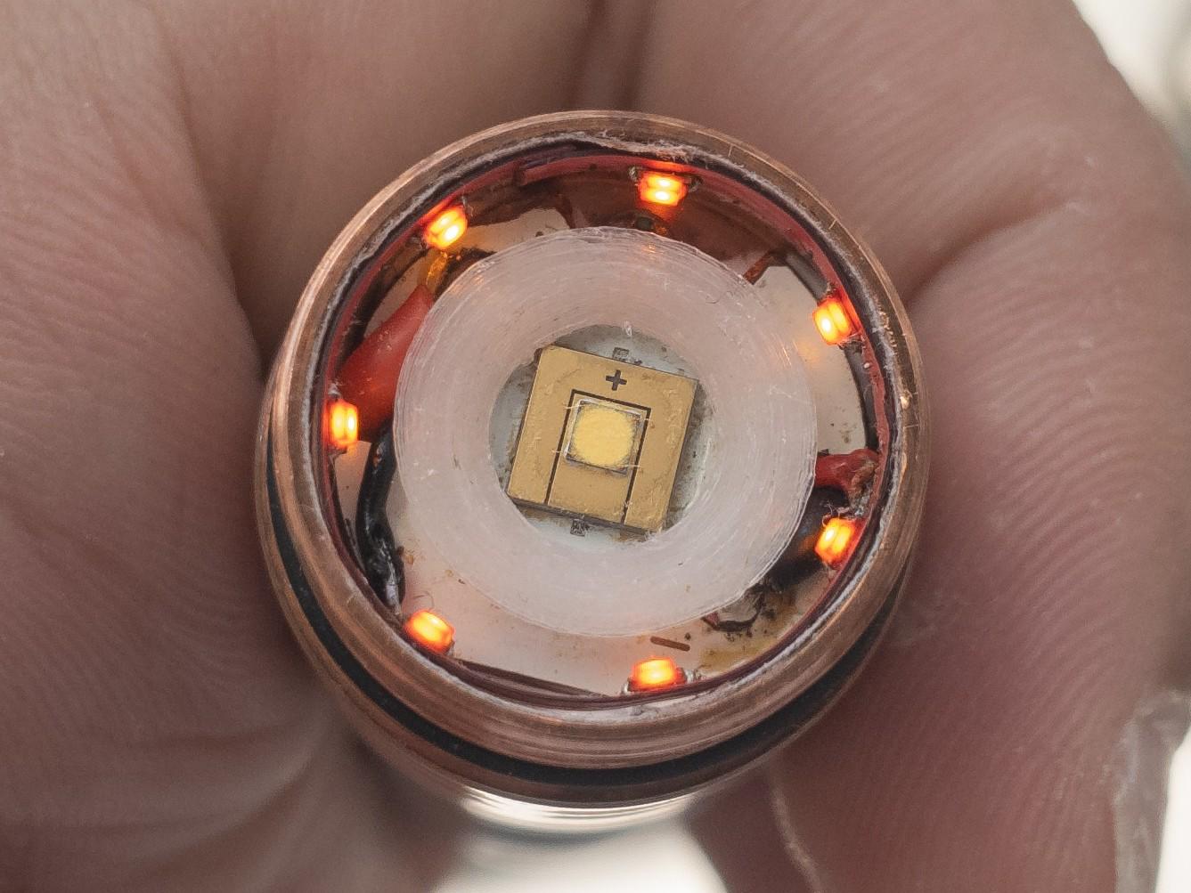

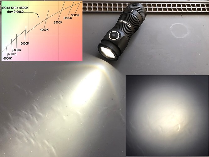

I put a 519a 4500K into a Sofirn SC13

I would not recommend the process I used to get the press fit bezel out. (hammer and screw driver)
And Im really not thrilled with the green tint of the 519a. Overall it was just a proof of concept, that proved to me that it was a waste of time.
The mcpcb I used is not screwed down, so I will not be suprised if the LED does not survive the thermal challeges… I only used thermal paste.
Would be better w thermal epoxy, after a DeDome, or a different LED that is less green to begin with. But I already hammered the bezel back in place and have little motivation atm to redo the mod.
win some, lose some… oh well

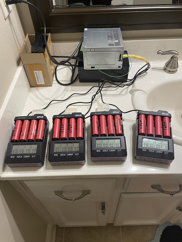

I finally got around to Modding a PC power supply for my Opus chargers (still have to add a switch and some feet )— It runs the OPUS on the Charge Test flawlessly with a lot less clutter than 4 Liteon PS

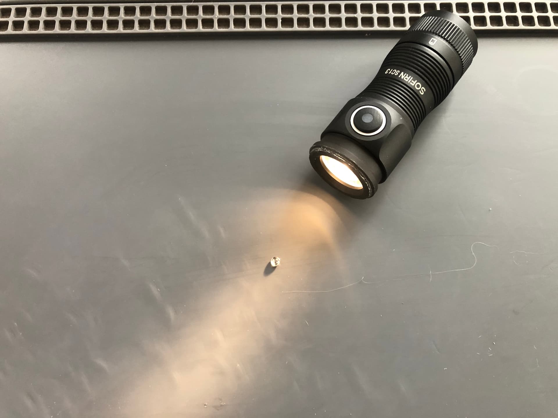

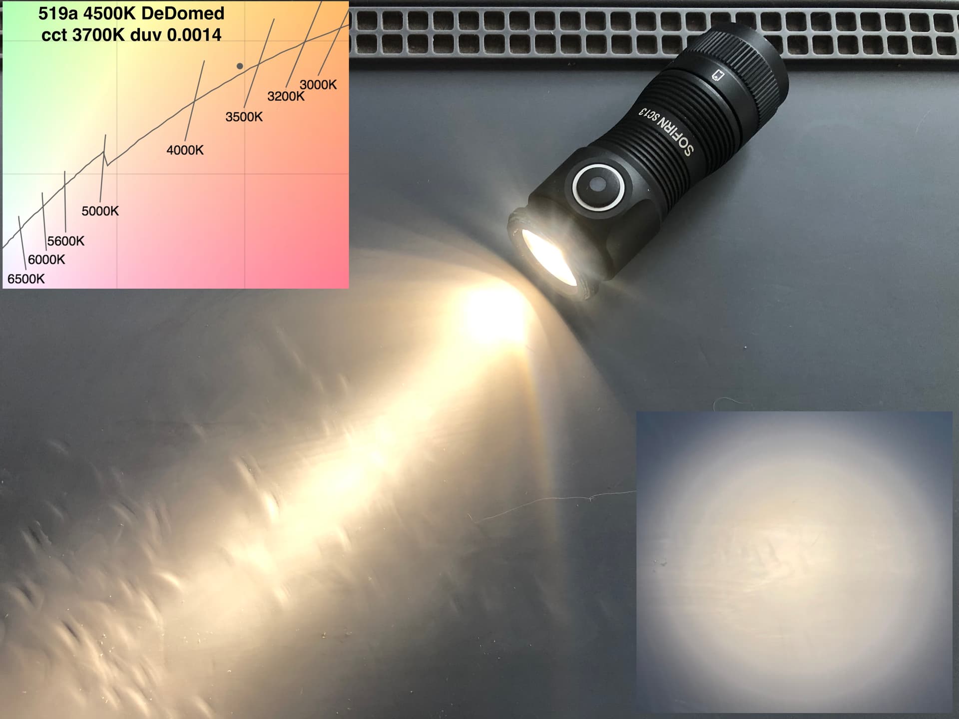

Dedomed the 4500K
highest DUV of any DeDomed 4500K Ive experienced:
overall an example of a bad mod… oh well
cant make a silk purse out of a sow’s ear
