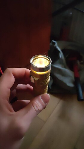

Here’s the next iteration of the d1v0:
I wanted to braze it but I went with jb weld (the thinking man’s brazing) instead as its what I had to hand. The copper section is a cut down 28mm end feed plumbing fitting, which happens to be exactly the right inner diameter. It has an inner lip that the SS outer bezel is pushed up against to square it, and the aluminium bezel is at the bottom threading on to the head of the light.
Its surprisingly light; I expected the copper to add much more weight but its not really noticeable at all.
