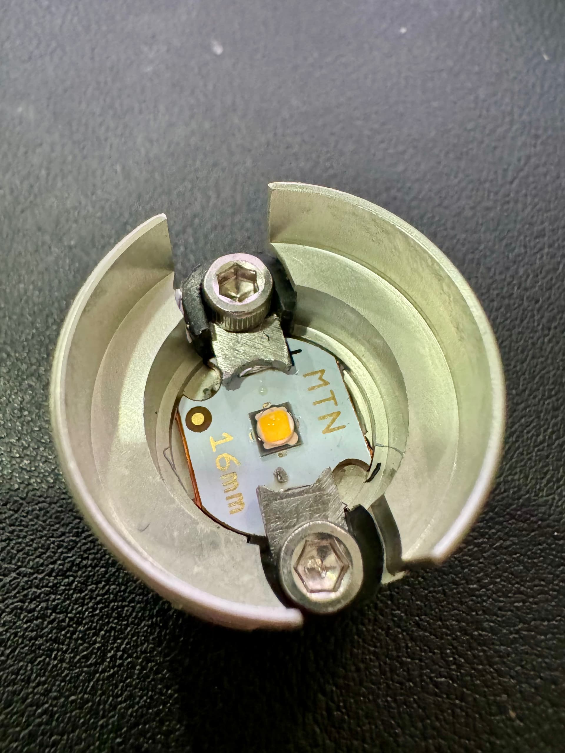

I dedomed my Frazlabs lights with 219C 3000k, but they turned purple afterward. Maybe I made a mistake and damaged the phosphor layer. I plan to replace them with 519a 4000k soon.
Wait, did you slice or dedome it? Only the 519a has glass over the phosphor to protect it iirc.
I didn’t know that, so I dedomed it by peeling off the flexible plastic cap, thinking it was like the 519a (I had done a few 519a dedomes on D4v2 before). And I paid the price for it :laughing: Luckily, I still have a few 519A LEDs here, and I’ll replace them when I have time.

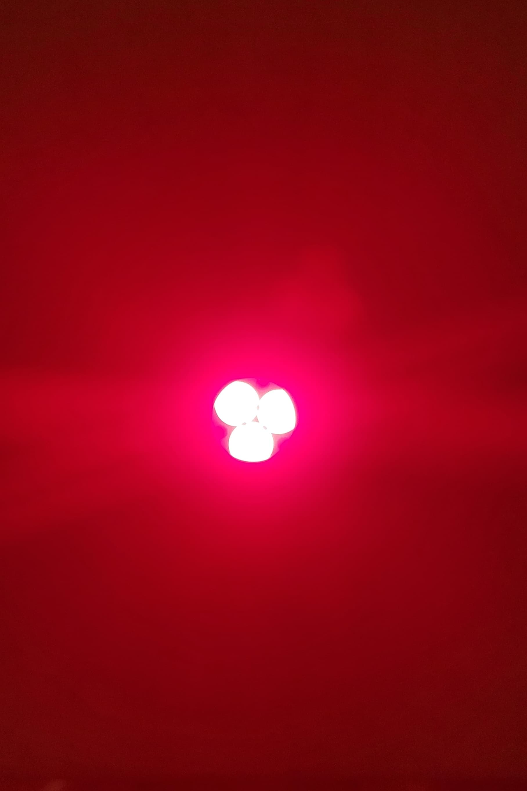

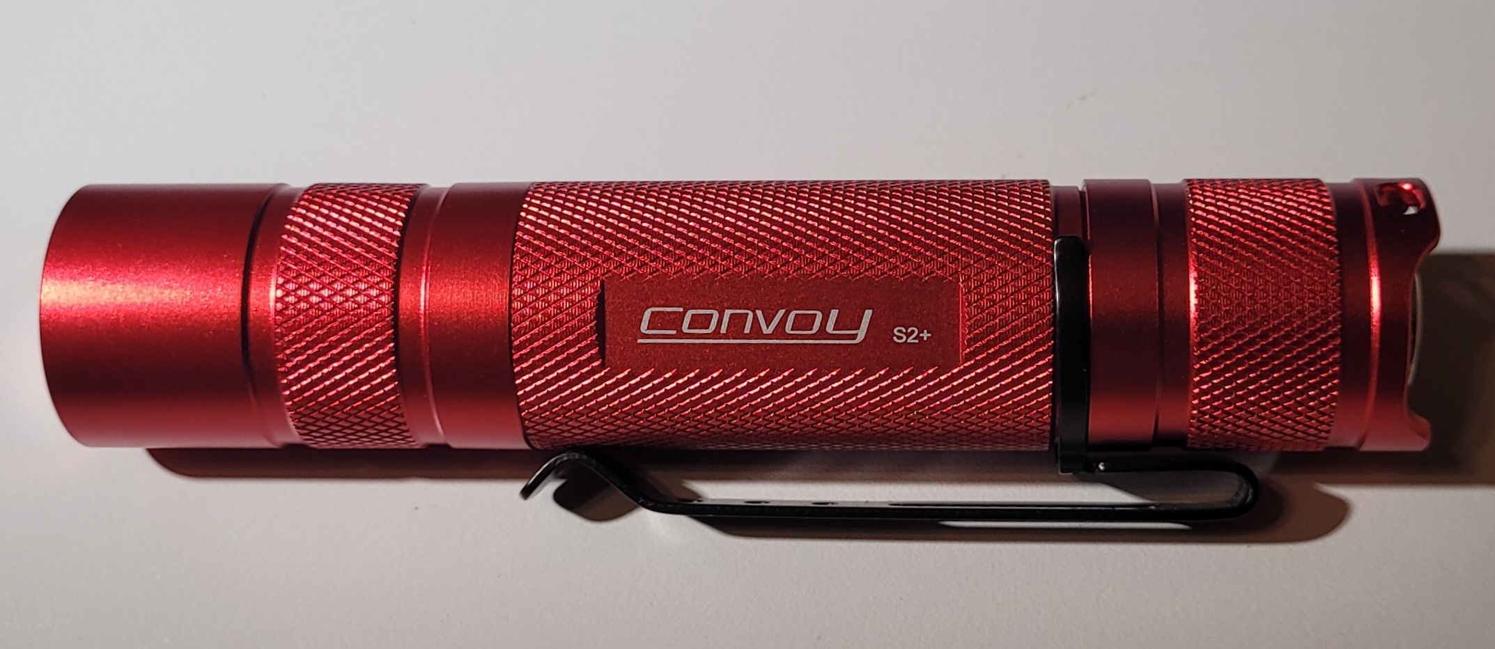

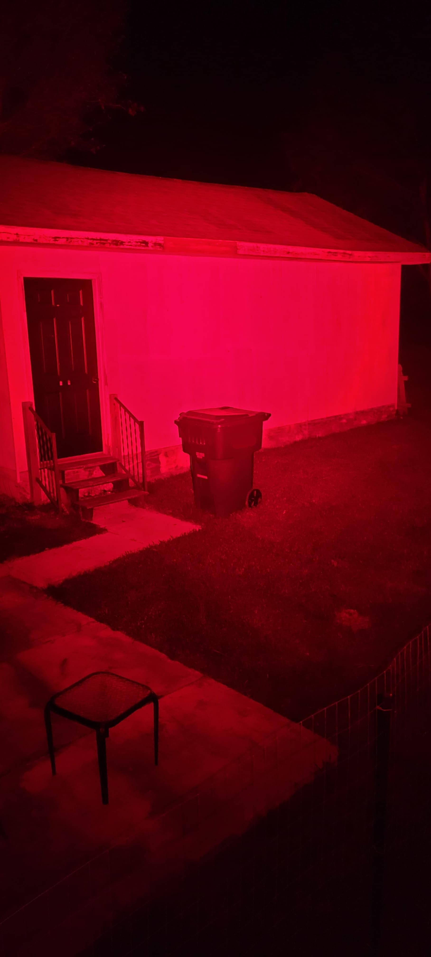

Tonight I built a S2+ SST20 DR 660nm Red Triple:
15 Thanks
Tony the Tiger sez
That looks Grrrreat!
Put 219B 3500K
This Led is gorgeous
What driver?
So I’m using the standard Convoy 5A Linear driver.
I’m not sure what affects if any, the low vF of the Red Emitters will have on it.
Led are from?
Simon
Generally it just means the driver will heat up and step down faster than the LEDs since nearly half the power will be dissipated by it with a full cell. The SST-20-DR emitters have a decently high max current so I wouldn’t be worried about overcurrent unless it was FET driven (though a buck may have stability issues running at a lower voltage than it was configured for)

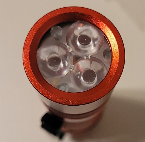

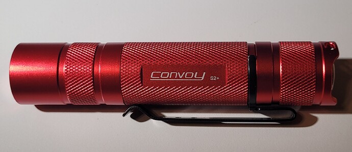

Convoy S2+ orange mule : 2 x FFL315A 5000k 95cri + 2 x FFL315A 1800k 95cri
If you like rosy tints. :smiling_face_with_three_hearts:
Also FFL351A 1800k triple with clip painted white on pink kaidomain host
The beam is smooth and works well with the carclo 10508… havent tried others yet.
Album with more pictures and details

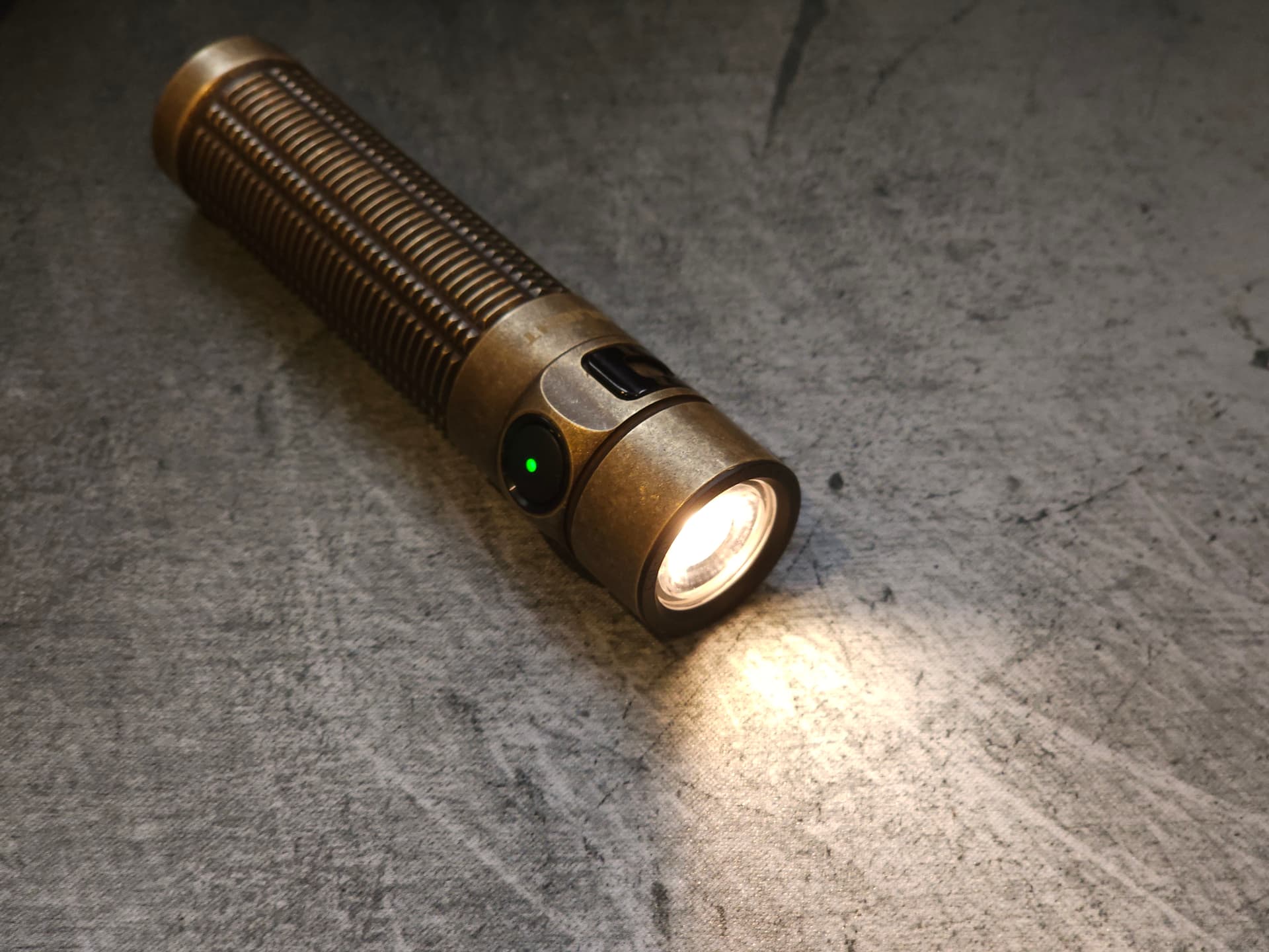

The Olight Baton 3 Pro Max in Brass is a gorgeous Torch. I decided to give it an emmiter to match it with gorgeous light.
Olight Baton 3 Pro Max with Luminus SFT-70 3000K 95CRI.
9 Thanks
Hey, what size LED’s did you use for the aux?
0805 or 0603 fits well. 0402 also work but it’s a pain to properly solder them.

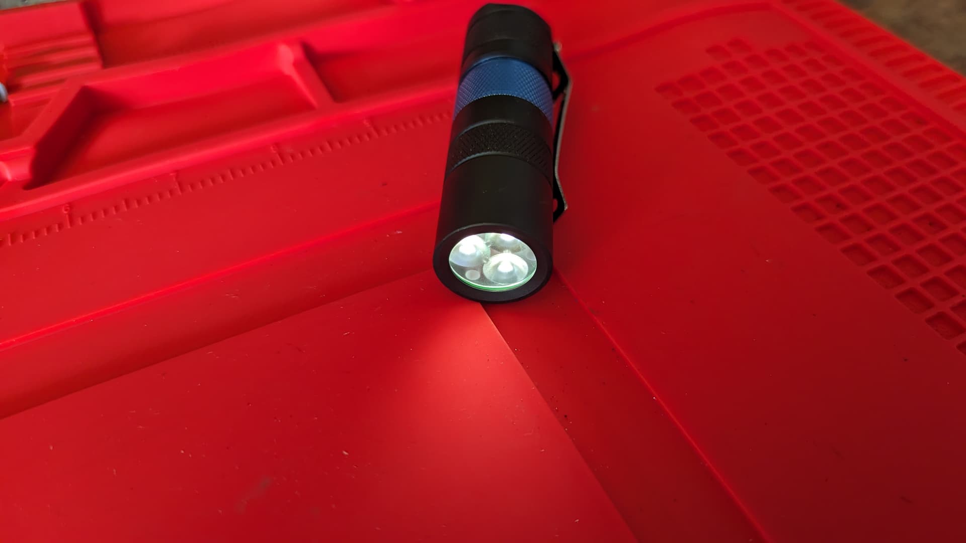

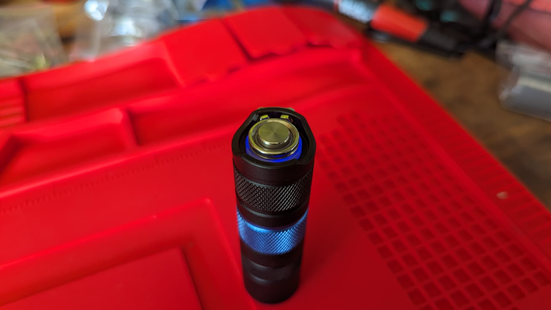

Completed my first build!!! Yaaaay! Go me! :smiley::tada::partying_face:

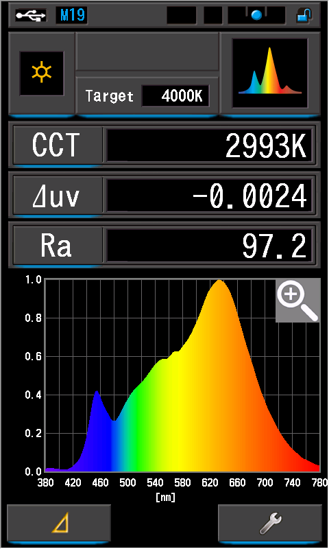

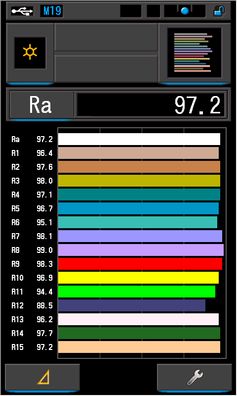

Went the semi-easy route. Dragon driver and mcpcb from CWF. 219c 4000k. My soldering looks like dookie. (Bad enough that I really don’t want to show it.) But… It works like it should. Means I didn’t jack anything up, right? Can’t run it on 100% too long. It heats up fast. Might end up changing the mode group to something that tops out at 70% or something.
I did give it a run on my Opple. It clocked in at 4216k and CRI: 91.61. I can live with that!
10 Thanks
Congrats on your first build! Nice job. We hope to see more.
