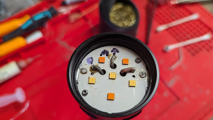

Anybody tried modding an Olight Prowess? I’m putting ffl351a, 5000k and 1800k in it.
I can’t seem to get the other 3 emitters to light up. Plus, the bottom ring doesn’t work anymore. Not sure what the problem is. I’ve checked, double then triple checked everything. It’s all good. (The writing on the mcpcb was my doing so I could keep the right orientation)
Thoughts?
If you swap the black wires do the same Leds light up?
Scratch that, all 6 should light up together on that mcpcb.
Are you sure the polarity is correct on the 3 that don’t light up?
I now think the other black wire is for the bottom ring.
Note: I see exposed wire on the center Black wire so make sure you don’t short it out on something.
Yup! I pulled them off and checked them. The notch is on the negative side. Just like the 3 that are good.
Good catch! I didn’t see that. I’m sure I’ll have to pull them off again. I’ll wrap that one in something. Pretty sure I have hear shrink that small.
Could they have a Vf that’s different enough that only some light up? Assuming they’re all in parallel
According to FFL, they’re all the same. And if you look, a mix of the two lights up. 1@5000k, 2@1800k
