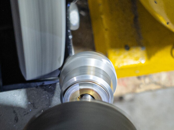

I always wanted a small incandescent flashlight that doesn’t suck, so when i saw that kaidomain was selling incandescent drop-in replacements for P60 hosts I decided to get some and fit them inside a S2. The stock reflector is too large for the S2, so i reduced the diameter using a drill and a grind wheel.
The result wasn’t that great, the reflector ended up getting a little dirty and scratched, but good enough for this old host. I will make a clean one using a new host.

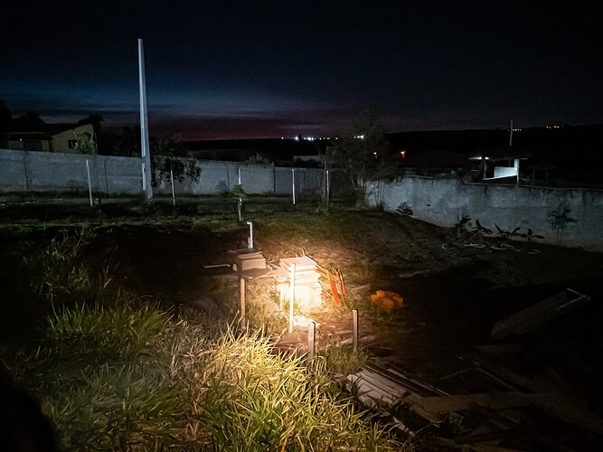

Light output is very usable, around 120 lumens, beam shape is very smooth without major artifacts, and surprisingly throwy, even after removing a substantial amount of material from the reflector, and light quality is what you would expect from a incandescent bulb, 100 CRI, 0.0000 duv, at around 3000K at full power. My LM3 was giving me unreliable data so I don’t have any measurements for low and medium modes.
Reference shot
Low
Medium
High
