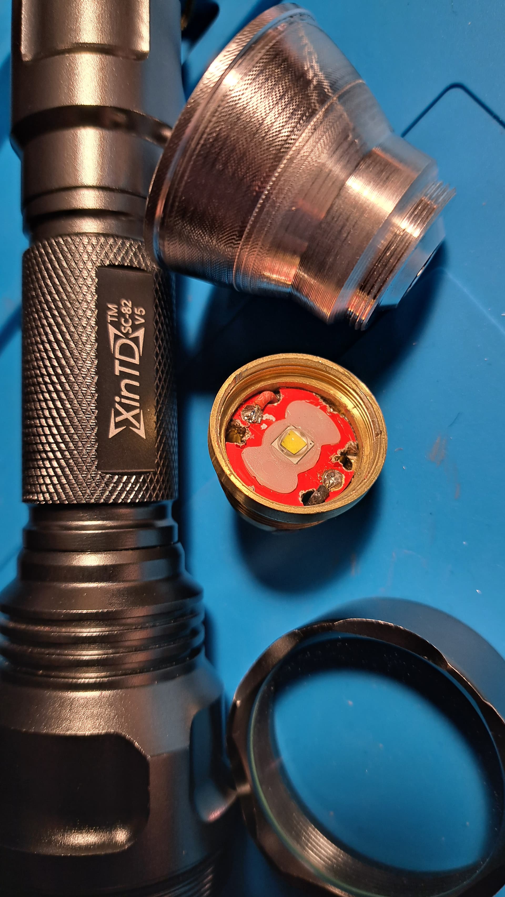

I love this light and have made strong to ridiculously forceful efforts to get the MCPCB out and it will not budge. One can see the damage from probes, flat screwdrivers, needle nose pliers…

If you want the MCPCB off, I’d suggest a lot of heat. It could be old, dry thermal compound. Remove the driver and then heat it all up with a heat gun (like a big one for paint stripping) or a torch. If that doesn’t loosen the MCPCB, I bet you could get it hot enough for an emitter swap while still attached to the pill. Just apply the heat underneath.

If you get the pill hot enough to reflow the emitter, then you can just remove the emitter to save it from being burned up, and just keep cranking up heat until the pill is red hot. The PCB will eventually come off. :joy:
Aside from the other suggestions, try pouring a generous amount of isopropanol over the MCPCB, particularly at the bottom to let it seep through and corrode the thermal adhesive. Earlier today I was able to remove such a thermal-glued MCPCB with little effort from pliers after the IPA soak.
But is it possible–I’m pretty sure I’ve heard somewhere but don’t remember where–that XinTD C8’s have MCPCBs that are soldered to the pill instead of thermally glued. In that case applying heat is the only solution.
