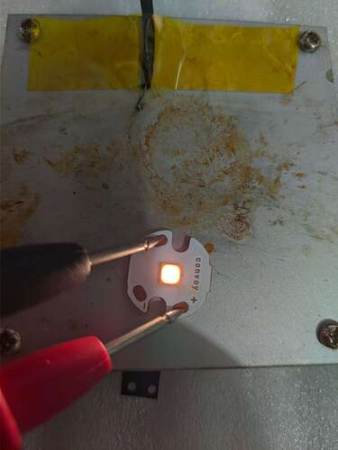

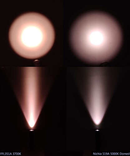

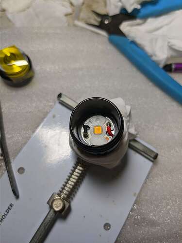

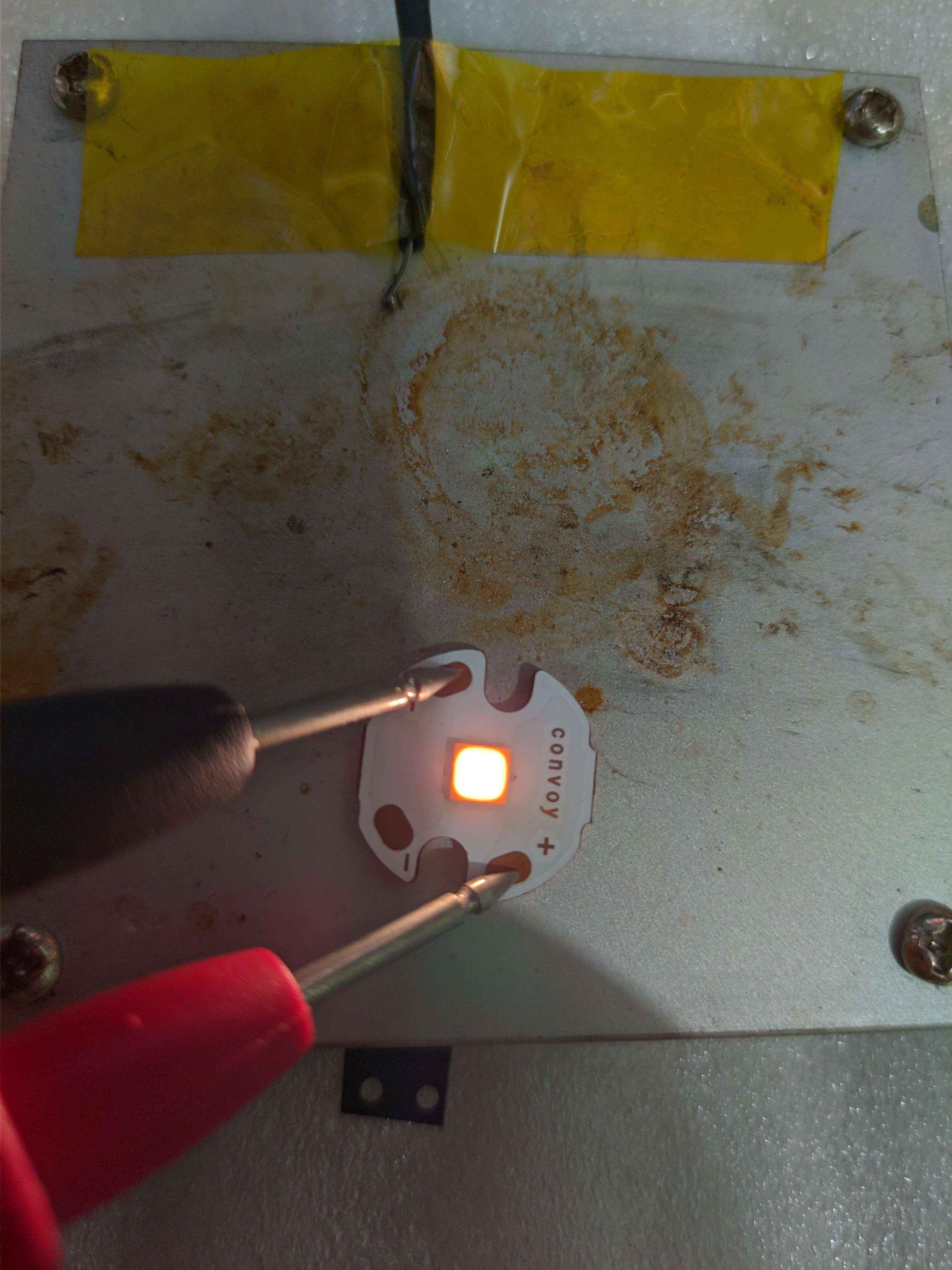

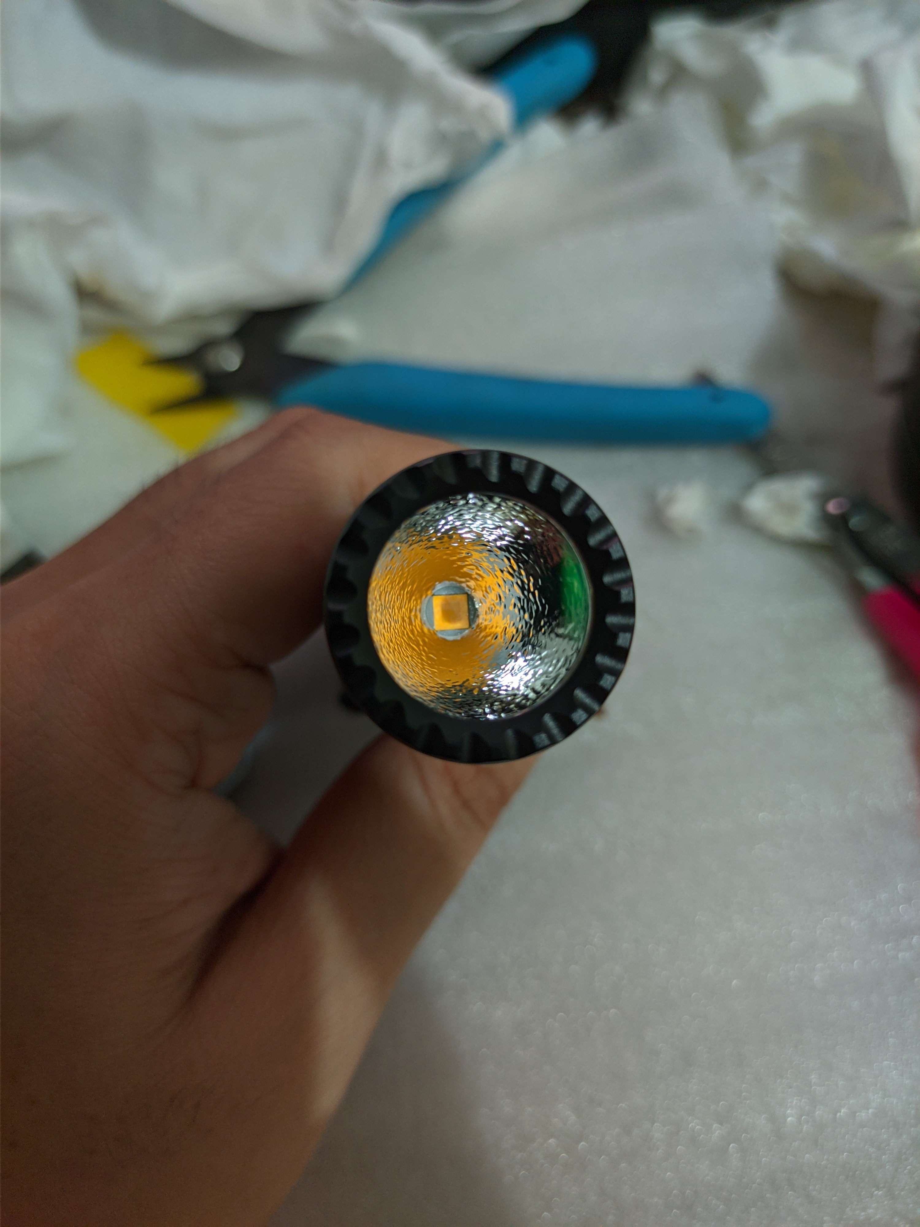

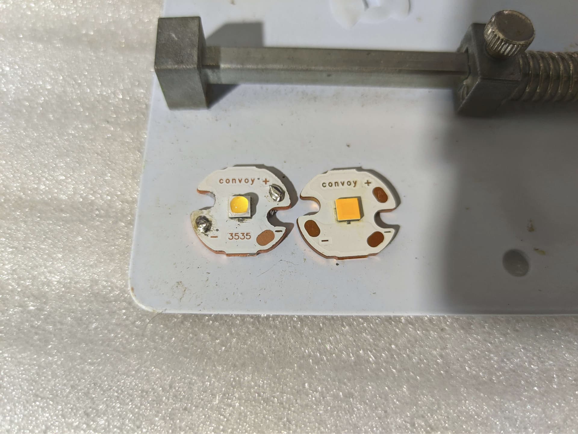

Changed the 519A 5000K to FFL351A 3700k. I love it, from my observation the hotspot is bit bigger and the spill is denser and cleaner, it does look very neutral and warmer but not as warm as my XHP70.3 4000K HI R9050 (maybe I misremembering, really need to find a host that can do with 8A driver). Haven’t tried it outside yet but with it being domeless I’d assume it’ll throw a bit more further than the 519A.
And really in dilemma of trying out the 5000K version of the FFL351A, or just get another T6… maybe in Ti…
Haven’t really done much reflow soldering, and I definitely need better soldering iron with actual temperature control.
WB 5000K, the 519A is less rosy IRL. Pics of the beans have both taken in 10% mode (~500mA). OP reflector.
8 Thanks
Looks great. I’m surprised to see a domed 519a has a smaller hotspot, I suppose I didnt realise the domeless ffl351a was so big
