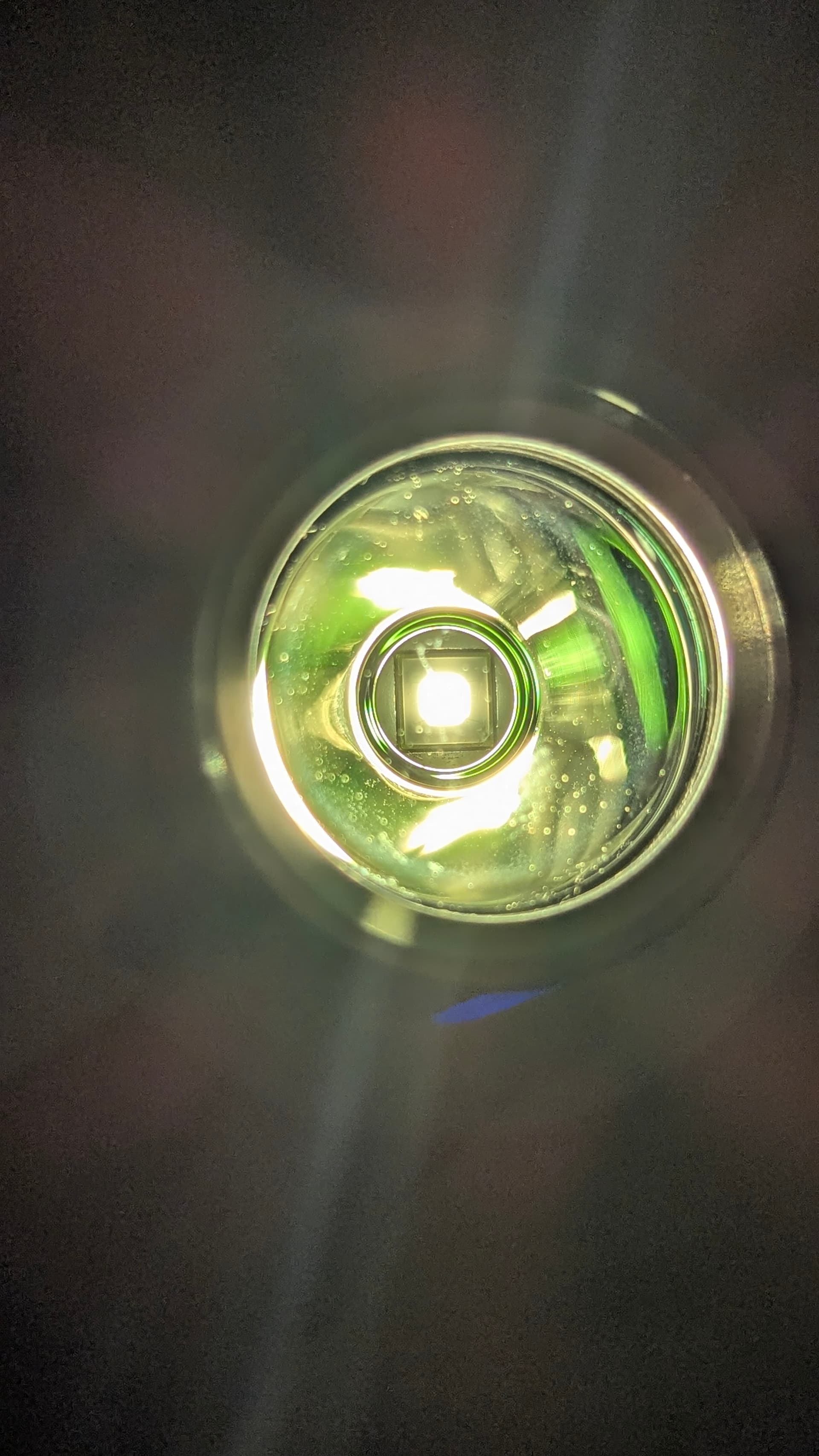

Today I modded a Wurkkos TS10SG to get a special cyan reference light (which would be mainly used for some research).
I used the Cree XE-G in PC Cyan variant. (order code XEGAPC-H0-0000-000-000000U2001)
The LED is interesting in any case. If there is interest, I may write a test on this. The chip lights up at less than 2.1 V (!) and from about 1 A the tint shifts strongly into the greenish range (peak well above 500 nm) because a second peak forms at about 500-510 nm in addition to the first peak at about 490 nm, which I never saw before.
I don’t yet know why this is the case. But perhaps this spectral instability of the phosphor used (NKLSO?) is one of the reasons why there are virtually no ultra-high-power LEDs with filled cyan gap.
Reflowing of the XE-G is not trivial. The LED is extremely small (footprint of TS10SG is standard 3535) and the board has to be modified to fit the unusual footprint of the XE-G.
The light is somewhat throwy (despite the lens being diffused) and of course it is just cyan :smiley:

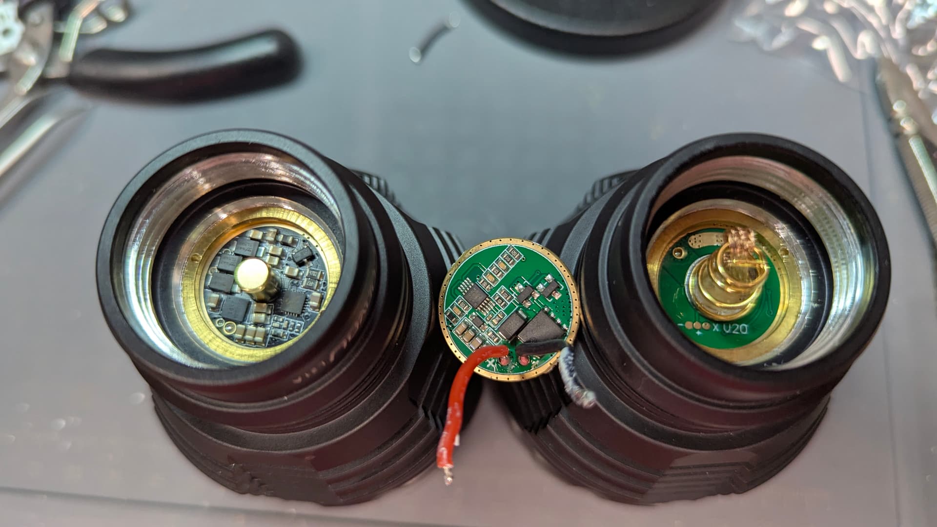

Today I modded the Lux-RC driver and polished the Okluma DC1 light, also added an Oveready Speed Clip.

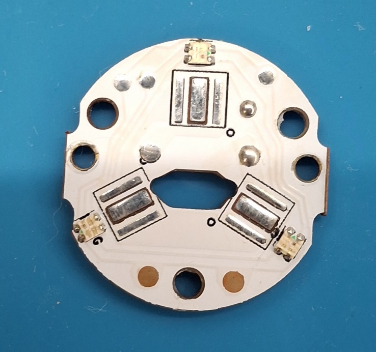

That my fear turned out to be unreasonable.

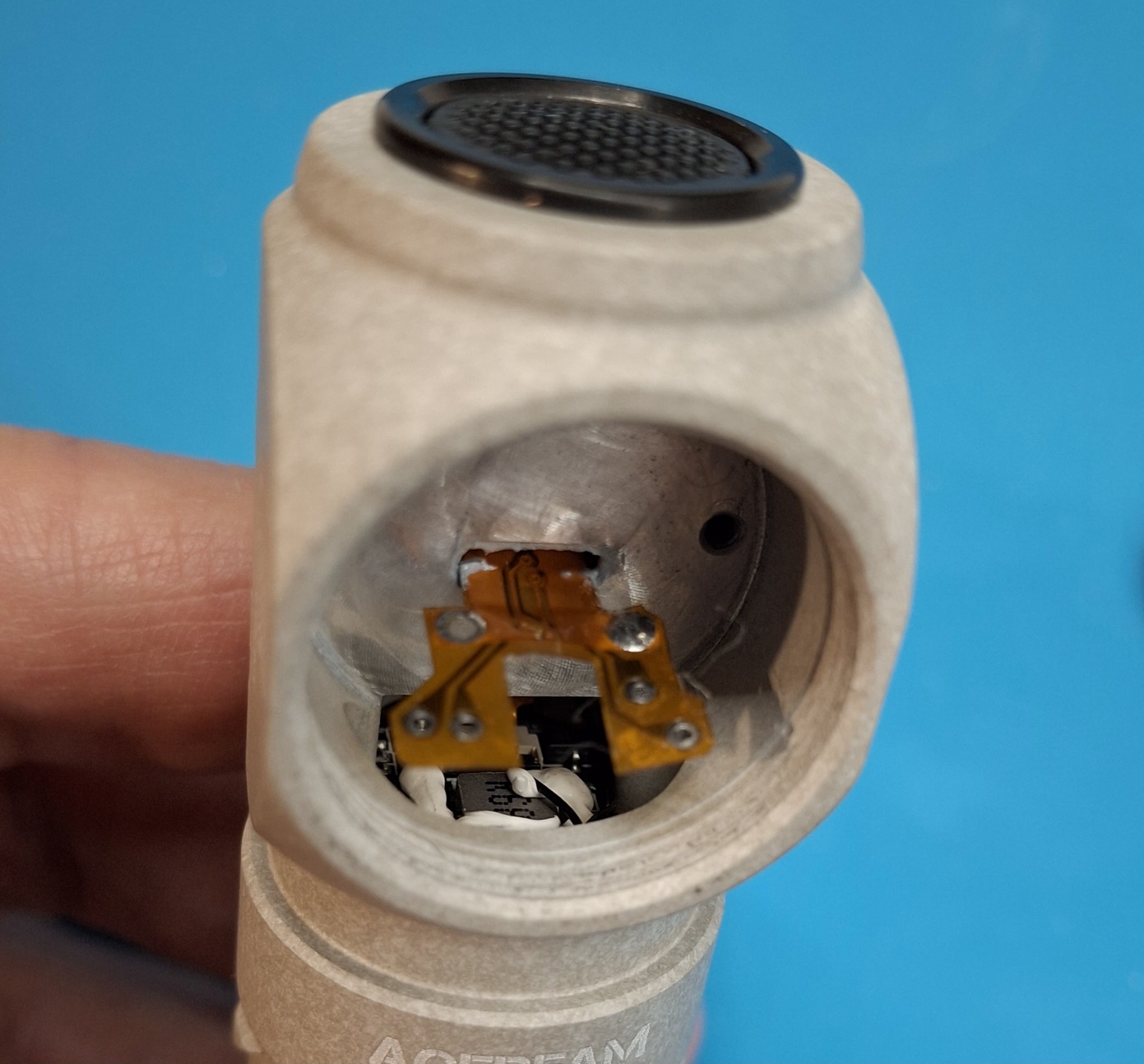

I had a stupid assumption that solder blobs might be under the film or that the film is glued to the mcpcb.
But nope, solder blobs are exposed, so after using a wick everything came off nicely.
Now my Acebeam H17 2.0 has 519As, 2x3500K and 1x3000K.
BTW, the driver is a 9V one.

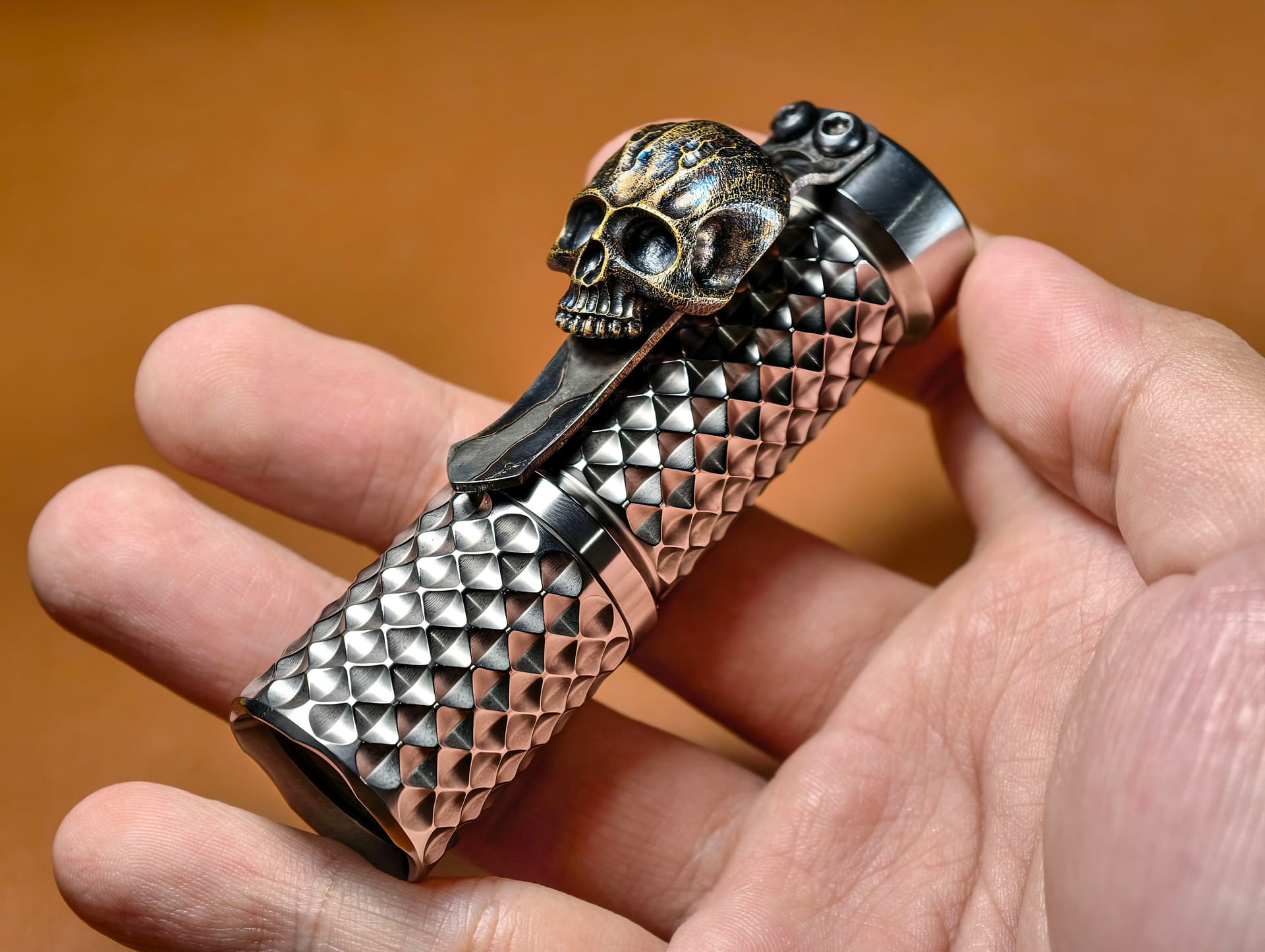

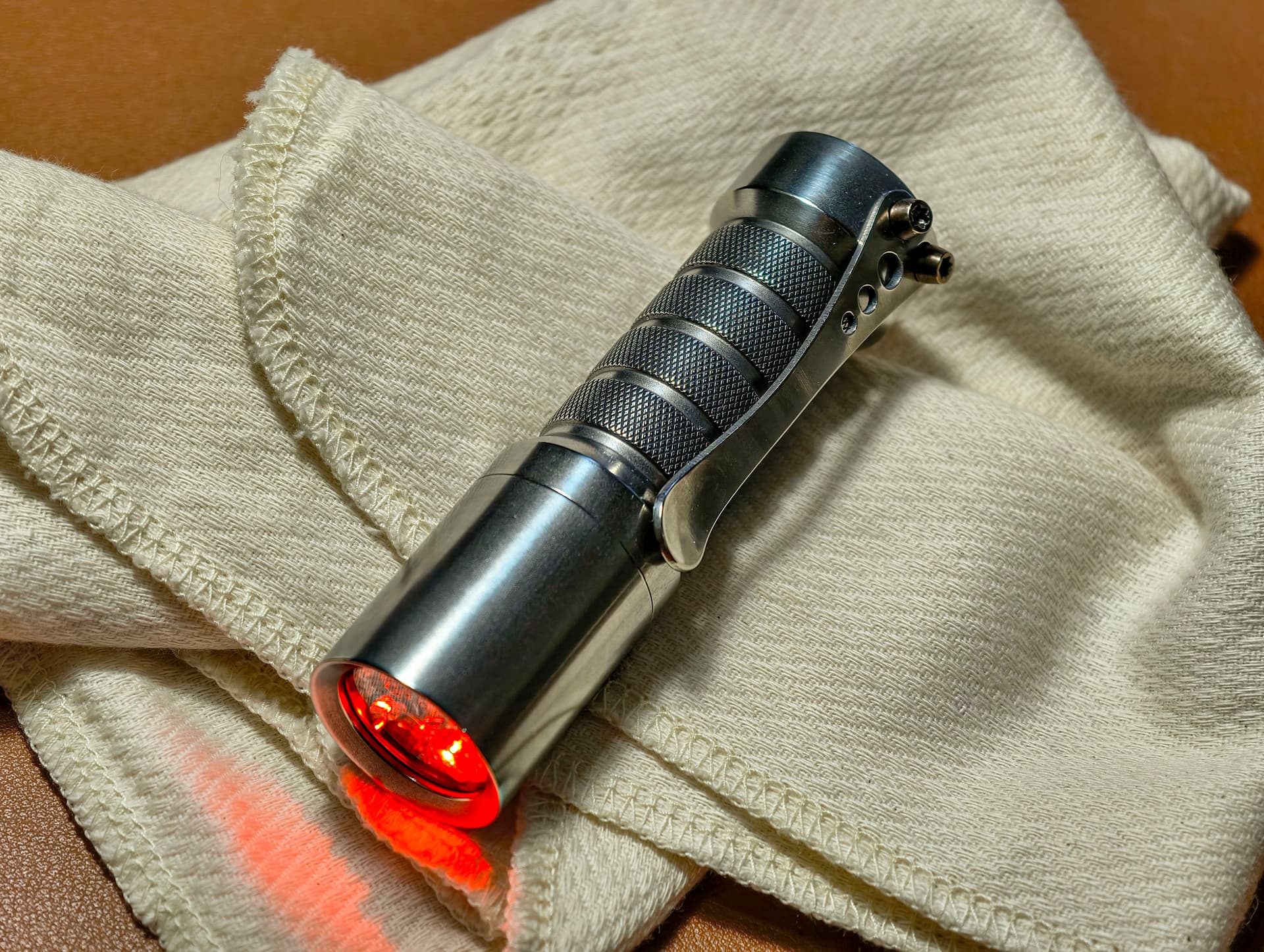

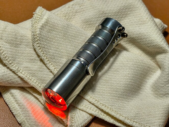

Polish my Hanko Trident Tesseract flashlight, leaving a bit of stonewash in the grooves without going too deep, to make the contrast pop a little more.
6 Thanks

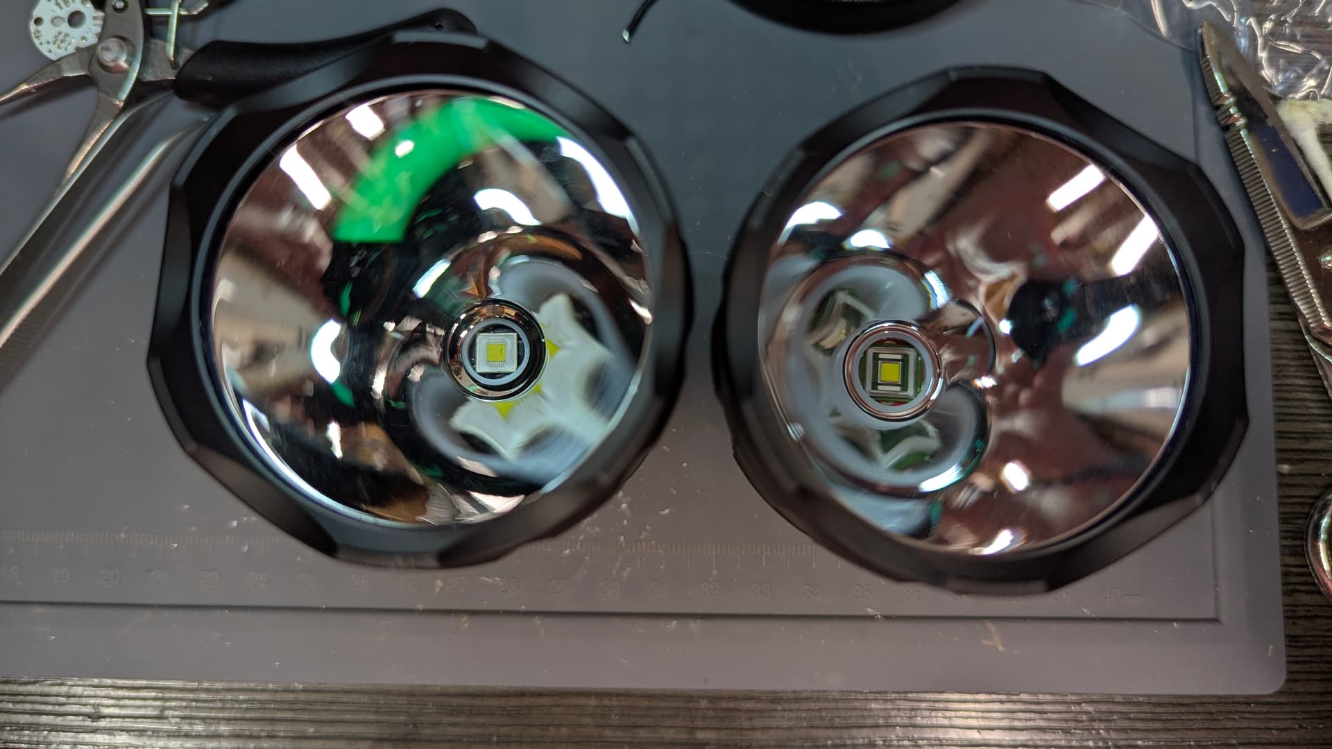

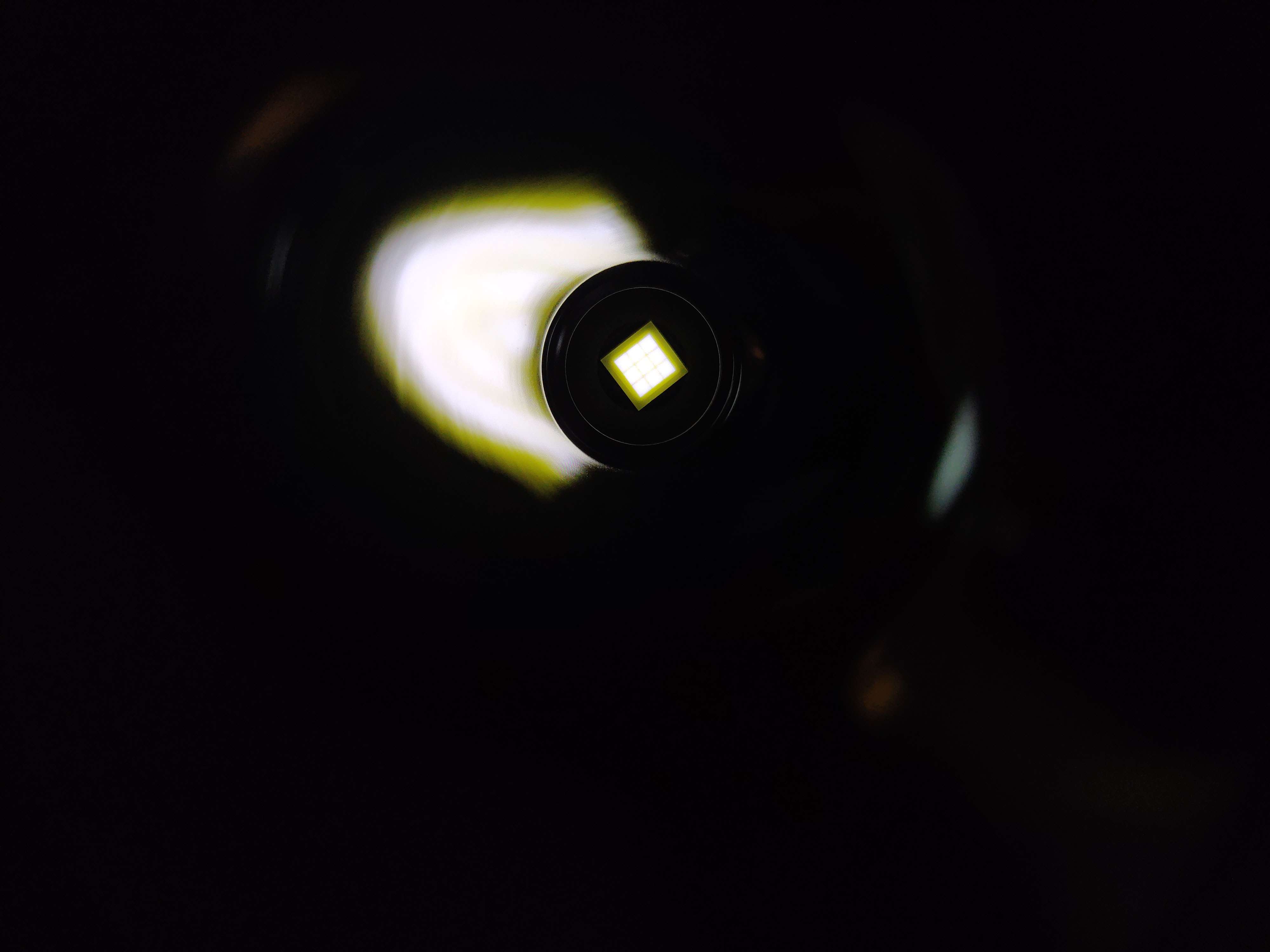

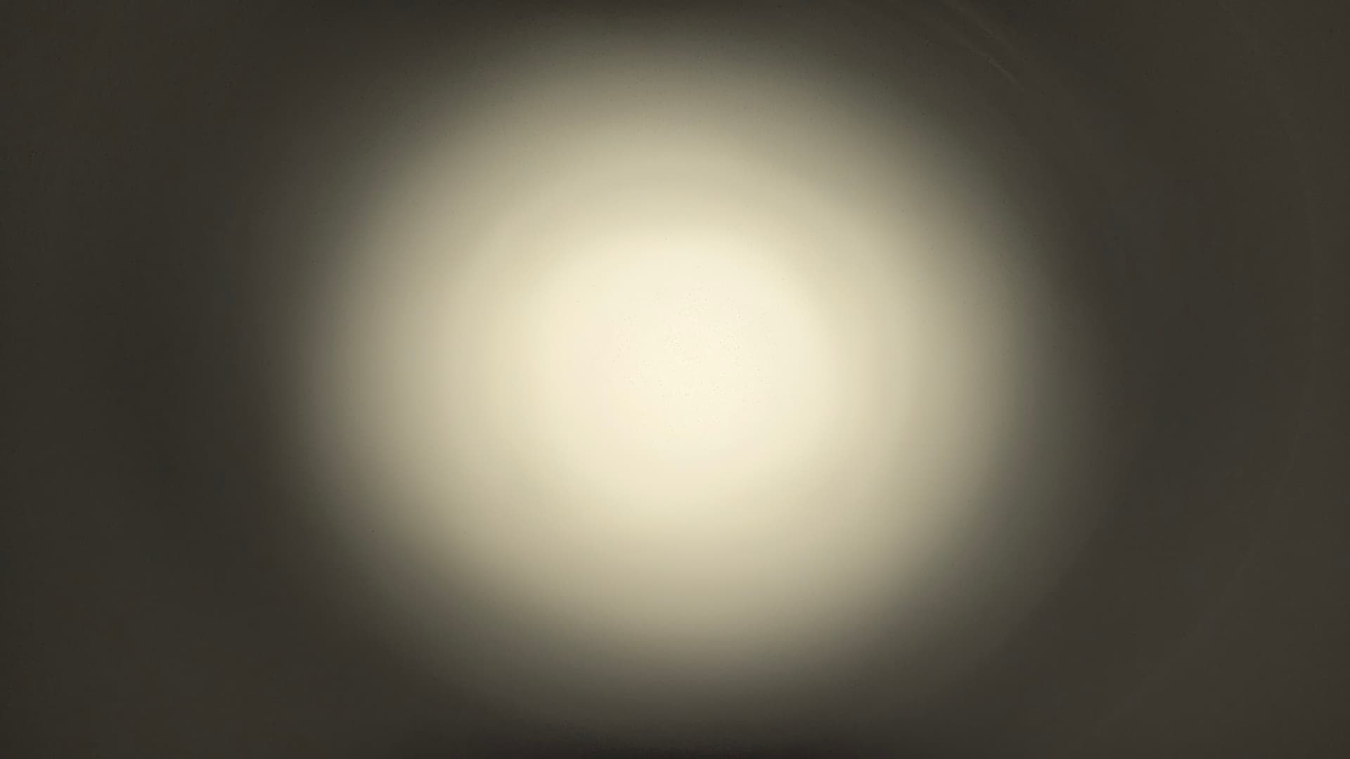

T9R Lume1 6A buck + FET with Nightwatch N5-165HPE!
The reflow was a bit difficult for some reason, the emitter was shorted to base of the MCPCB after the first try when checking it with a multimeter, had to position it off center to make it work. The original SFT-40 on the board does look off as well.
But holy heck its fun, and def look much brighter than my M21C SFT-90 + “12A” FET, but its only fair to test it when the 20A buck driver arrive for it.

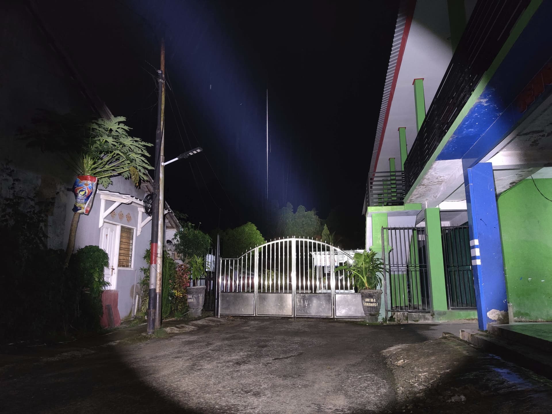

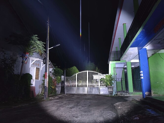

Have some conical duo
Edit: Some beans. The N5-165HPE is warmer looking. Pic with WB 5000K locked

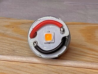

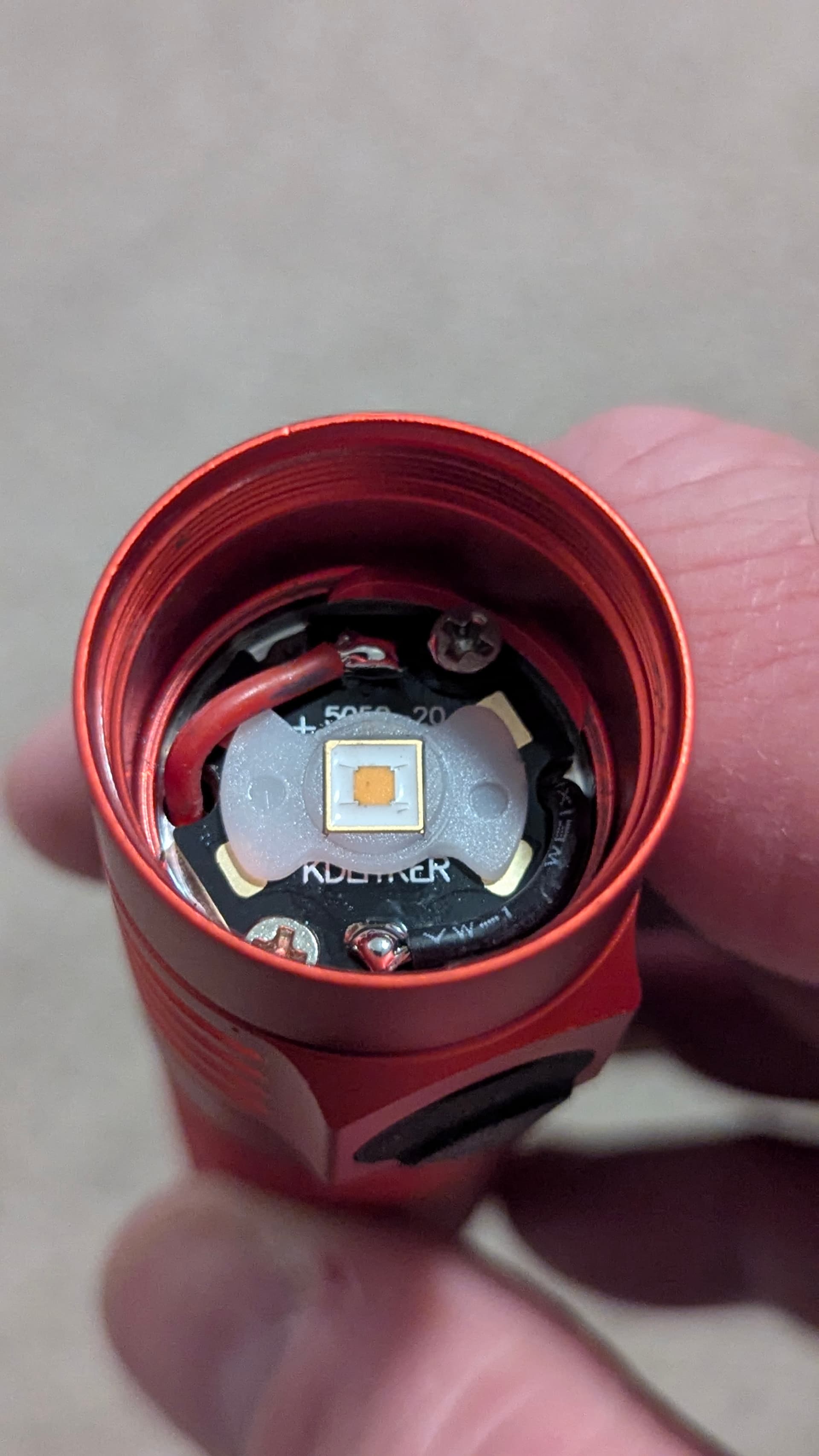

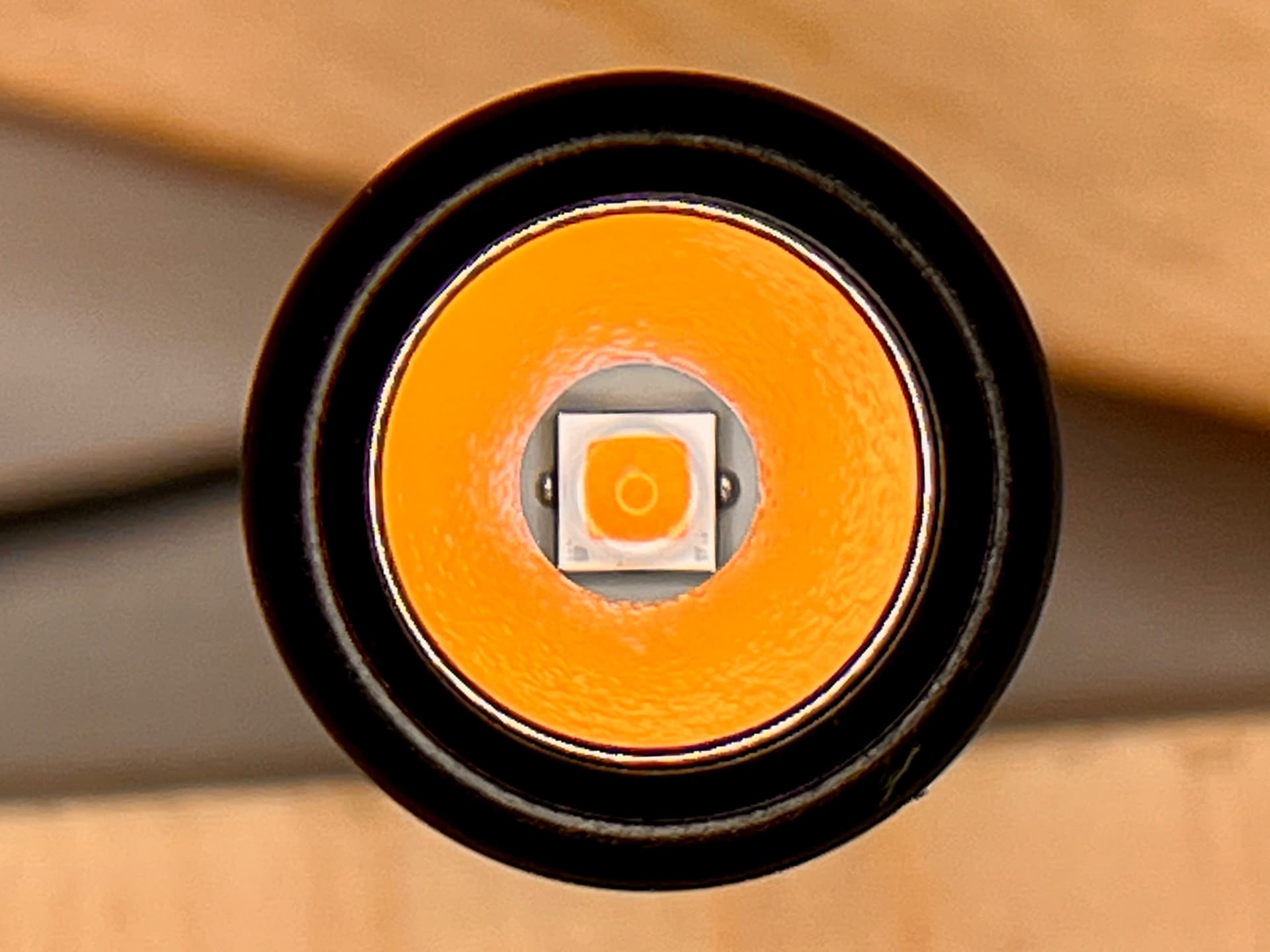

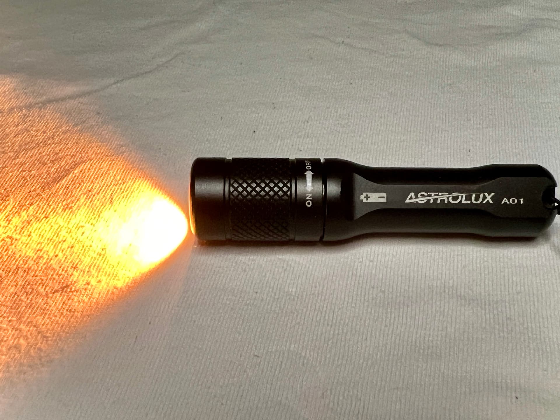

I swapped out the 4000K 219B with an 1800K 219F in my AAA Astrolux A01. It has always been a nightstand light when needed in the middle of the night so I wanted to make it warmer, much warmer.
The only issue I had, besides getting the pill out, was with the reflector gasket. It was a little too wide to fit between the solder joints so I had to sand it down to make it smaller. Strange it came that way from the factory and that I didn’t notice it before when I did the pencil trick years ago to fix the next mode issue.
It compares very nicely against my 1800K E17As, meaning I like it. :grin:

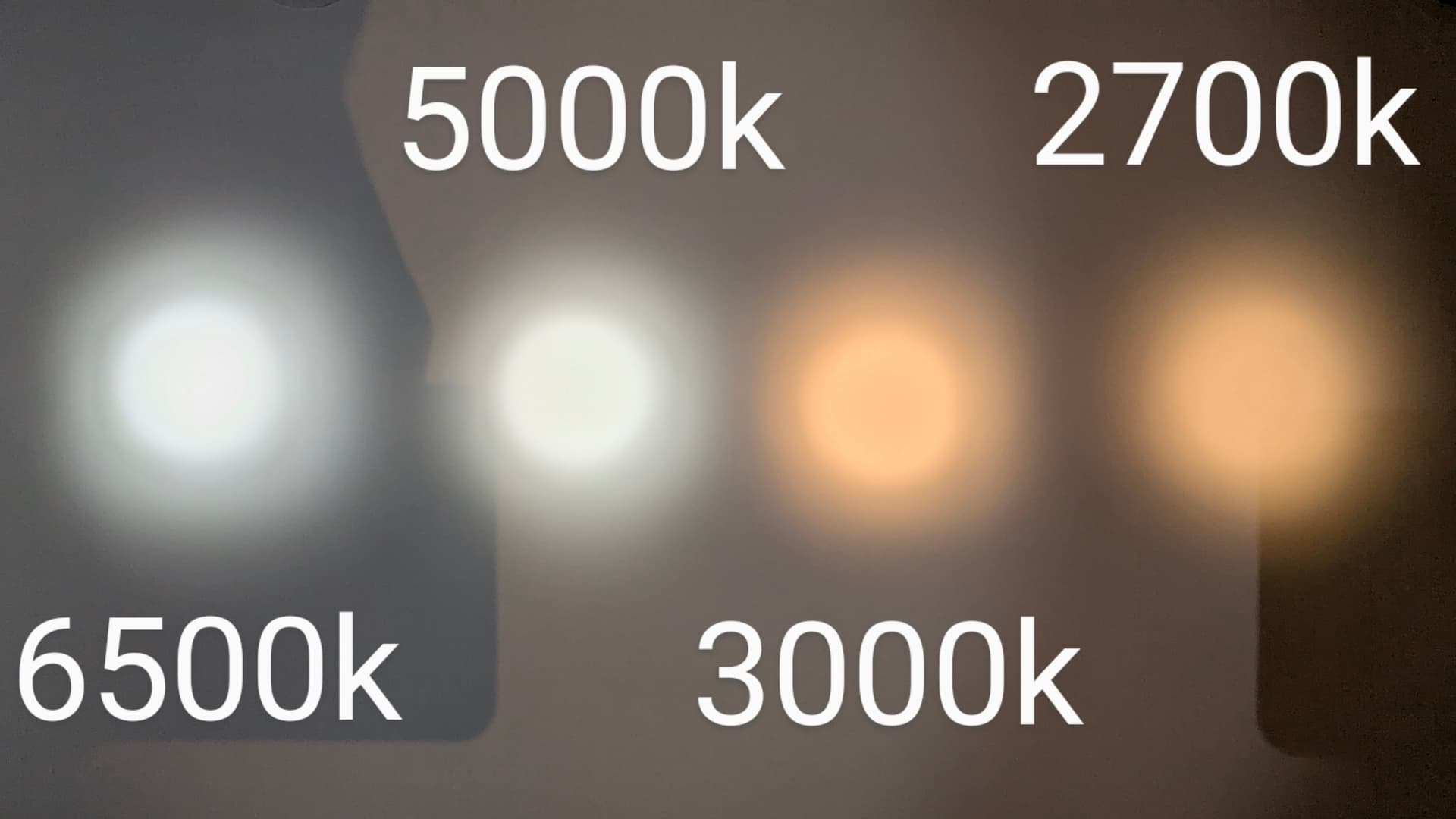

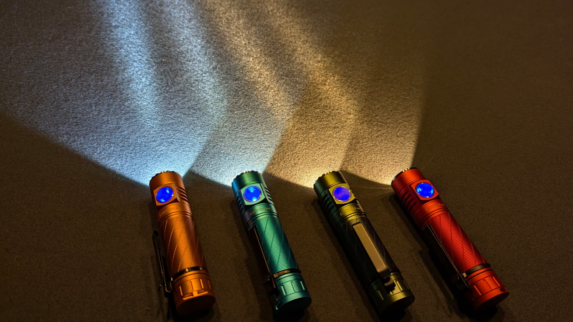

Built an S21E with SFT-40 2700k. Emitter and mcpcb from Kaidomain. The driver is the stock S21E SFT-40 Anduril 1 driver.
It goes in line with my other S21E SFT-40’s. 6500k, 5000k, 3000k and now 2700k

Upgraded one of my two L21A’s today with the new 20a buck driver. The other will be upgraded soon.
