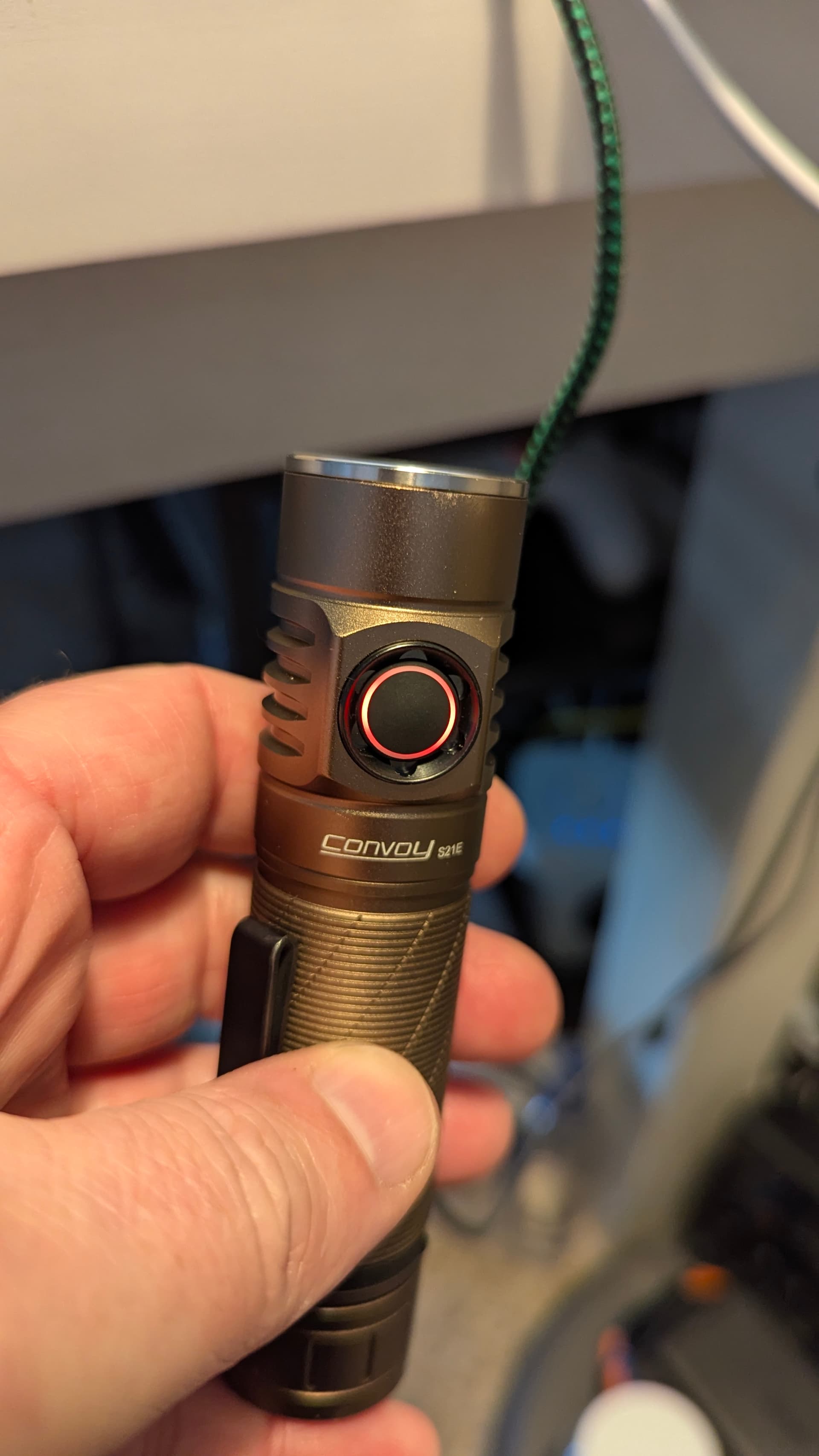

The easy one:
Tried a Hank button and bezel on an S21E and it drops right in perfectly. No mods or spacers or anything needed. And it has a great feeling click to it.

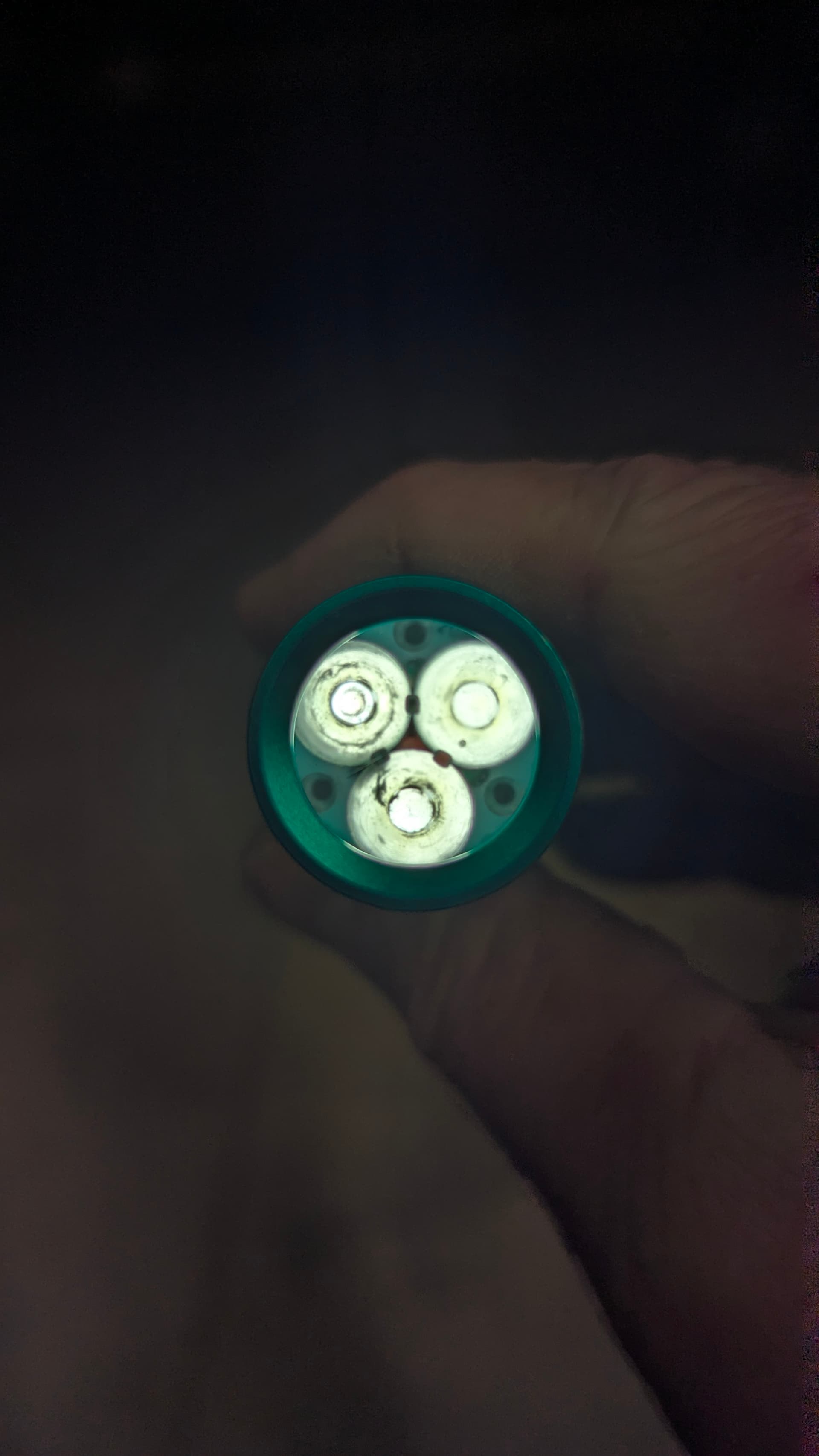

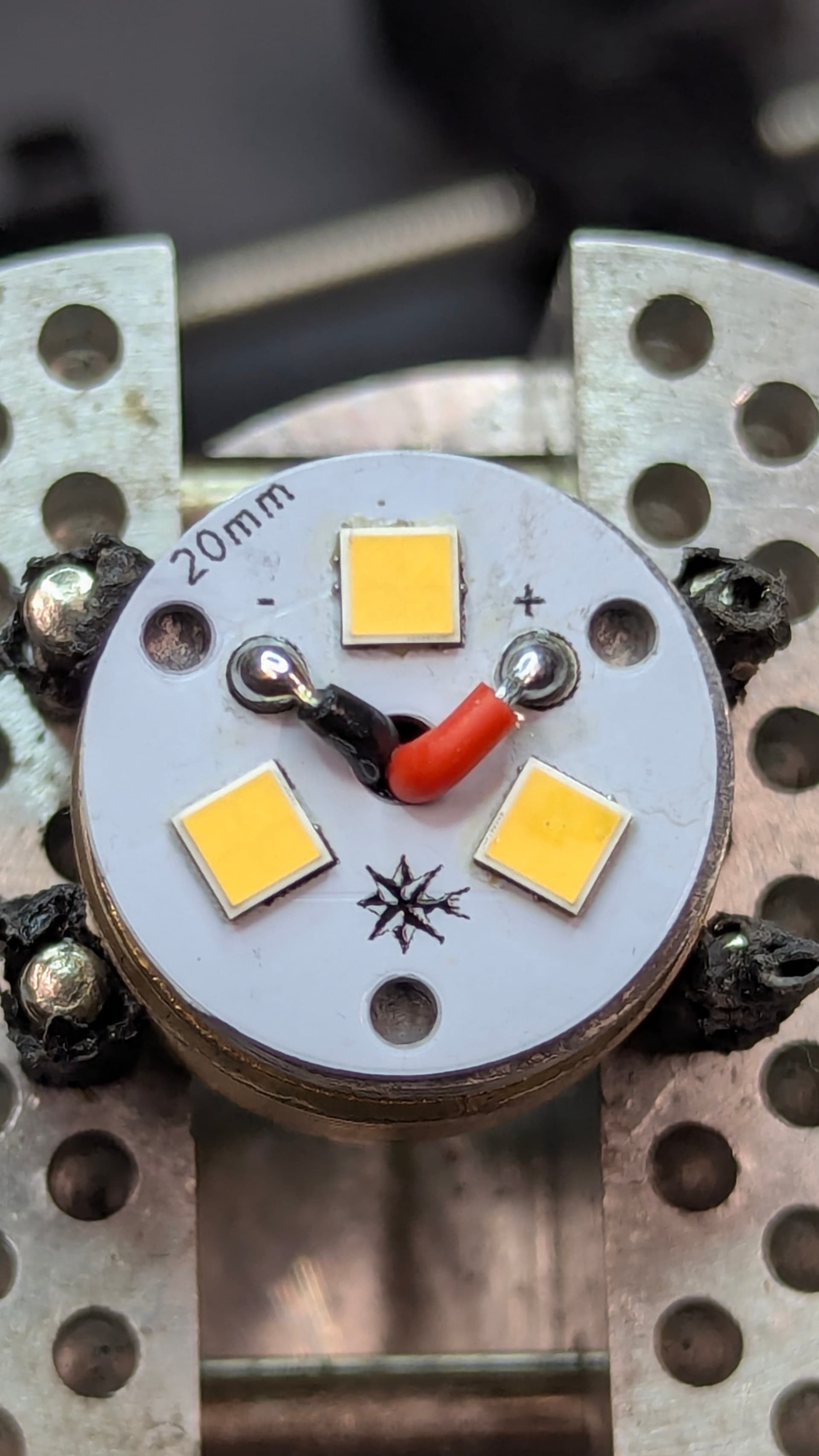

Now the more difficult one. After seeing a post on Reddit a few weeks ago where someone made a triple B35AM and had to hobble together something with a Lumencraft mcpcb. It worked. But it didn’t look great. So, I designed an mcpcb with triple B35AM’s.
I understand that the B35AM has a larger LES than the Carclo optics. The floody ones seem to work great! (Ignore the dirty optics. I cleaned it up after seeing this pic. LOL!)
12 Thanks
That’s awesome. What driver? Got any mcbcp available?
I used a Convoy 6V5A driver. And it works great!
I have plenty available. I’m send you a PM.
6 Thanks
If those MCPCBs are available for purchase I would definitely be interested in a couple. I was going to buy that lumencraft MCPCB to do the same thing, but never actually ordered it

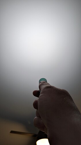

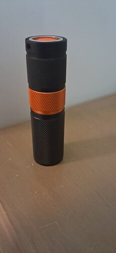

Put an sft70 3000k into my s6 shorty today. 5amp boost driver wont fit without heavy compromise. So went with a 4amp boost driver. The difference isnt noticeable. Still an effective hand warmer. :rofl:
I took some beamshots. But my camera just makes it look bad. So wont poat them. Beam is perfectly fine. No donuts or rings. Throw is excellent not quite as good as the sft40 it replaced. But not as far behind as one might think. Tint is eons ahead. Spill vastly improved. Great little edc multi purpose beam.

What’s that clean tail cap solution?
Thats just an orange silicone button and a the magnet ring from simon on the stock switch and stock s6 tail. :+1:
He has orange, green, blue, white, black.
The orange tube is just the s2+ tube.
