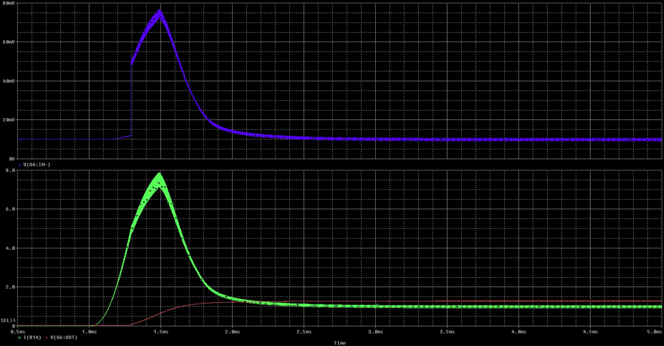

Hardware, the inverting input of the Op-Amp needs to be pulled down during start-up (or the output pulled up), Mike C tested connecting directly IN- to a pin of the MCU, but apparently when floating the pin it’s unstable so using a small NFET to pull down IN- is needed.
The change should be very simple, the drivers have spare area and they have 4 layers so the routing is easy, the annoying part of course is producing a new revision.
In term of software the pin controlling the NFET needs to be pulled up for a moment when enabling the Op-Amp/boost IC, how long depends on the value of the Op-Amp compensation capacitor, the larger it is the longer the flash is.
All my MP3431 based drivers have this small NFET, but not the code needed because I don’t know how to do it.
Here’ a simulated example (at 1A because it shows better than at a moonlight level):
Green is current and it surges to more than 7A
Red is the output of the Op-Amp which takes some time to rise. Output low = high current, output high = low current.
Purple is the Inverting input of the Op-Amp.
By pulling down IN- (for 2 ms here) the output starts high, thus the current starts low and doesn’t surge.

What I mention here isn’t a user fix, it’s a manufacturer fix, hence why I mentionned it first on Hank’s thread (a couple of time actually IIRC), I don’t know how many users are bothered with this, since I don’t see complaints that often the majority apparently don’t care much about it.
