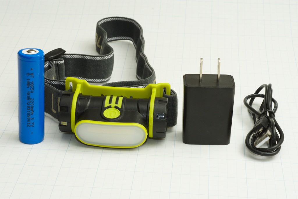

This thing I got from Amazon years ago. Like $19(?) with the battery, cable and charger! All the batteries tested above their rating. I bought 3 more after I saw how nifty the first one was.

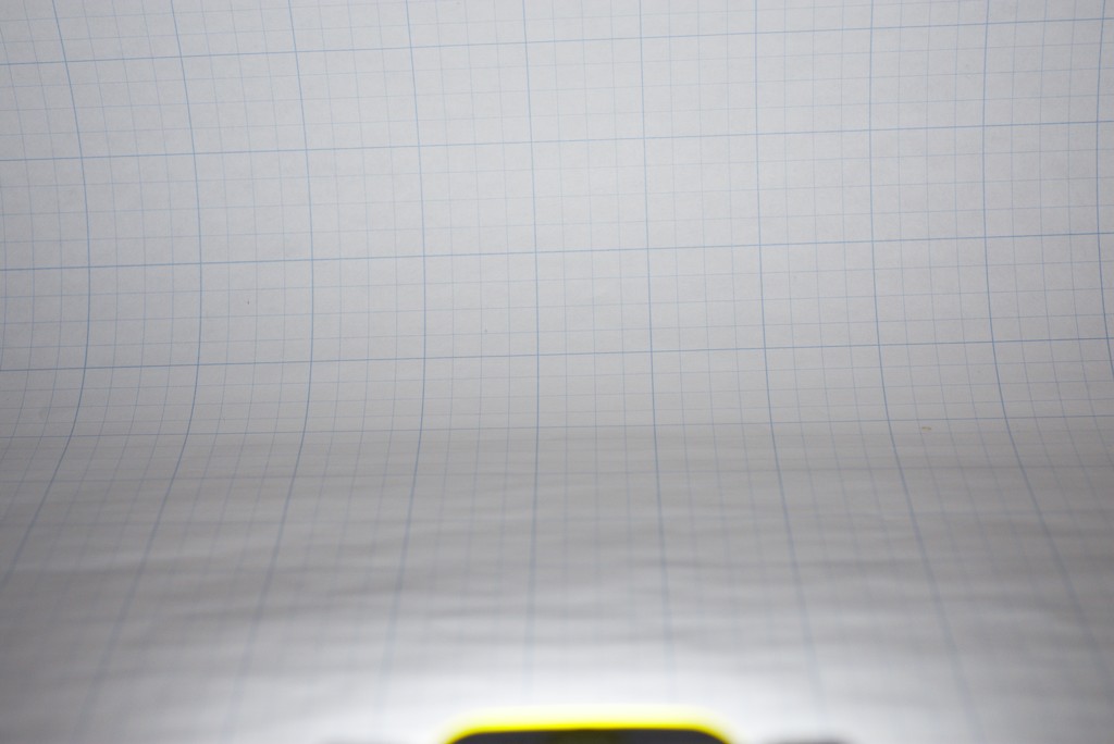

More Flood than a mule. Perfect for arms length work.
Naturally itâs no longer available.
