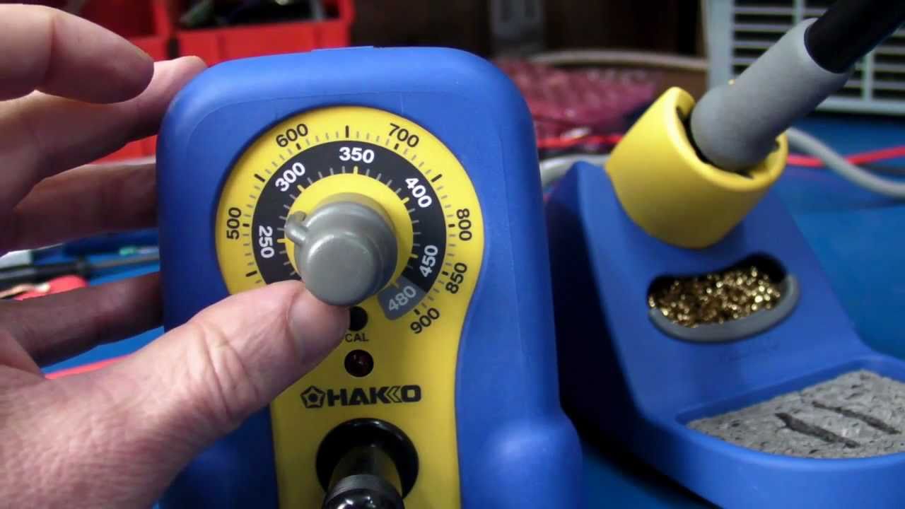

I went with a Hakko station - ’bout $75 a few years ago.
