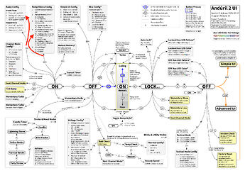

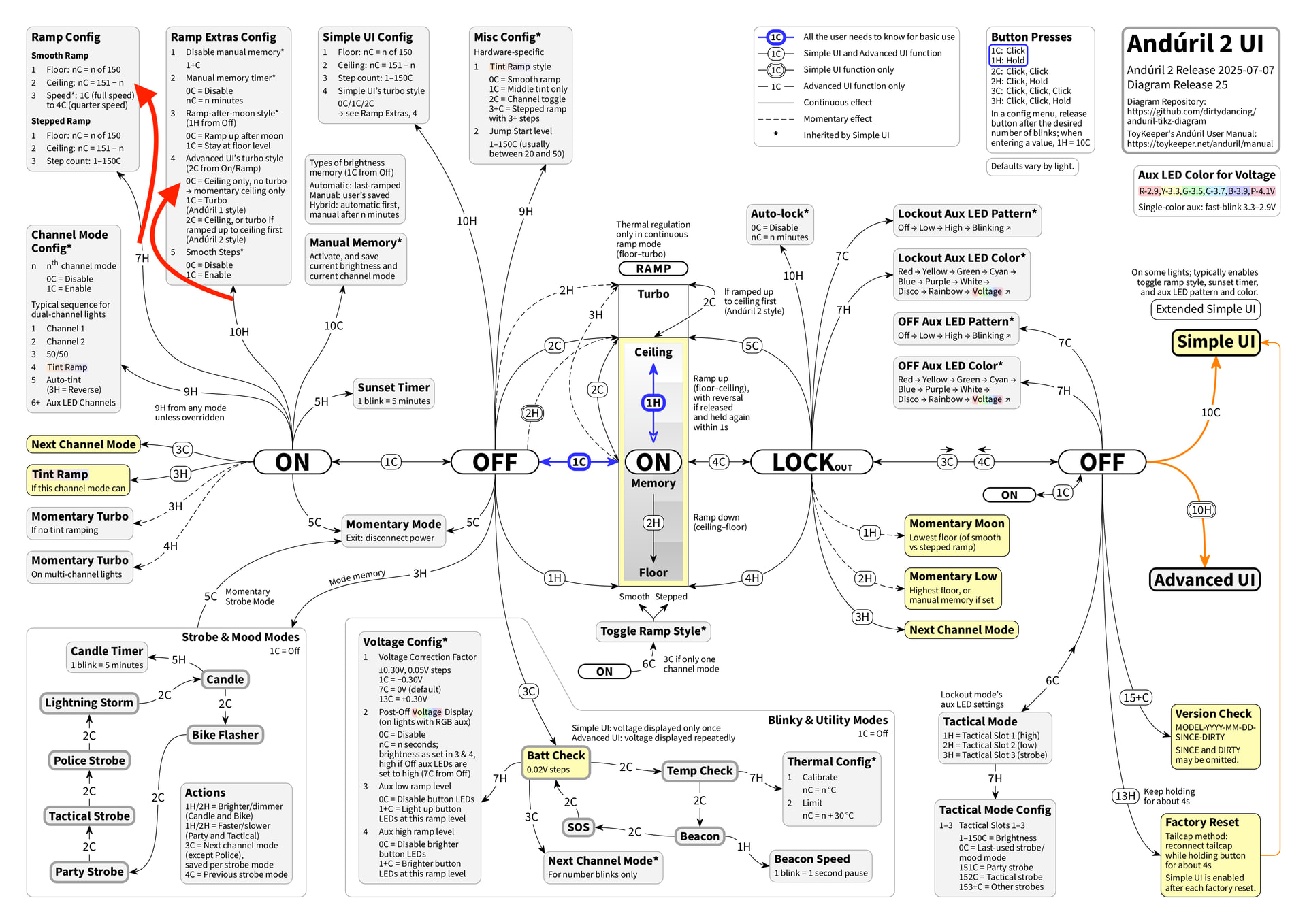

here is a flowchart marked with red arrows for those two options settings, disabling Turbo, and lowering a Ceiling:
