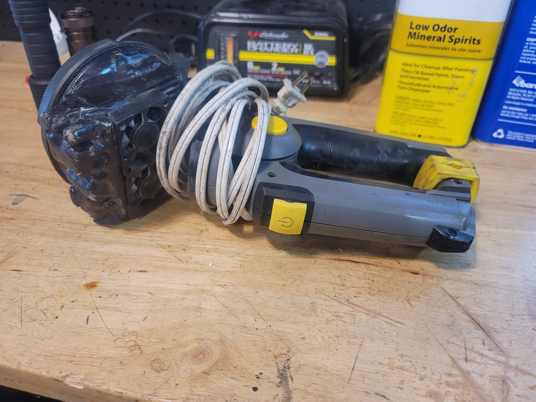

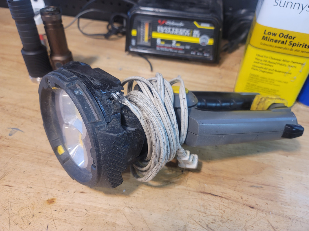

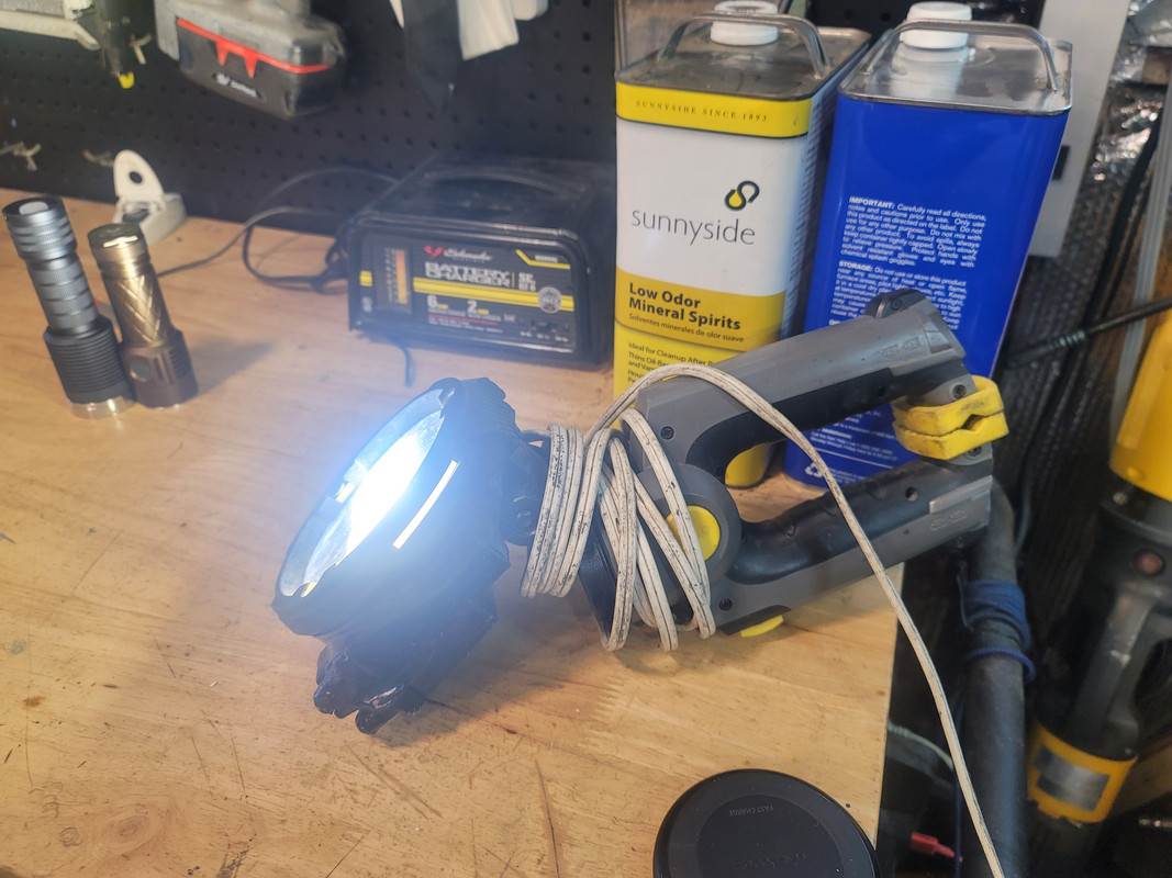

This was originally a Stanley clamplight with an xpe emitter, and ridiculously large “relector” that made no reflections of the emitter.
I cut the backside off and then epoxied or screwed together the following: a large aluminum heatsink, 2 different color temp 40w? Cobs and their included reflectors, a 120v to 12v power supply, a 12v driver and 2 ipx rated (?) computer fans. I completely potted the driver for protection from bumps and water.
I think the emitters are in parallel, I don’t remember. I think I sized the driver for 80% rated, I should have done 120, but it has lasted many years and is bright enough.
No switch, no modes,. The wall plug is it.
Really I guess the only Stanley part left is the clamp and head plastic.
Edit, forgot a photo.
Did a quick search, seems like the original.
Mostly used for painting walls, literally. I don’t think it is high CRI, but you can see where you have painted white on white well enough.
The point is, it clamps on a ladder or rafter well and the head rotates all around and changes angles.
