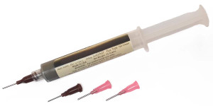

I would not buy lead free paste unless its low temperature BiSn
this paste has not even marked which compond it is so I would not buy it
sn62pb36ag2 is still the best leaded solder compond
lead free SN98 or 96 paste has a too high melting temperature

Tried them all, I liked MG Chemicals, but went back to Kester EP256 63/37. I buy from CML Supply it seems to be fresher because they sell a crap load on Amazon/FleaBay and in my experience it flows a bit better/faster/cleaner with a hot air/reflow station and last longer, IMHO, it was $17.99 free shipping 3 days to the door, usually.

I use this stuff SMD291AX50T3 Chip Quik Inc. | Soldering, Desoldering, Rework Products | DigiKey
Works really well for me.
All the resistor’s plus cap’s (size 0402) and other components are reflowed with the Chipquik and a hot air.
I use this same stuff for all my led reflows too, I haven’t found a need to try anything else, if it’s not broken why fix it.
I agree 100%. I haven’t found anything better. The added silver also helps improve conductance.

Figured there would be plenty of choices and just like when I first visited here, I have no clue what a lot of the terms used in the above posts mean and don’t need to know just need what works all around best for an amateur hobbyist and it looks like this stuff will do well.
Thanks again
