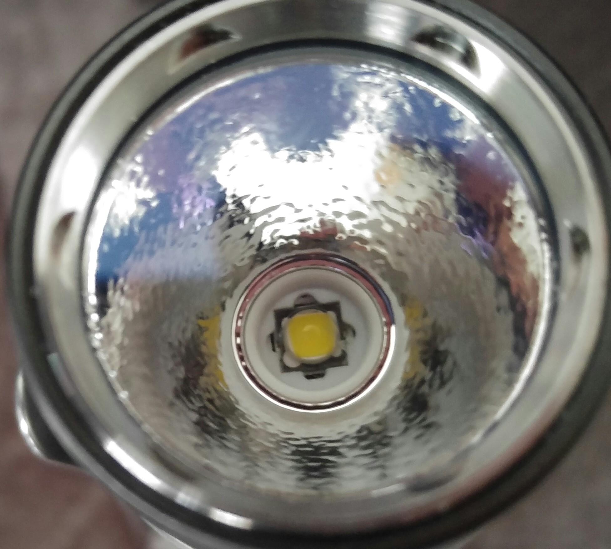

just got my 2020 yesterday, but need help to identify led, because seller wasn't sure which one it is. And there's no marking on the box. I have my guess which one it is, but just need confirmation.
The 2020 RRT01 comes either with Cree XP-L HI or Nichia 219C. This is the Nichia 219C.
@pol77 thank you
Ps. parasitic drain measure 75mA on 3.56V charge 18350 (with ring set on off)
85mA on 4.1 charge 18350V.
congrats on your new Rotary, great photos
agree,
note it is 70 CRI 4000K 219C, not 90+ CRI
also note the negative R9 and the positive DUV… all bad things, easily remedied by replacing the LED with a 219B :wink:
