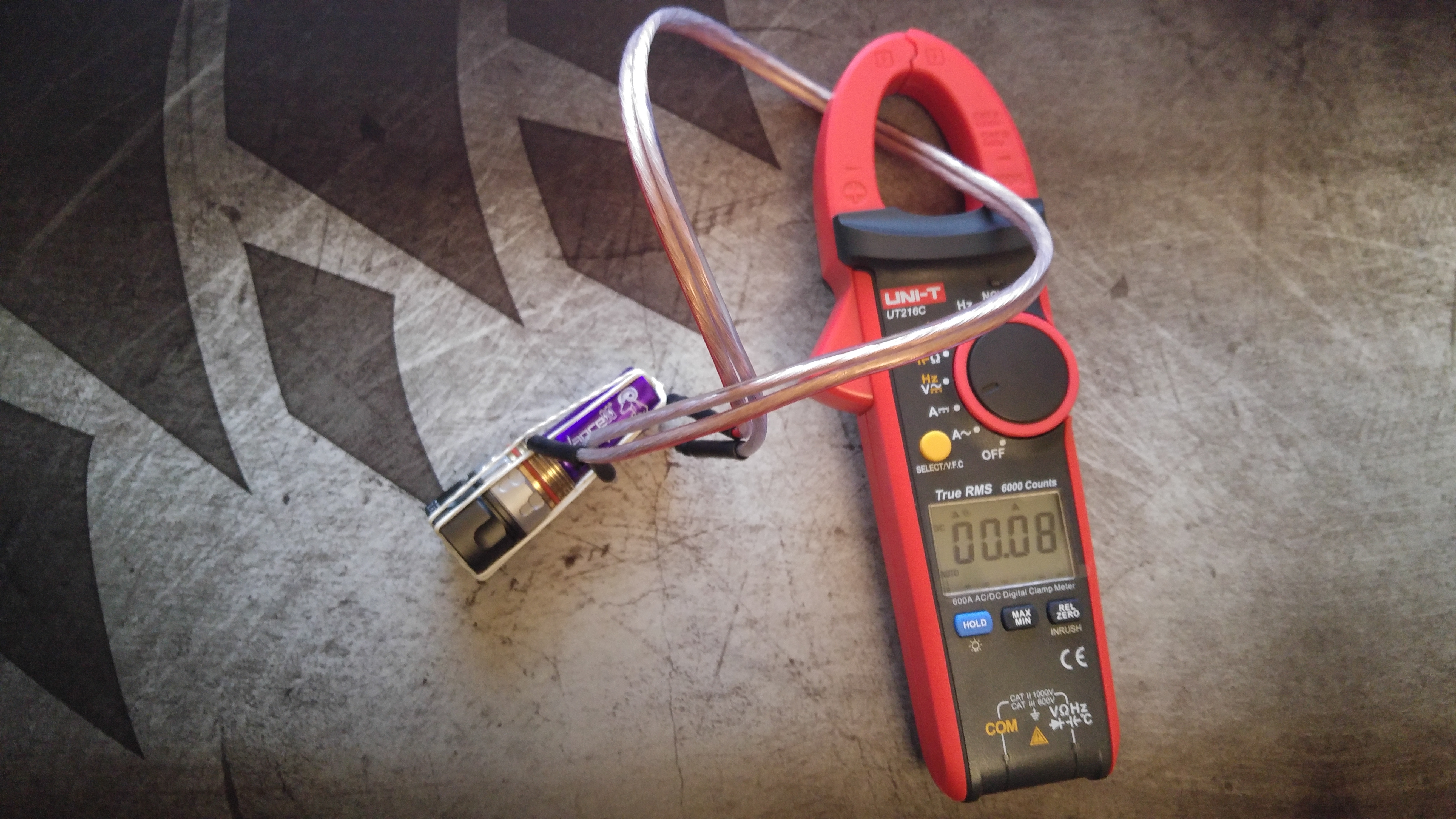

It have problems with high current <5A, but not with low current (and 0.08A is not really a low current ). Other flashlight parasitic drain measurement are ok.
The current is high enough, that I'm able to double check it with my clamp multimeter after zeroing.
And it's correct 0.08A
I just realized you were talking about milli-Amps! I measured less than 30 micro-Amps! You have more than 2000 times more parasitic draw there than I measured. Definitely a faulty light!
