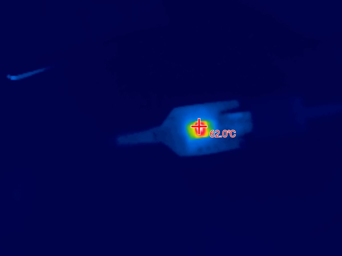

Today, I damaged both the programmer and the USB hub port it was connected to. The label on the programmer reads, ‘USB-C TO UDPI KEY LIGHTED V1.0.’ I bought it in November 2022, so I believe it is the initial version.
Here’s what happened:
Today, I successfully reflashed the SP10 PRO using the programmer, but when I tried to reflash another flashlight (the TS10 RGB aux), the programmer stopped working. At some point, I smelled something burning, which seemed odd. Upon checking, I realized the smell was coming from the port on my USB 3.0 hub.
Current condition of the programmer:
When plugged into a working USB port, the programmer lights up, but the computer does not recognize it (the computer does not make the usual sound when I connect USB devices). If I connect the programmer to TS10 RGB aux, the flashlight aux lights up. When plugged in, the main chip (black SMD component) on the programmer gets hot (measured about 70C).
Has anyone experienced this?
I think Timmc had a couple (5V without LDO i think ?) that did something like this, the latter versions with a LDO should be more reliable since it limits the current, and there are also ESD diodes for voltage spikes on the latest version.

The 5V versions pass through the power right from the USB port. So yes, if something goes wrong when flashing a light using the 5V adapter, there is room for it to pull too much power from USB and cause issues. I wouldn’t say that you should immediately stop using a 5V version, just be cautious and if something doesn’t seem right, unplug it.
Like @thefreeman said, the 3.3V and 4.5V versions have LDOs that will limit the amount of current being drawn from the USB port and should be less prone to issues like this.

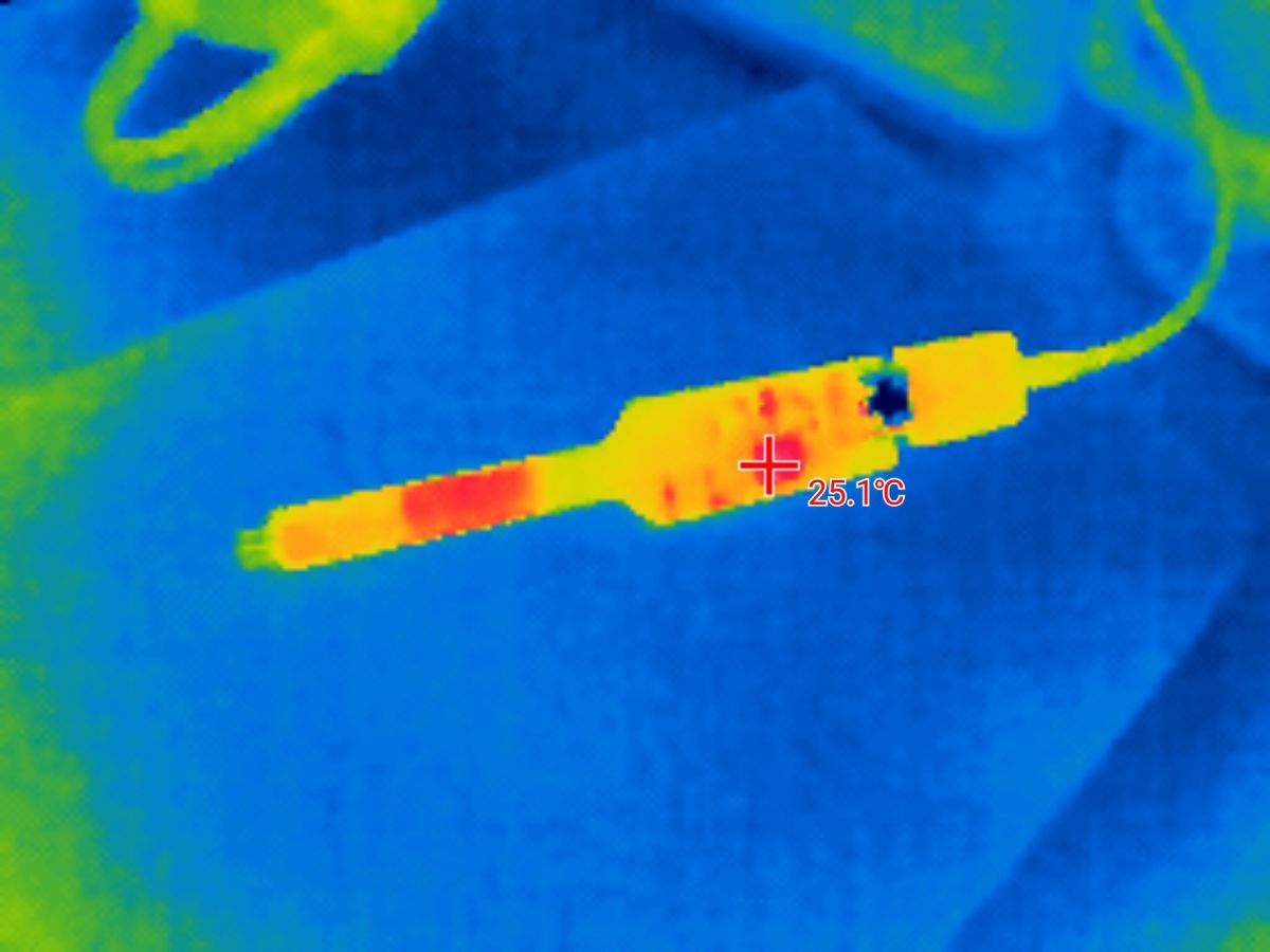

I received the latest version of the programmer today, and it functions as expected with my current setup.
In my current setup, I connect the programmer to a powered USB 3.0 hub. The hub is a 10-port USB 3.0 model with a high-wattage adapter. Previously, the initial programmer failed in this setup—it became very hot and eventually stopped working, damaging the USB port in the process.
The original programmer had been functioning well for a long time, likely before I started using the new USB hub. While I can’t say for certain that the hub was the cause, I don’t recall encountering any issues before. In my current setup, however, I noticed the programmer getting excessively hot. It’s unclear whether this was due to the hub or because I left the programmer connected for an extended period while programming multiple lights.
Although the initial programmer is no longer functional, it still powers on. Attached is a thermal image of the broken programmer. I recommend discontinuing use if it becomes hot to the touch, as it caused problems in my case. I was able to reflash a couple of lights while it was hot, but it eventually failed. So, I would take it as a warning sign.
The current version does not get hot as seen in the next photo.
