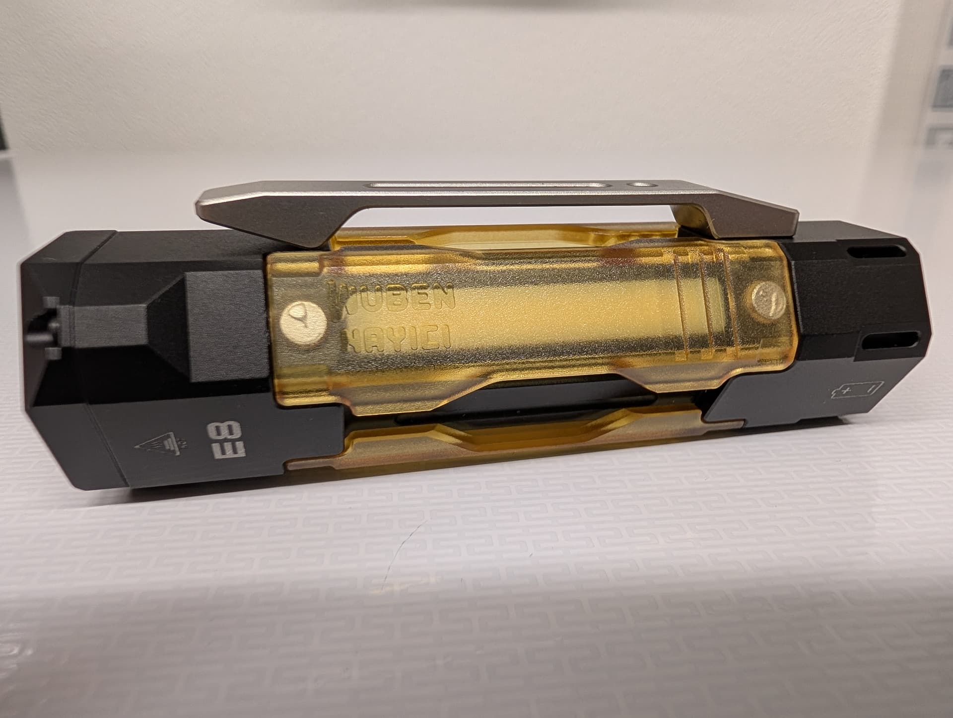

The light came with the yellow colored side covers

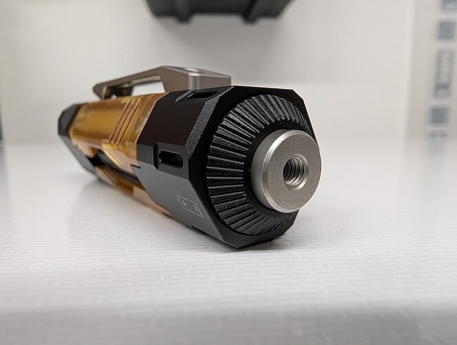

The rear. The thread is M4. The silver part is the switch. Tailstand is extremely wobbly. To get to the battery, you need to have working fingers since you have to use the knurling you see. Could be a problem for people with problems in their hands or when the grease isn’t there anymore.

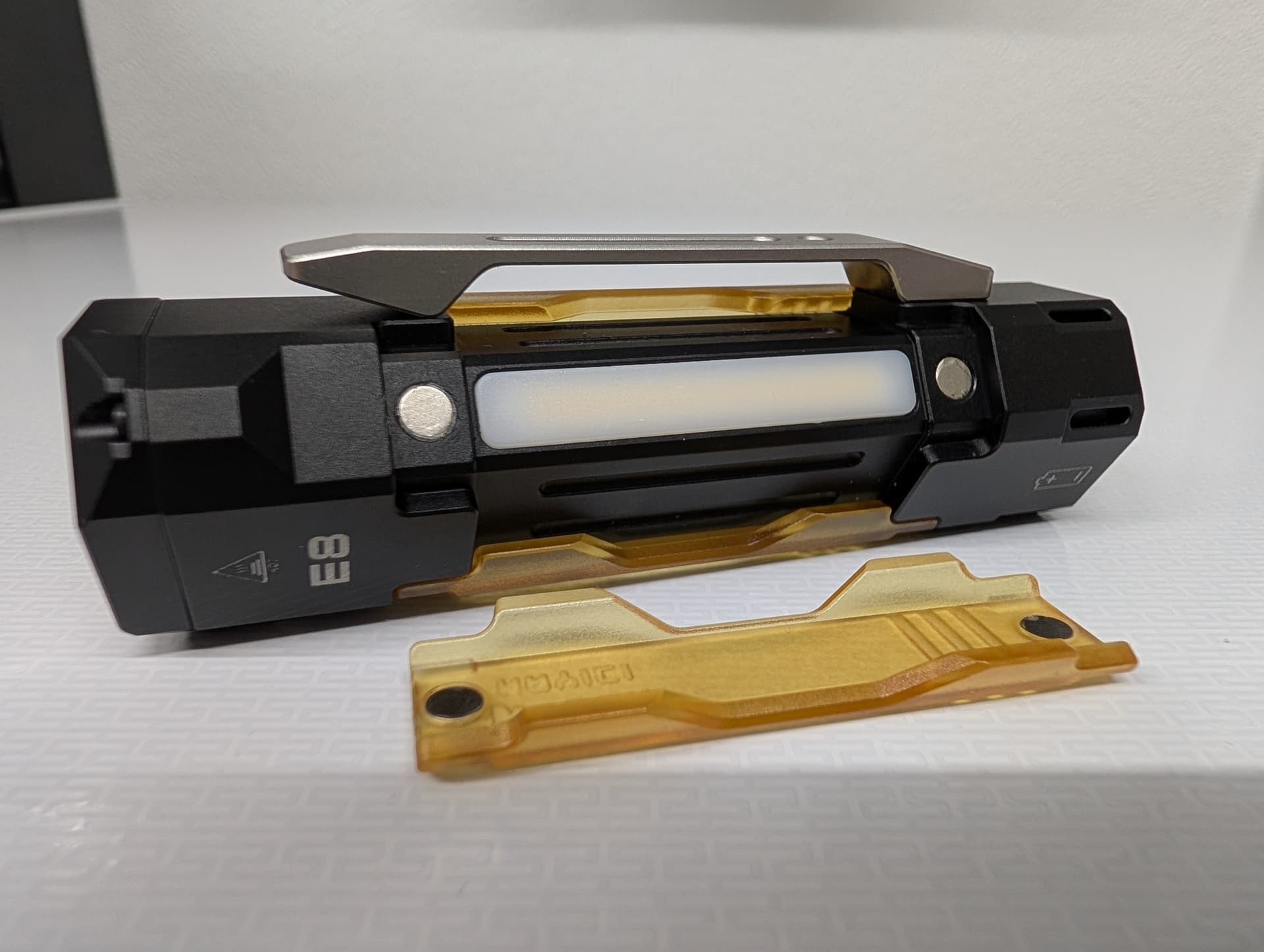

The covers on the side are fixated with glued in magnets. You get 6 spare magnets in the package.

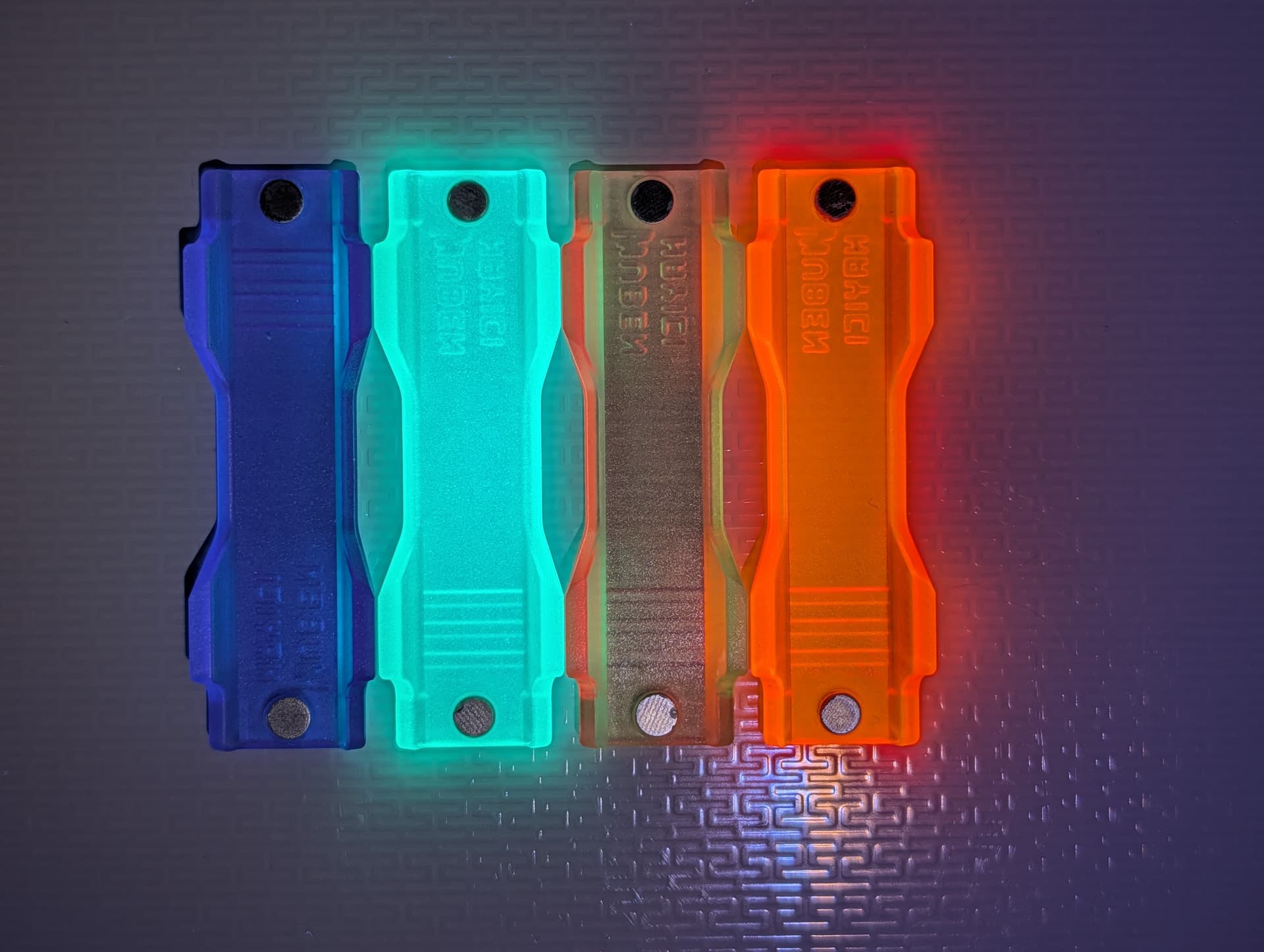

Other covers are available:
White with GITD particles
pinkish red (UV active)
Blue
or all colors?
under UV light:
the white one has GITD particles inside
lookin’ good

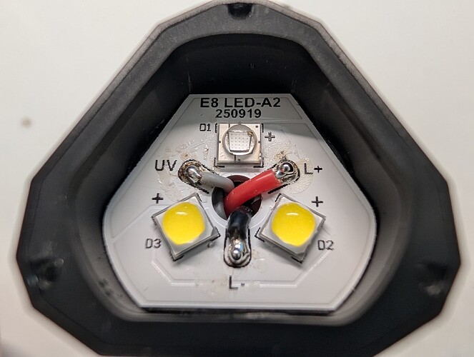

the heart of the operation

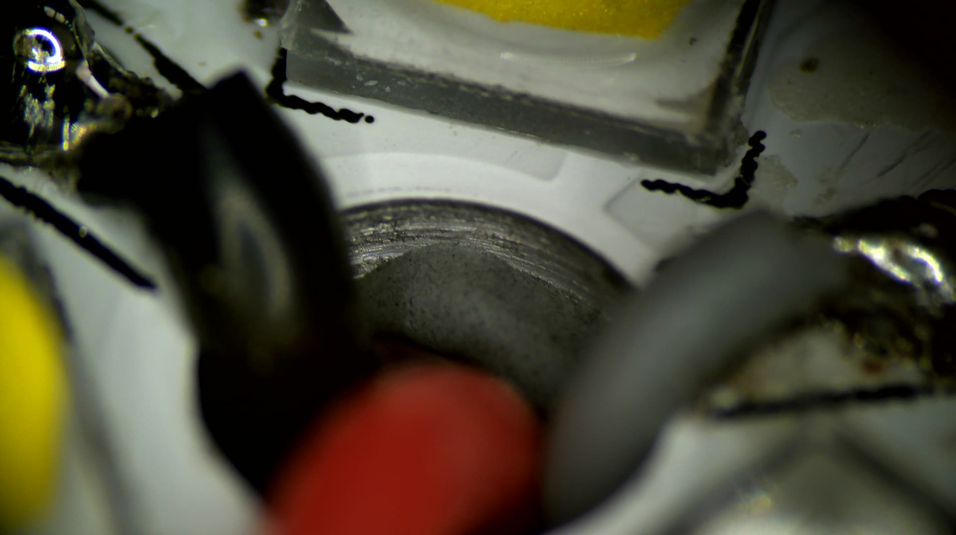

ANd some microscope shots because why not
UV LED up close, looks to be an Luminus SST-10-UV
White LED (Luminus SST-36F 5000K) up close
This one bugs me a fair bit, the MCPCB seems to be made from aluminum, not from copper.

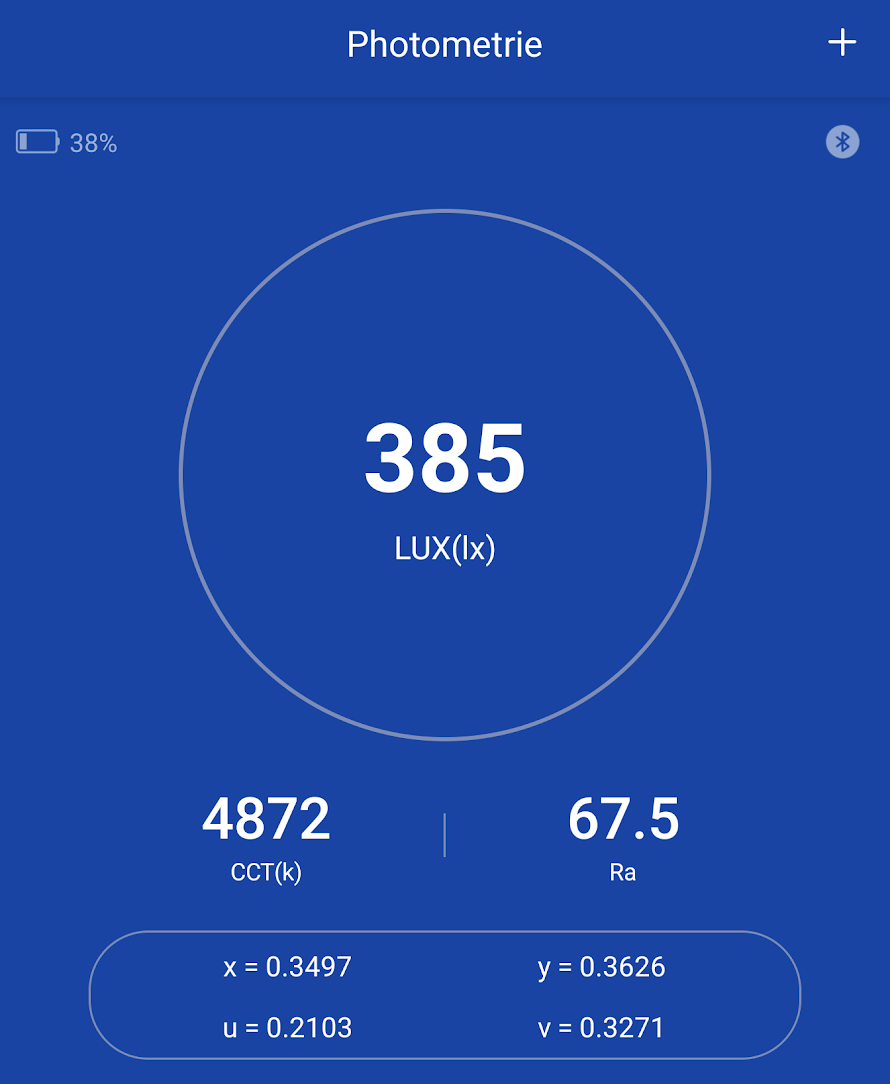

Lux measurements from 20cm distance:
Sidelight without any cover (20cm):
Lux measurements from 1m distance:
Main light High/mid/low:
→ DUV: 0.0034 in high
I was quite shocked by that low CRI because the white looks so good.
