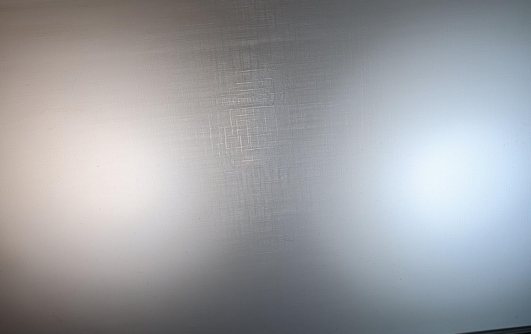

Thanks for the link, incredibly detailed! I must confess the parts about R9/Re/R1-8 etc go completely over my head, but last night I put my 6000K HD10 (received in early October) beaming against a white wall and even at Turbo it didn’t look anywhere as green as in your pic; here’s a pic with it to the right, and my venerable 4000K TS10v1 (the initial batch with the great LEDs), also on Turbo, to the left for comparison:
Sure, it looks blueish, but AFAIK that’s normal at 6000K and I can see very little green (sorry I don’t have an Opple or similar to give you an objective measure).
From my limited experience and with what my eyes can see, comparing it to your picture I would say your HD10 has a serious tint problem :frowning:
