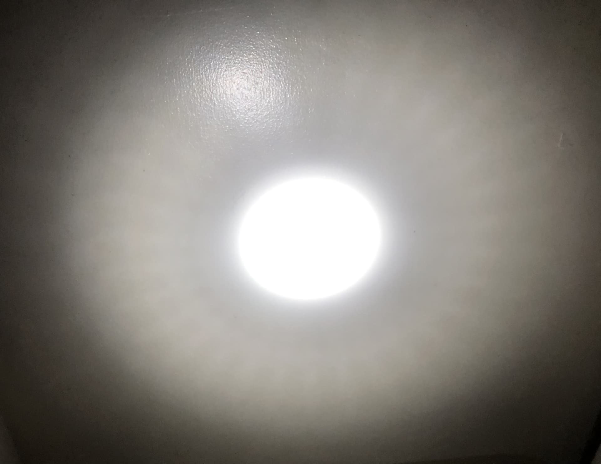

Absolutely. Especially the diffuse spot is wasting a lot of potential throw. This beam offers better usability in the closest range (like for reeading a book or something), but in the end you have to decide what you want: a real pocket thrower (similar to Wuben E6) or just an allrounder. In current state, the TS10SG is more like a throwy allrounder, not a dedicated pocket thrower. However, the normal TS10 does the latter quite well.
Here is a picture where you can see it more clearly:
Here without markings:
The artifacts are there, they can be seen clearly in my whitewall shot, especially if the beam is moved on the wall. Unfortunately I can also see them on other smooth surfaces as my white wall.

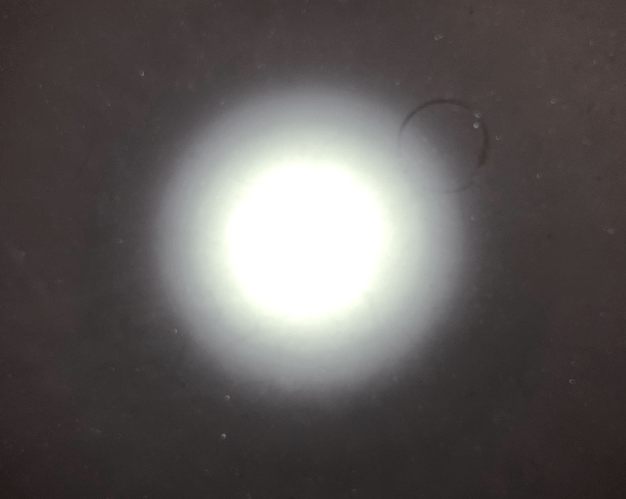

thank you for the photo with the circle showing the center hotspot plus the diffused corona. I find that combined 10 degree beam spread very useful for finding my cat in the yard :wink:

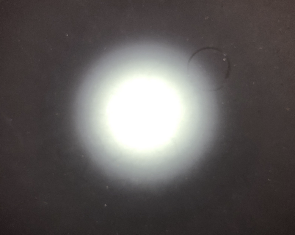

in addition to the central beam, including the diffused corona:
the optic produces a useful spill for seeing the ground in front of my feet:
do you consider any of the photos in this post, as having bad artifacts? I dont, but maybe we use the word differently.
artifacts in the beam, not in the photos.

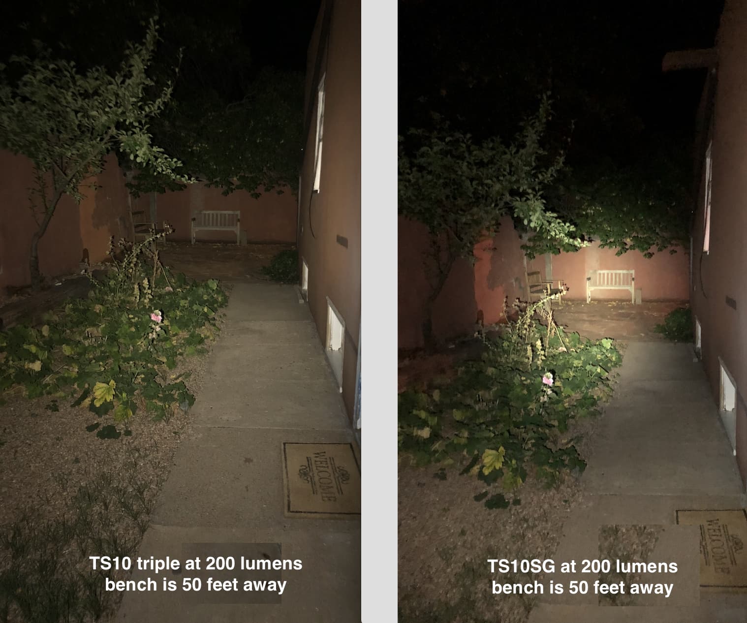

thanks for the link, here are the three photos from tuig 101
I do not know the distance he is trying to reach w the beams.
It may be useful to start mentioning some actual distances and lumens that are used in the photos

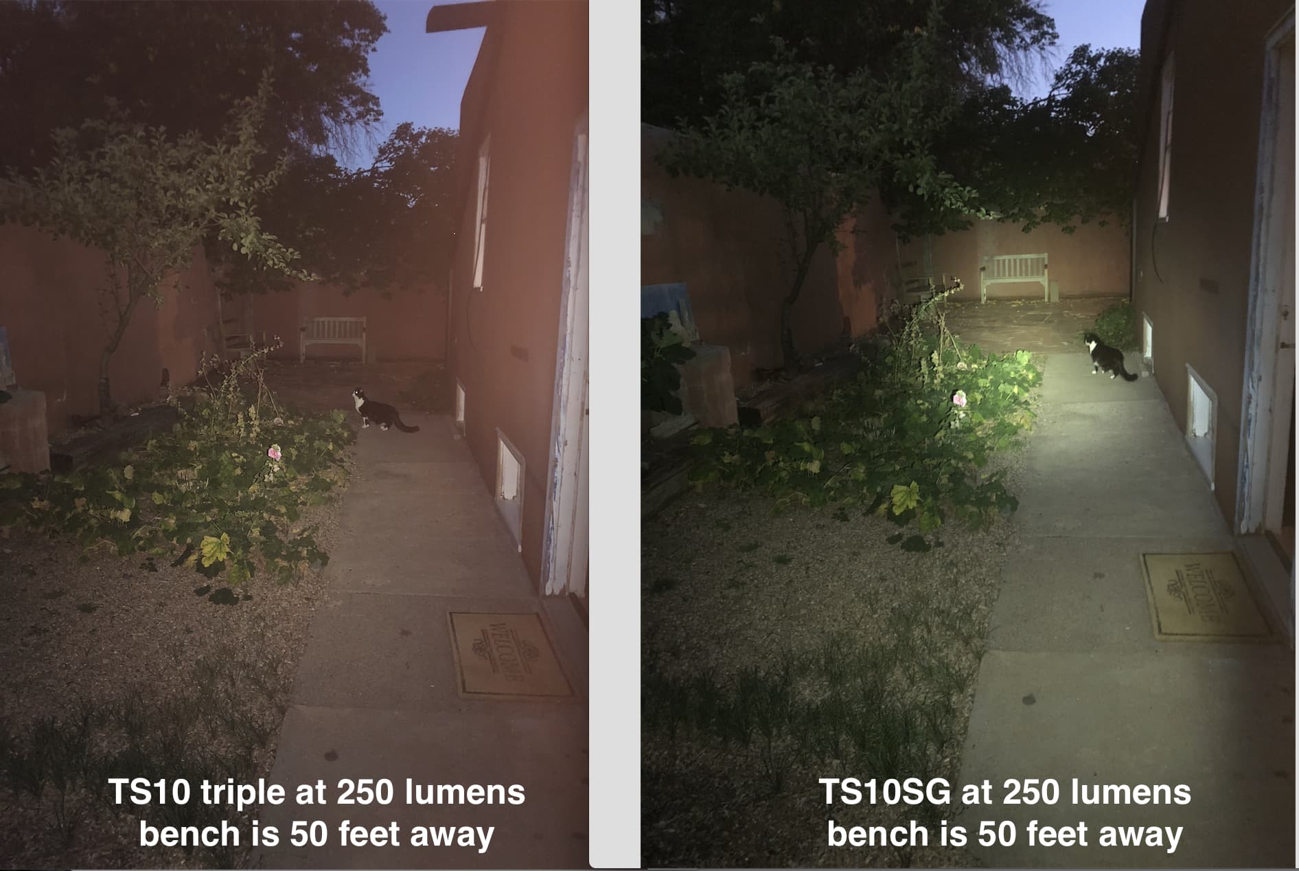

my backyard testing shows the TS10SG easily reaches 50 feet with just 200 lumens, while the TS10 Triple does not:
