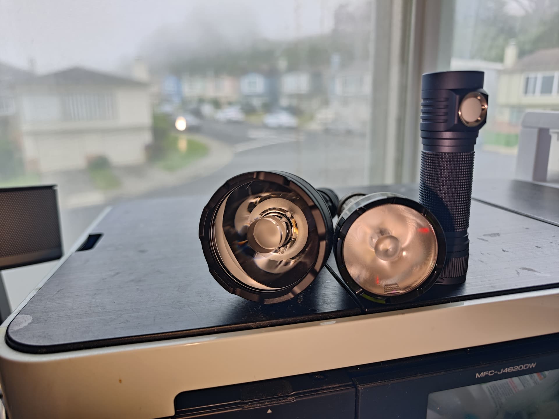

I bought the TD01C because of the buck driver and wanted to try the SFT40 3000k. I am actually not too impressed with the SFT40 3000k. I don’t like lights with positive DUV tint and the host is really bulky for so little power. But I have to give credit to Wurkkos for finally using buck driver instead of the cheap unregulated drivers most low cost brands are using.
Edit: I recharged the battery and realize the previous test was done with an almost depleted battery. Reran the test and the output on turbo is actually 826 lumens instead of 548 lumens. Top of ramp didn’t change. Here are the updated test results.
| Wurkkos TD01C | Turbo | 826 lumens | 3231K | -0.0007 DUV | 94.9 CRI | Blue light relative amplitude 0.50 | 80.5 R9 | 88.7 R12 | 91 Rf | 104 Rg | Samsung 50G |
| Wurkkos TD01C | Turbo with low battery | 548 lumens | 3181K | 0.0008 DUV | 96.0 CRI | Blue light relative amplitude 0.44 | 86.0 R9 | 89.2 R12 | 94 Rf | 103 Rg | Samsung 50G |
| Wurkkos TD01C | Top of Ramp | 493 lumens | 3198K | 0.0014 DUV | 96.2 CRI | Blue light relative amplitude 0.44 | 86.3 R9 | 88.6 R12 | 94 Rf | 103 Rg | Samsung 50G |
| Wurkkos TD01C | Random level | 171 lumens | 3120K | 0.0020 DUV | 98.0 CRI | Blue light relative amplitude 0.41 | 93.0 R9 | 88.8 R12 | 96 Rf | 101 Rg | Samsung 50G |
| Wurkkos TD01C | Random level | 75 lumens | 3094K | 0.0014 DUV | 98.1 CRI | Blue light relative amplitude 0.41 | 97.3 R9 | 88.4 R12 | 95 Rf | 101 Rg | Samsung 50G |
| Wurkkos TD01C | Random level | 16 lumens | 3039K | 0.0010 DUV | 97.1 CRI | Blue light relative amplitude 0.40 | 98.5 R9 | 87.0 R12 | 93 Rf | 100 Rg | Samsung 50G |
