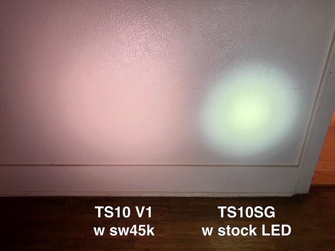

Compared to my MAO TS10 V1 modded by MasterNate to sw45k:
another view of the beam, that only shows the hotspot:
imo the little Tir works very well for its intended purpose and the little pearls on the Fresnel lens eliminates any rings in the perimeter.

bear in mind Im only using an Opple 3… your test equipment will probably produce a different DUV number :wink:
But yes, it is normal that an SFT25 has green tint… thats why it is so bright :wink:
fwiw, the sample koef3 tested with his equipment had a DUV of just 0.0010… a CRI Ra of 70, and a cct of 7204. (the Opple gave it a ridiculously high DUV of 0.0152, a CRI Ra of 59, and a CCT of 5500, but Opple is not very accurate with cool white LEDs). Otoh, yes, the Tint looks green to my eyes, whatever the actual DUV might be.

btw, here is a wall beam comparison at 4 feet from the wall:

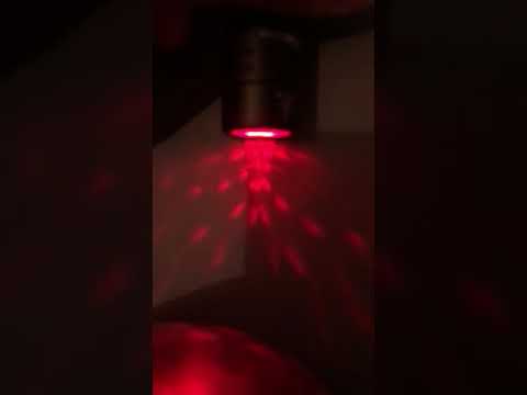

I was entertaining myself with the TS10SG Aux lights and made a video about battery voltage check features:
the video wont play for me on BLF, but the link to view it on youtube works
I think the TS10SG Tir makes some really fun Aux patterns :wink:
(Im easily amused… LOL!)
It plays for me
thanks for letting me know
seems my old imac is becoming inevitably obsolete
