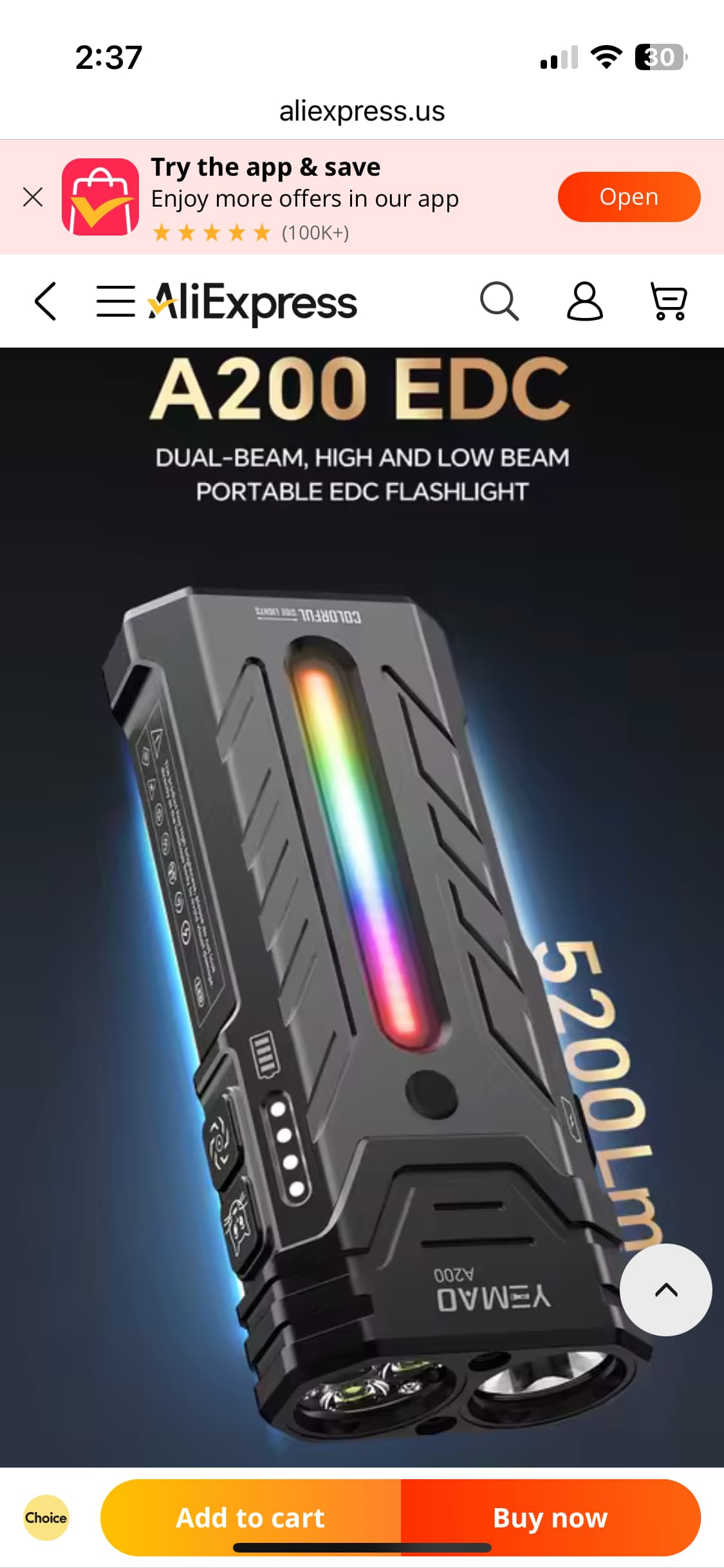

YEMAO A200: Anyone try one?
Seems to be a decent at under 40 bucks. Non-sevicable battery isn’t great, the rest looks OK. Cat button is cute.
Found on AliX, can’t link it.
https://www.aliexpress.com/i/3256809531328696.html
