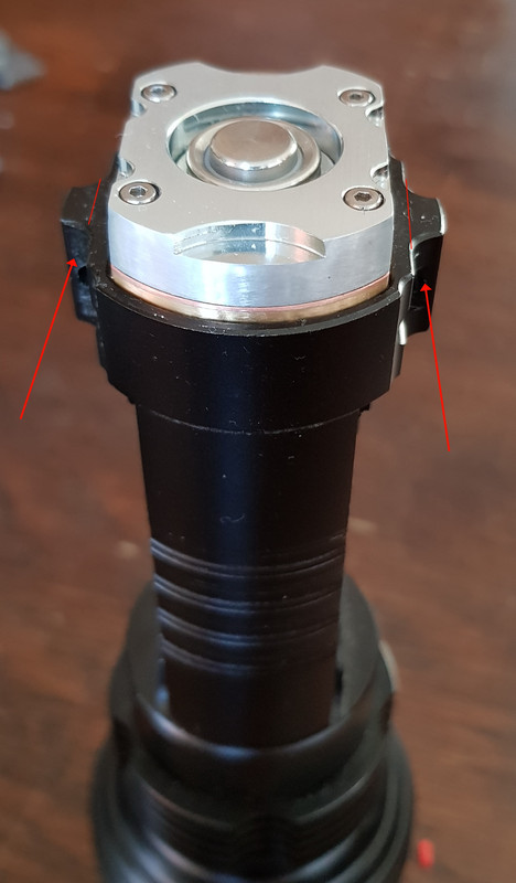

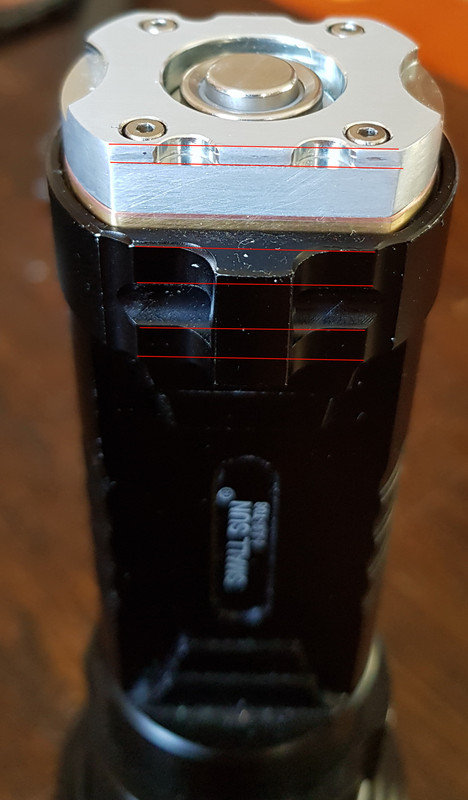

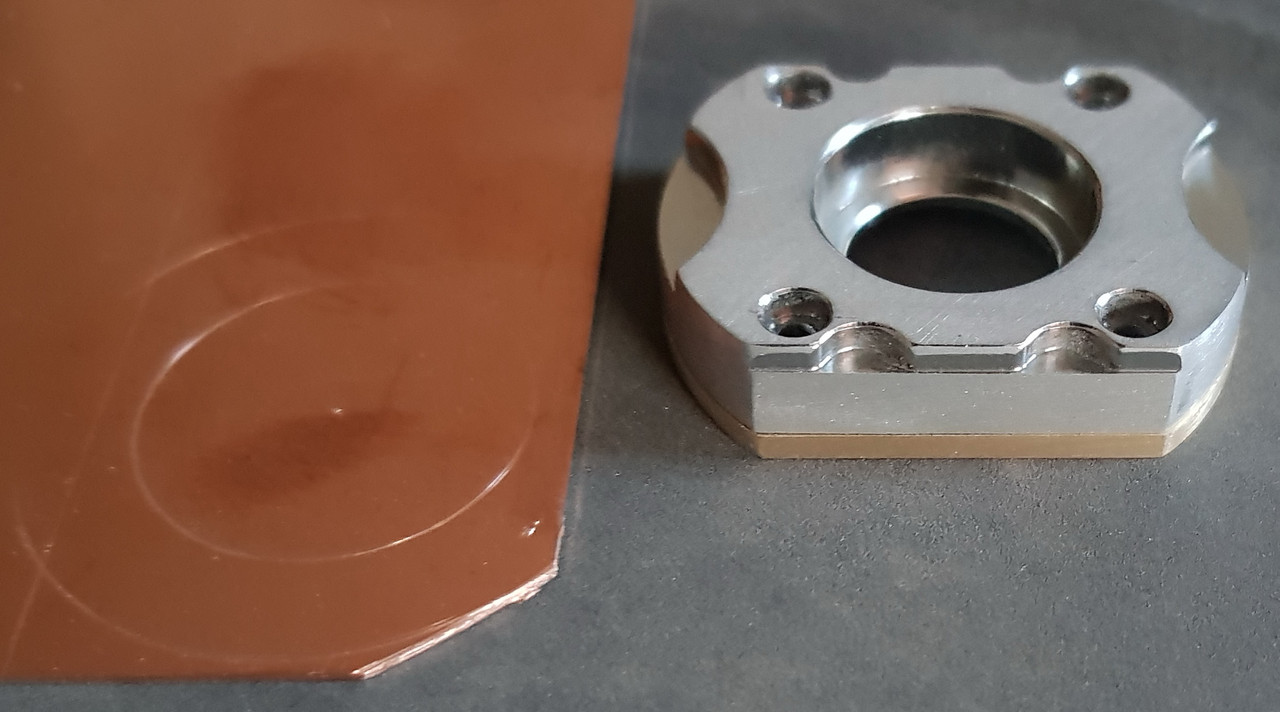

johnkey68
Last seen: 8 hours 5 min ago
Joined: 10/12/2017 - 06:29
Posts: 153
Location: Russia
TrueRMS
Last seen: 1 month 1 week ago
Joined: 08/09/2013 - 13:24
Posts: 264
Location: Marysville OH
Wow nice build! You make the spacer?

johnkey68
Posts: 153
Location: Russia
Yes .
Yes, but only for myself, it’s just a hobby …
I’m not going to make money on it.

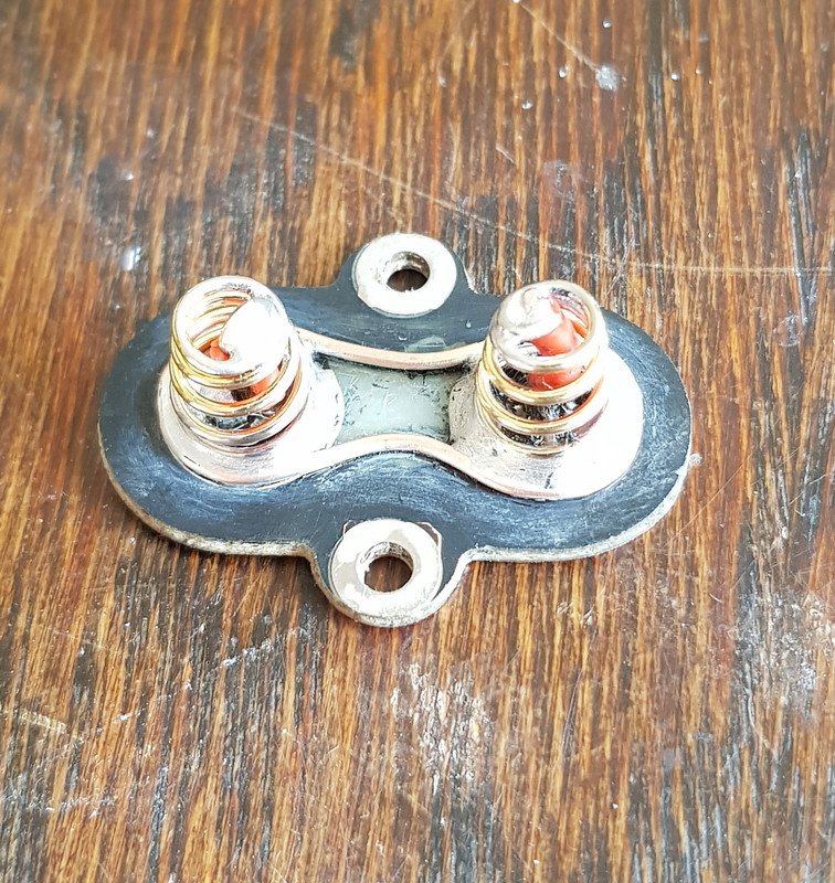

Switch PCB is modded back to 2P battery. In the past i removed the copper layer on 60% of the switch side. So i had to fix it. Used a 0,1mm copper sheet, soldert 2 layers together and glued it on the pcb with thermal glue. Then i were able to install the new switch and the new metal button. Needed a spacer to make it work nicely. But i did not have the right material on hand. So i had to make one brass spacer 2mm and one copper 0,5mm. Soldert both together and made it fit to the aluminium Tailcap. Now i am waiting for some GITD powder to fill the space arround the metal switch button. And the new pill from Kirill that seems to be stuck in customs. But untill then i will remove the red marked area on the pics to make the tube more flat on both sides.

I burned a couple of SST-40’s a while back when I upgraded to dual BlueSwordM BeCu Gen 2 springs in the tail of a Sofirn Q8 and used 30Q’s to power them through the stock FET driver. One burned out really badly and filled the reflector/lens with smoke. The other just burned a little and had permanently reduced output after. Ironically, I was trying to calibrate the Thermal Protection in Narsil, so the light was in full blast Turbo mode, waiting for me to save it from the blistering heat with a simple button push that didn’t come in time. Crazy
