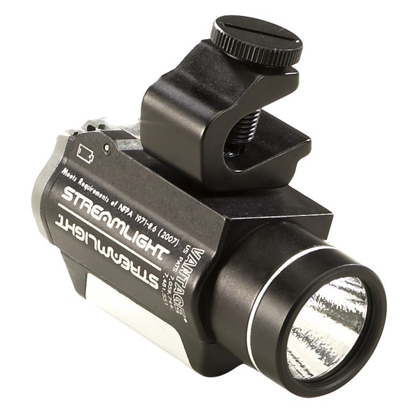

B. Firefighter hardhat mount
Just run the power line up your back and clip to the nape of your climbing gear and feed those lights that way
Just to run a few ideas by you
