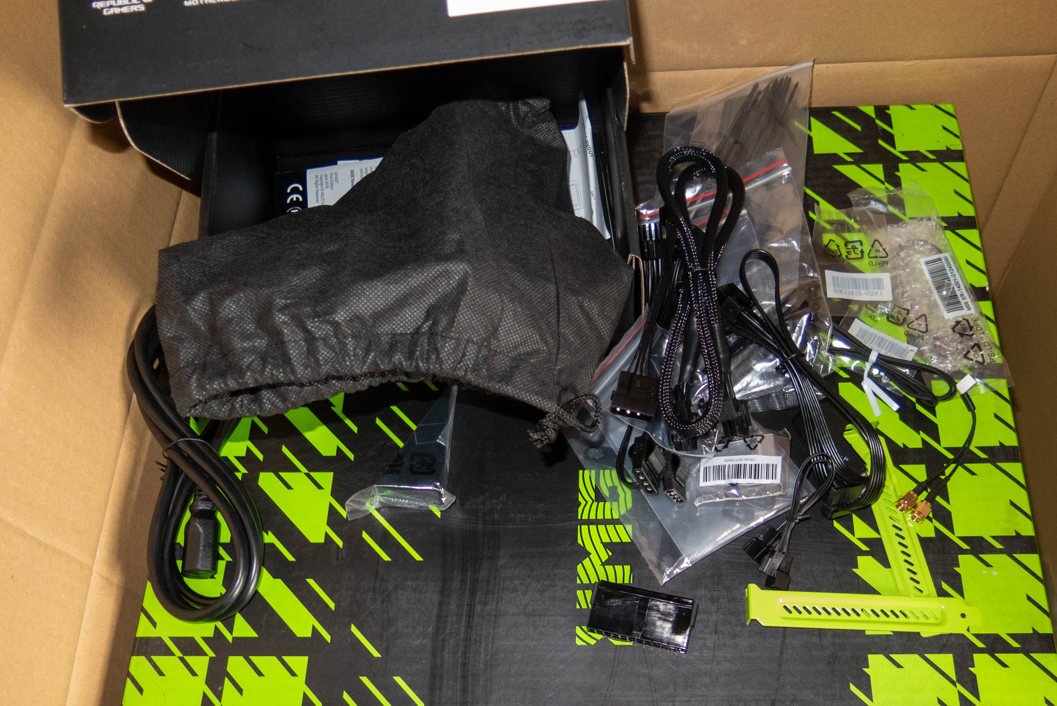

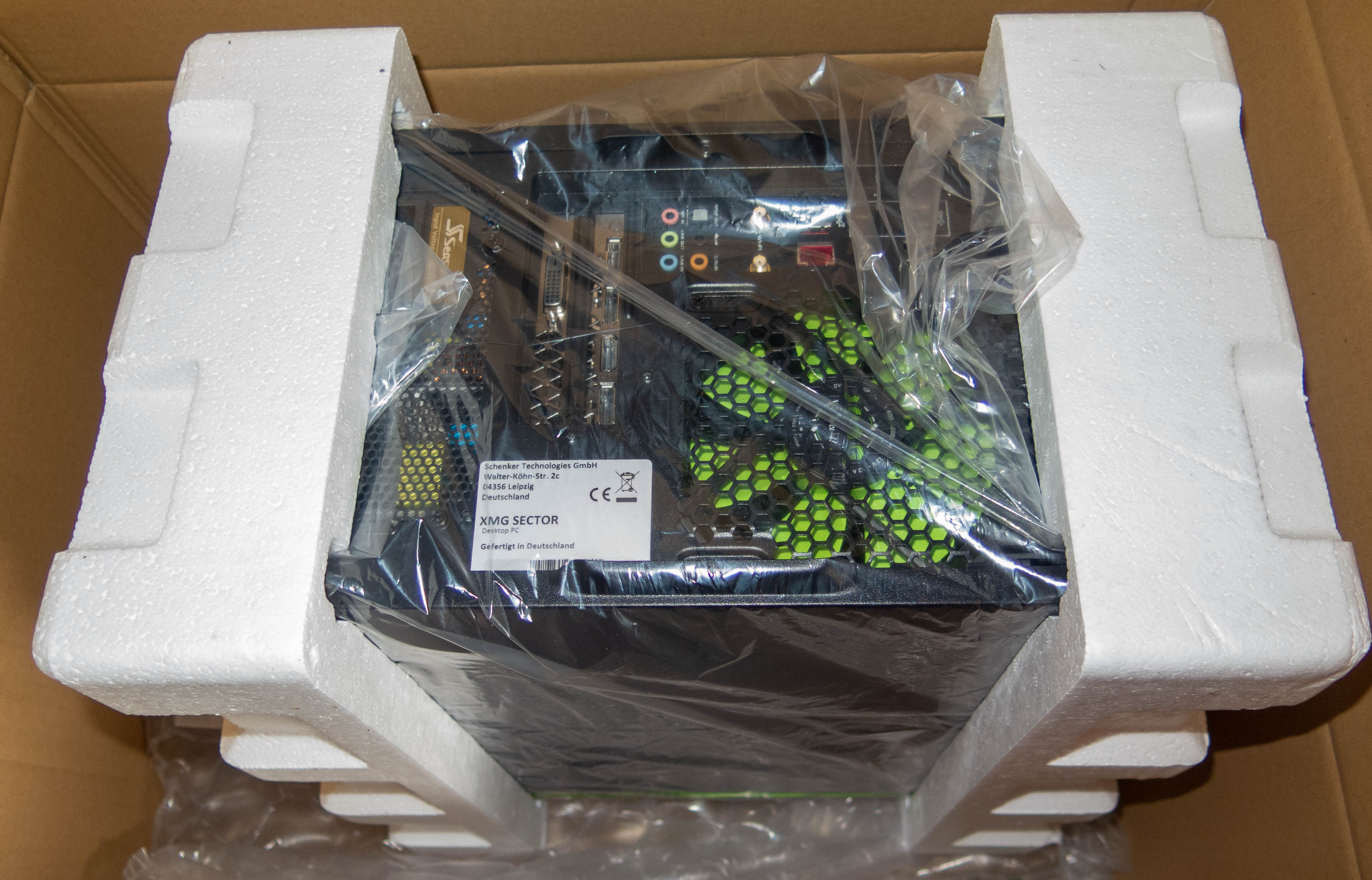

Unboxing

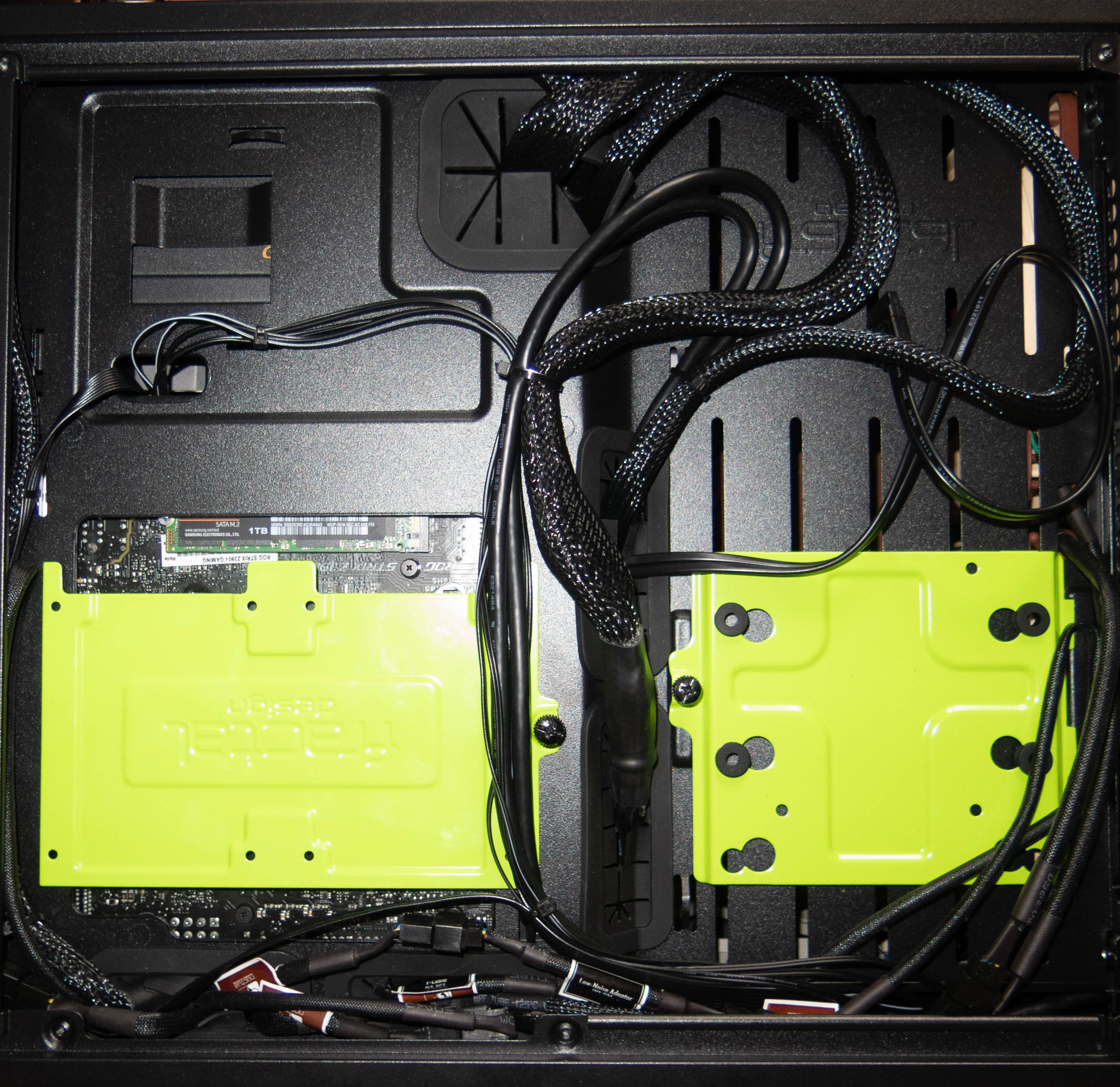

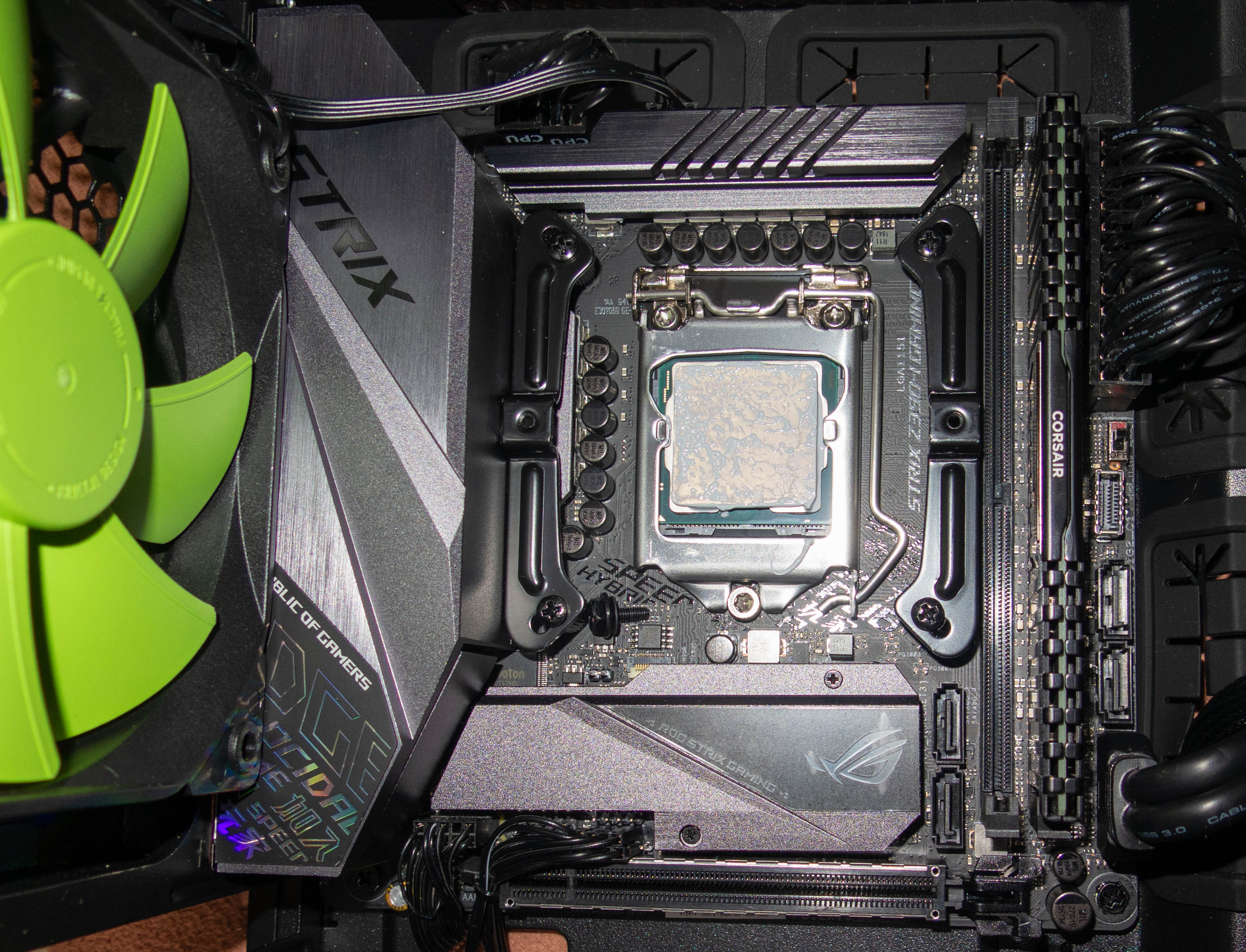

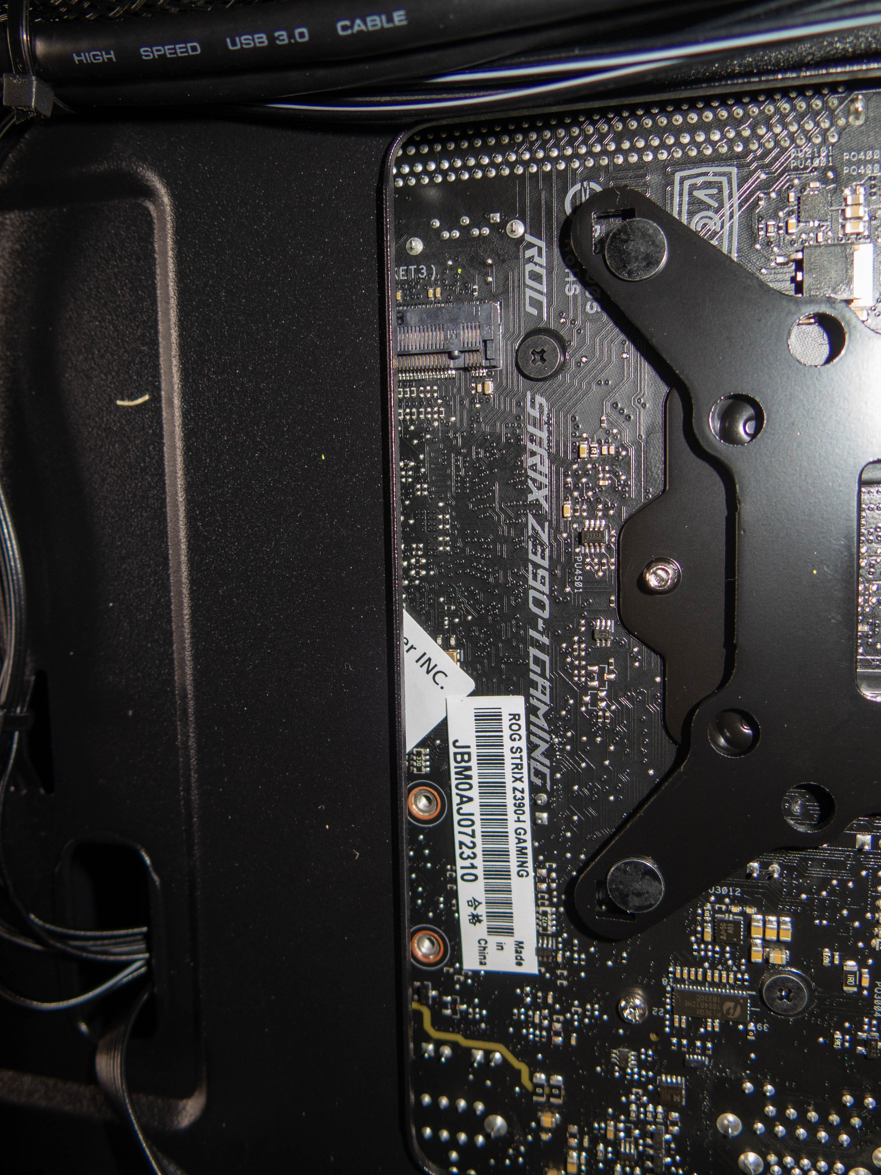

This main board is so tiny, Back side for 2. SDD, of course not replace friendly within the CPU back side opening
Installing the SSD, first remove the CPU cooler and the cooling block

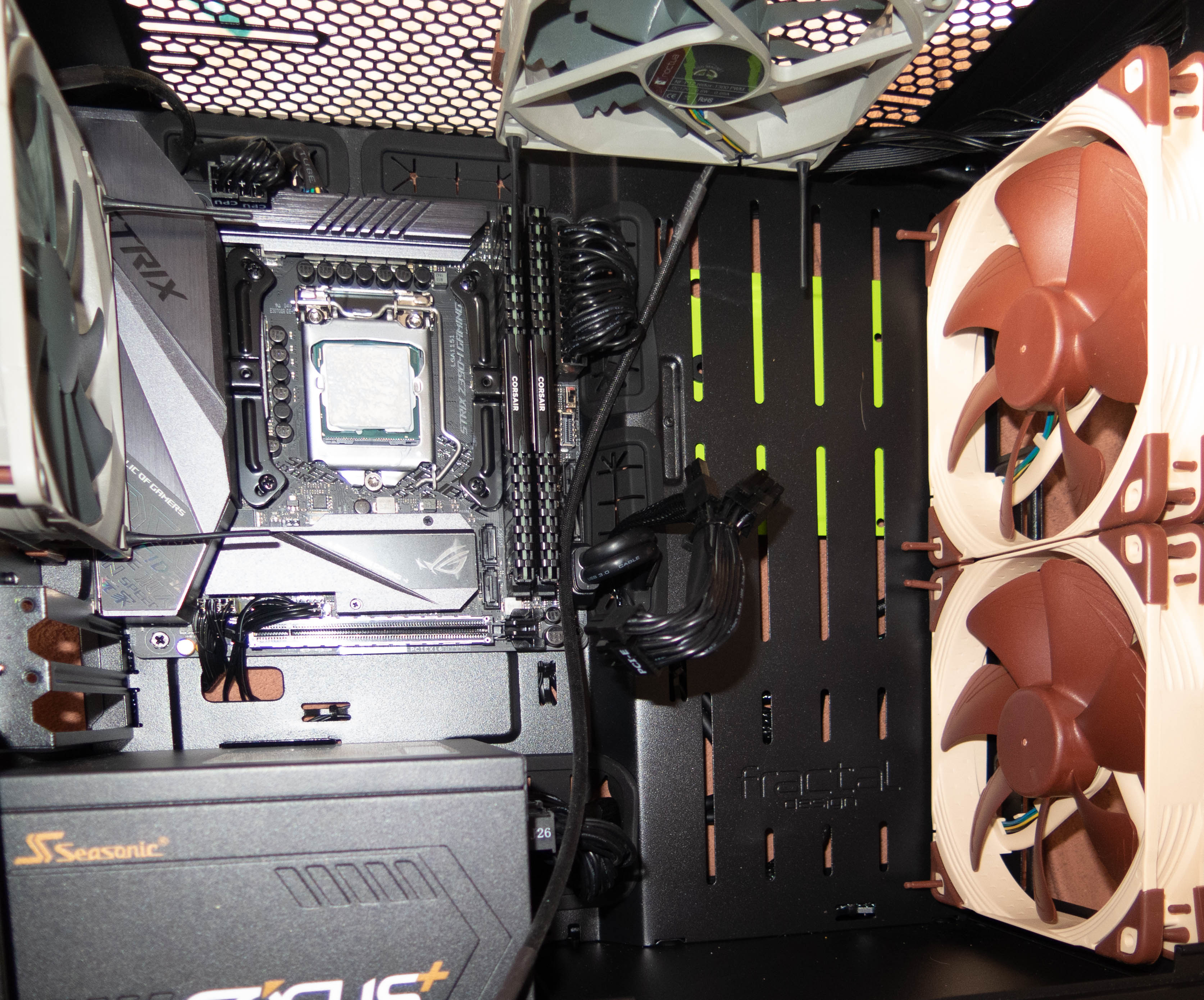

SSD with cooling block mounted and fans installed (of course the wrong way around to find out later)

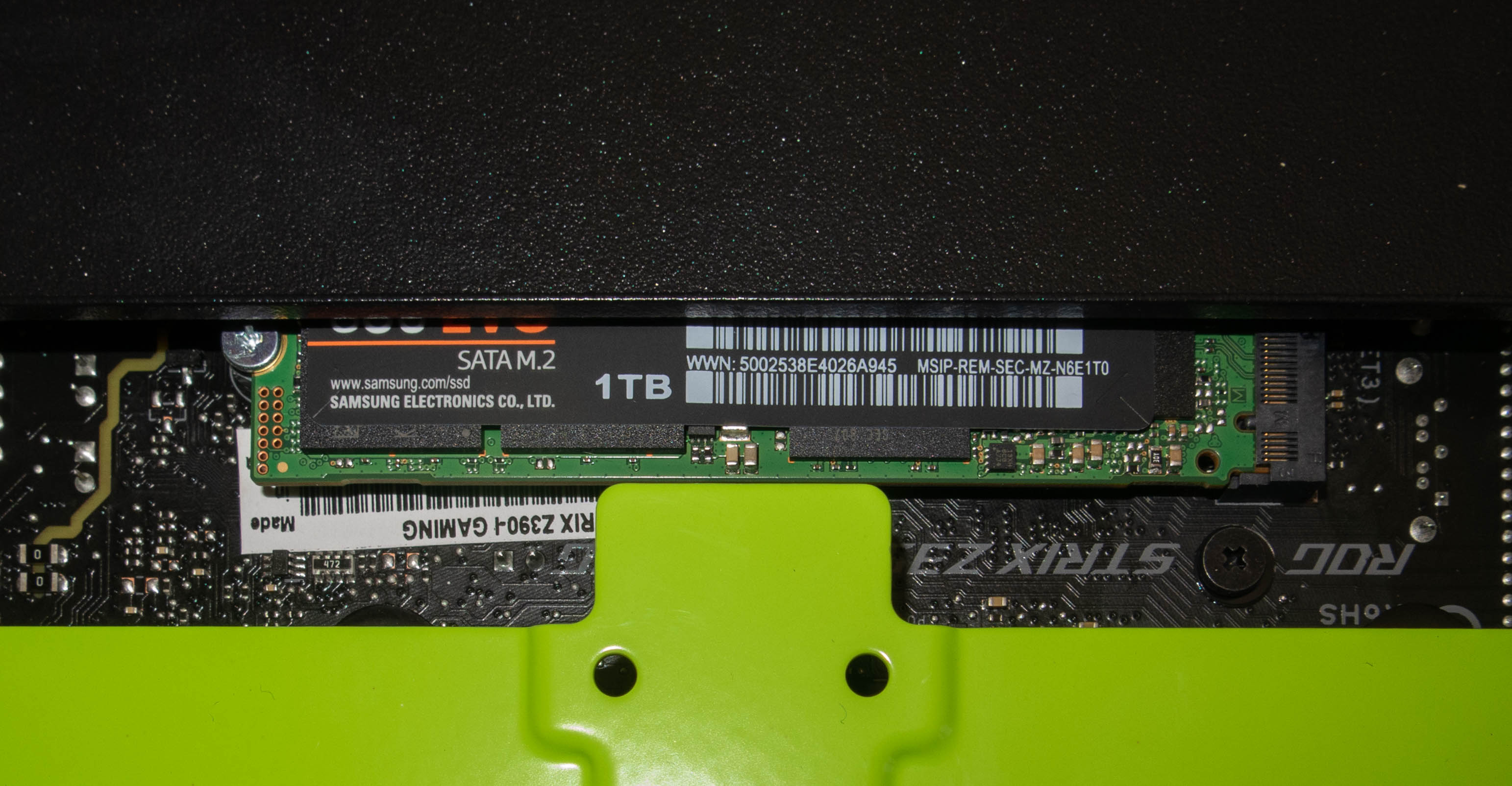

trying tonstall the back side SSD, I noticed that the spacer to screw there is too high
So again back to the other side, of course I had also already the CPU cooler installed, so disassemble all again just to find out that the one spacer is too long
Then checked again the main board box with all the components, finding inside an AMD manual and leftovers from Cooler assembly marked with big sticker Intel
I had to unscrew the main board to get the SSD installed

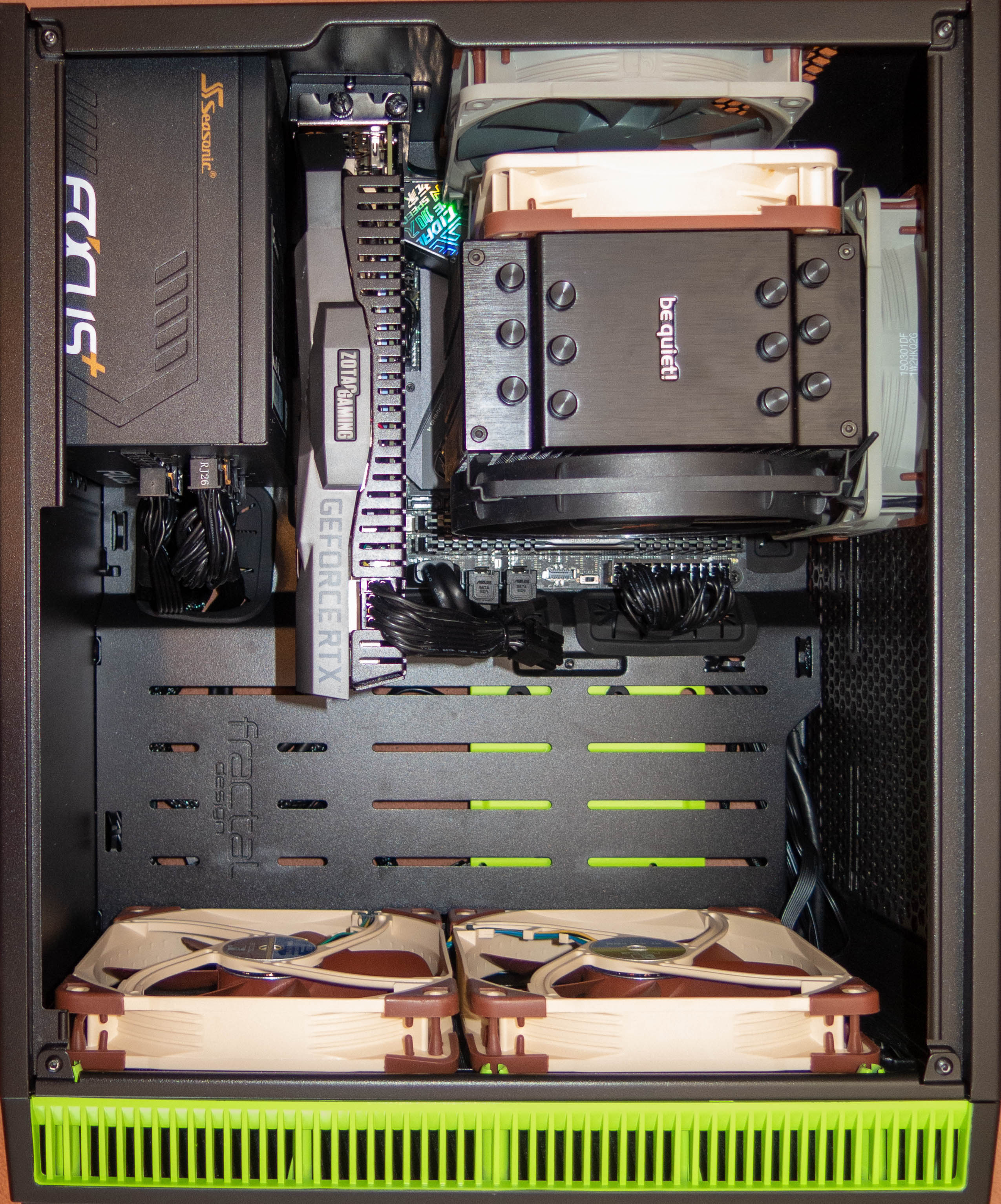

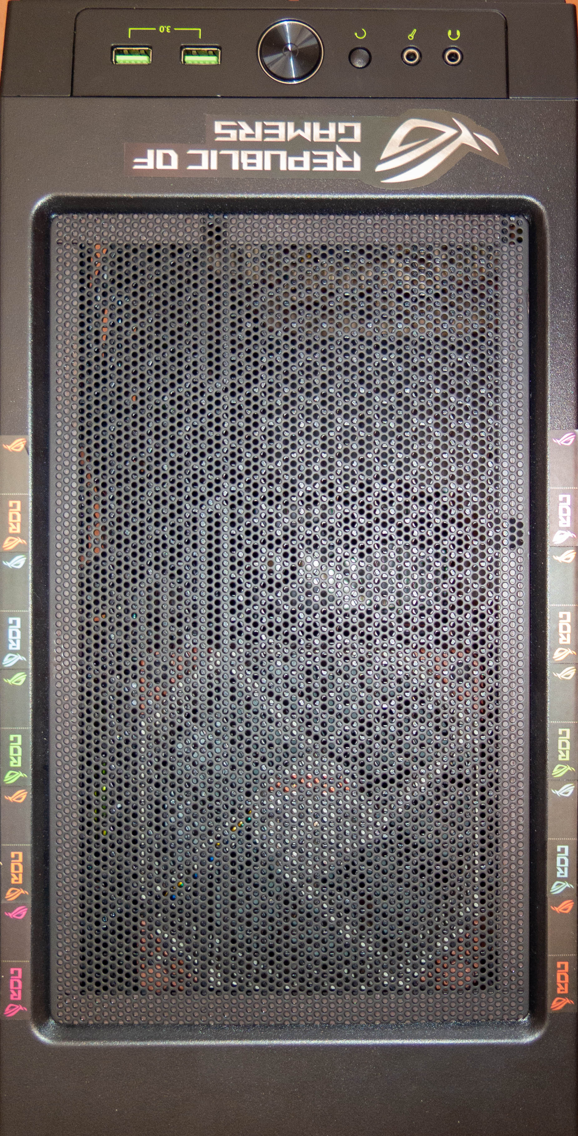

So now powering it up I found out the front fans blow outside the case not inside

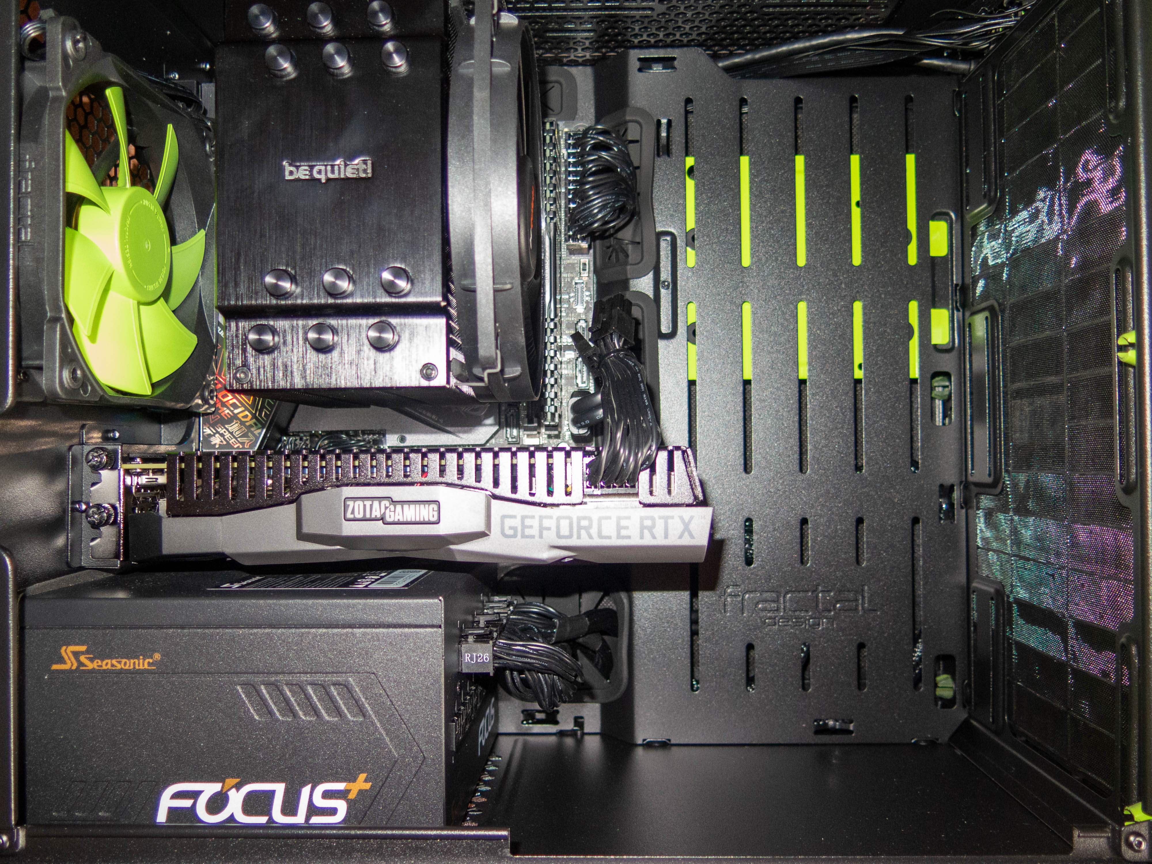

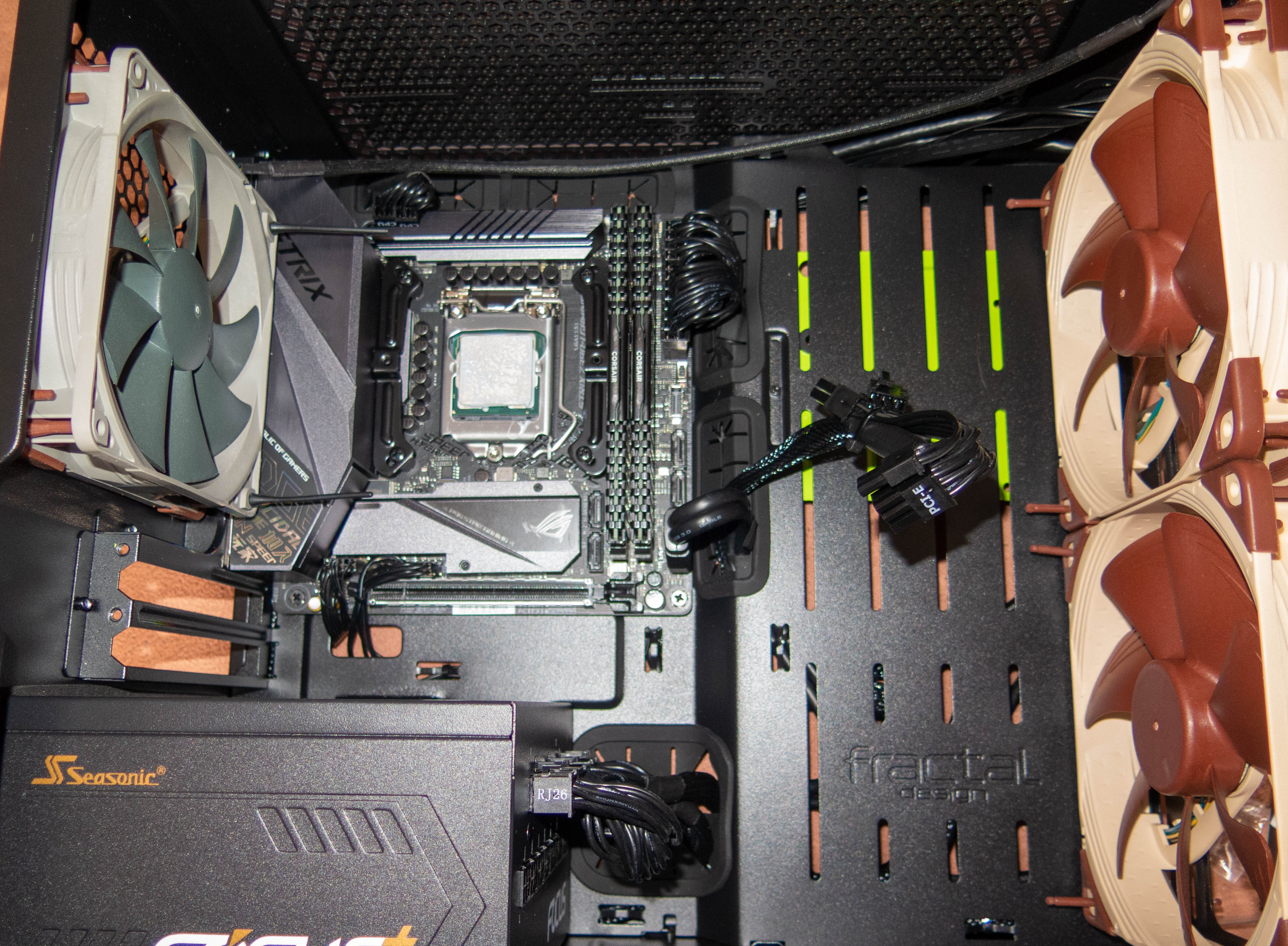

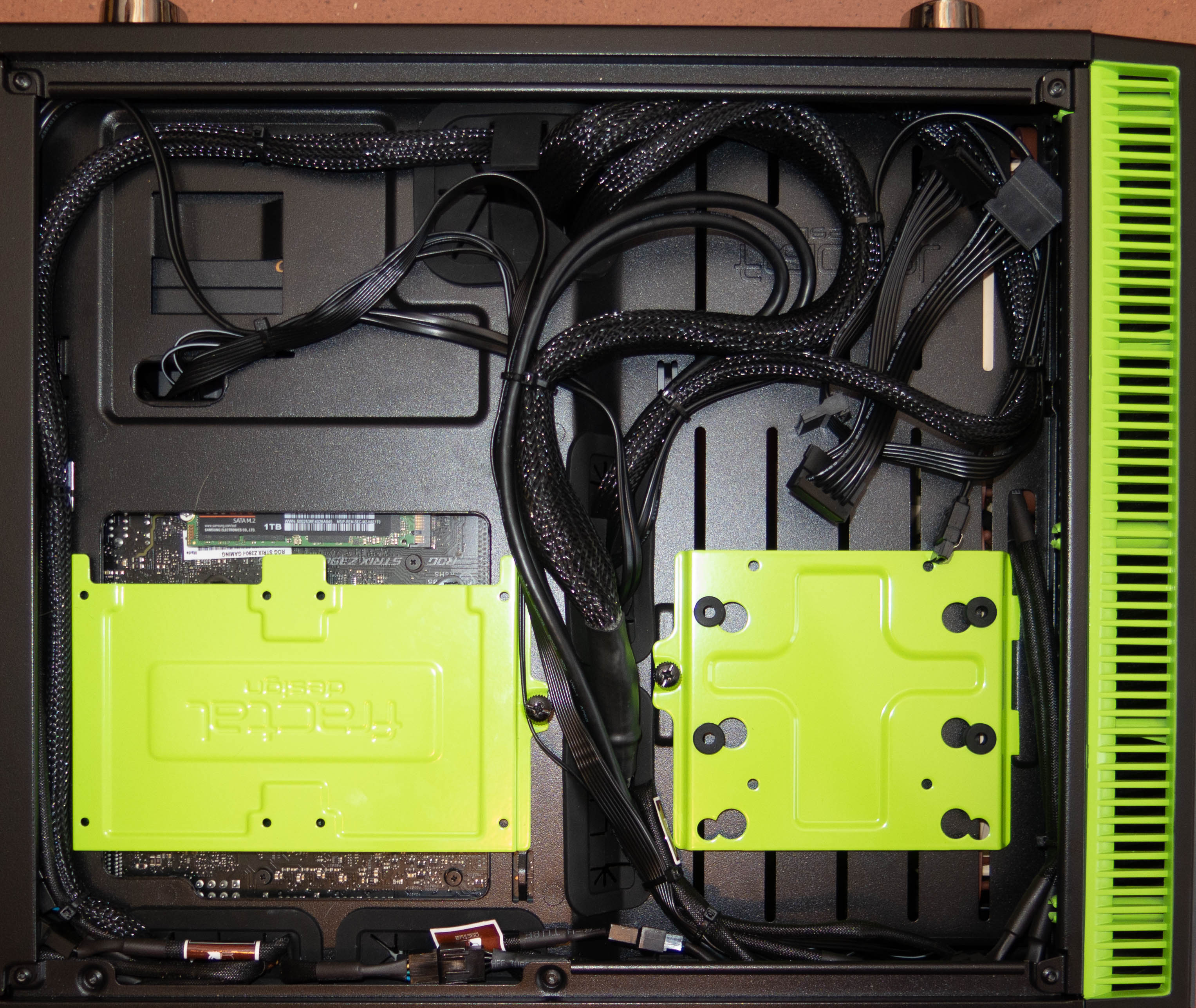

The other side of the PC for cable management and final component side

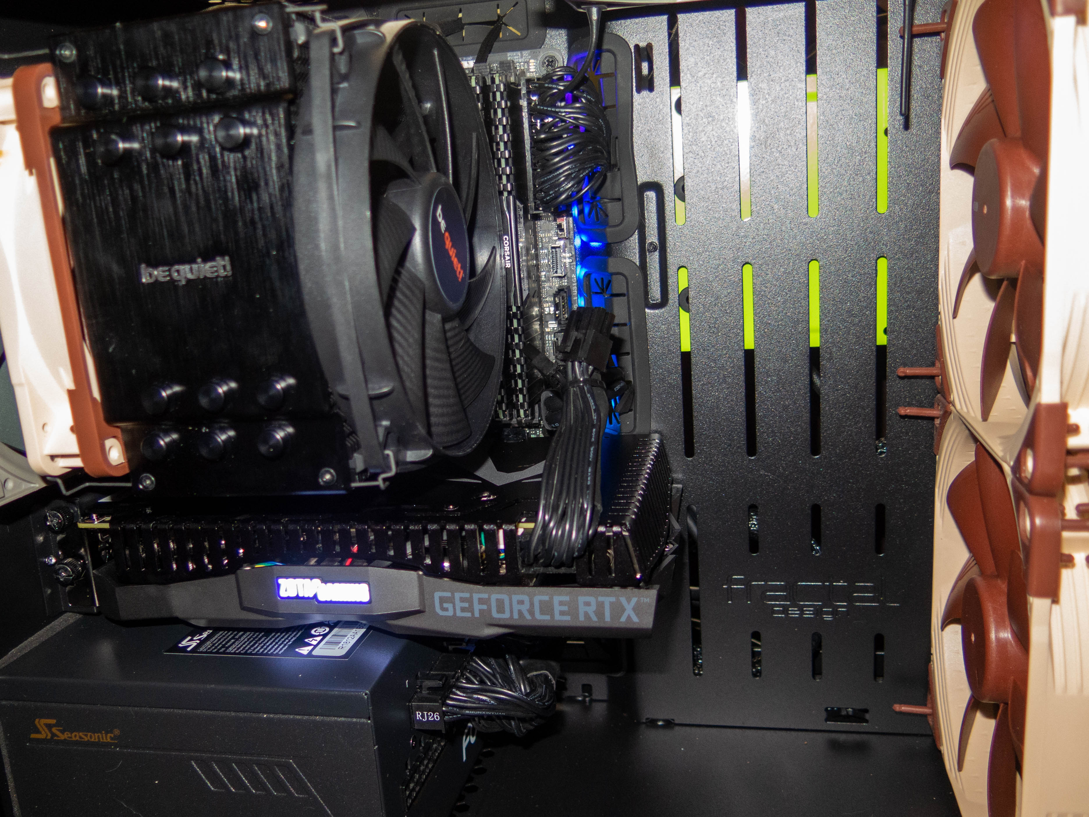

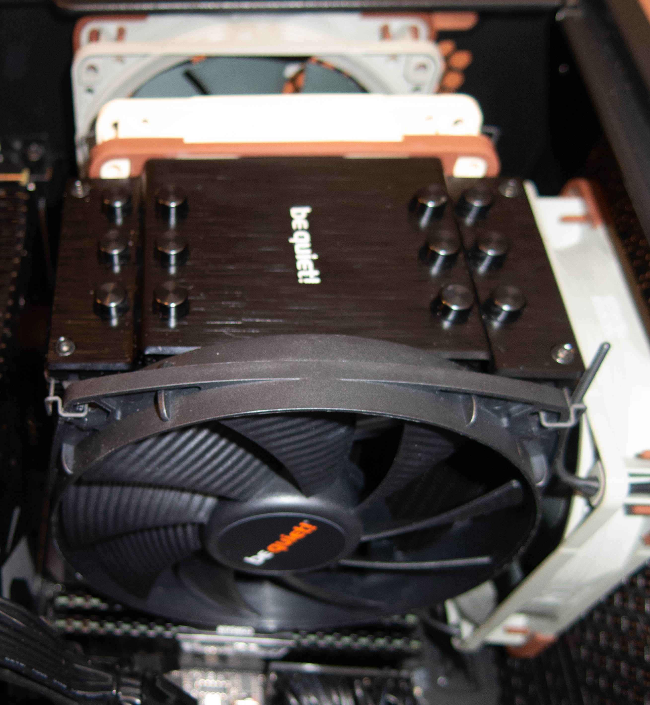

CPU cooler is pretty much surrounded by fans

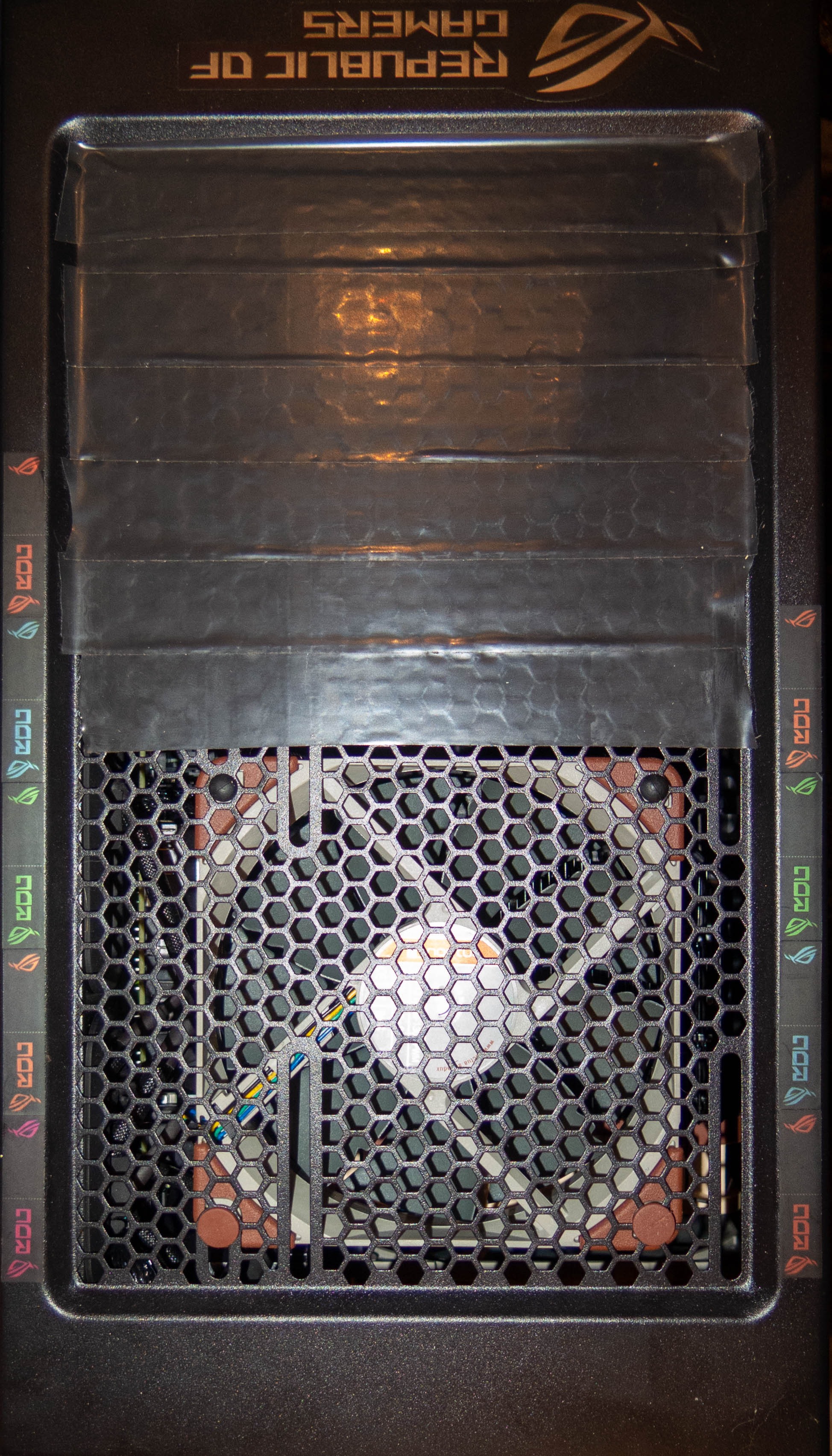

Top view, later enhanced the air flow taping front side

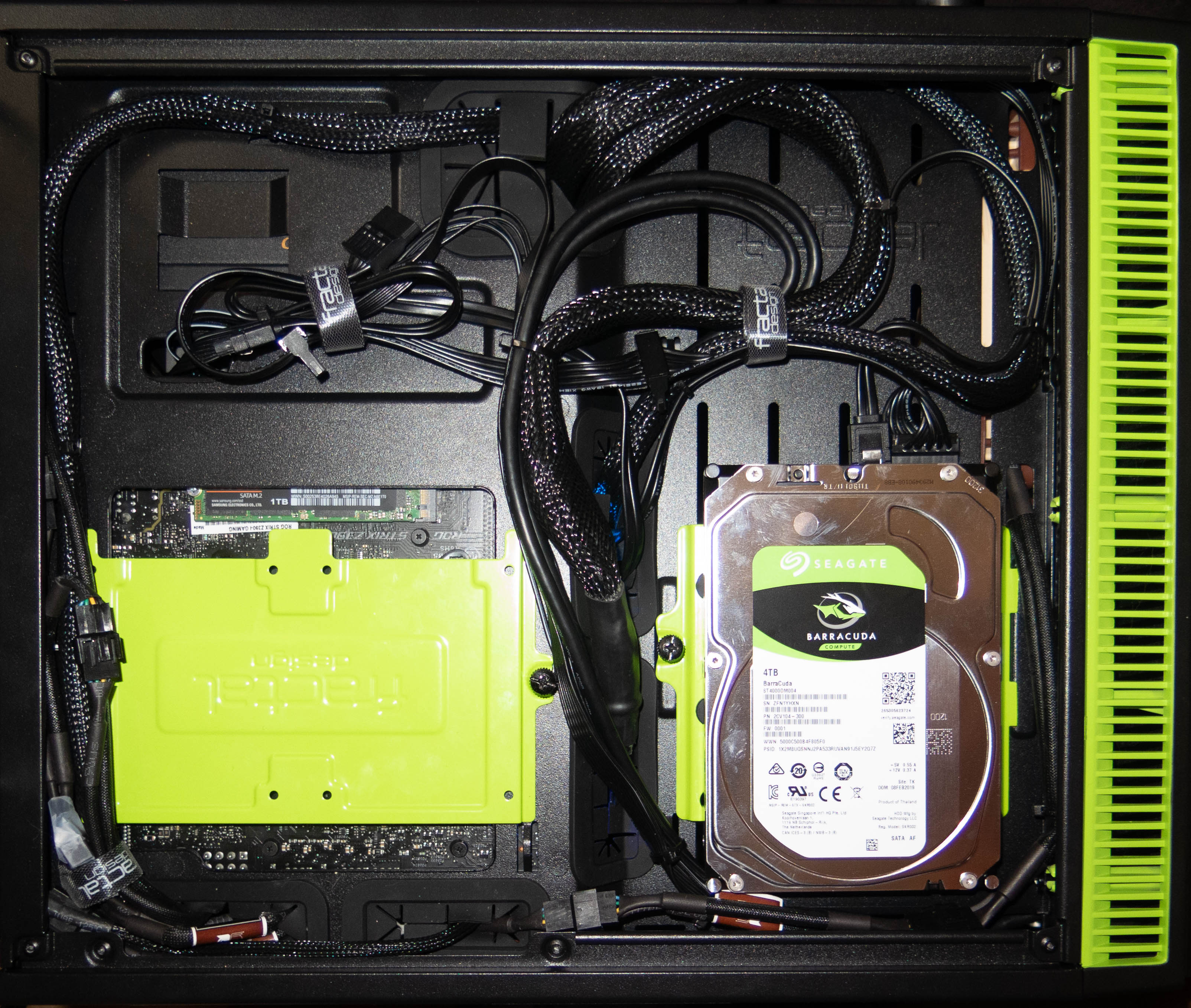

Adding to the main board and PSU cables for SATA drives

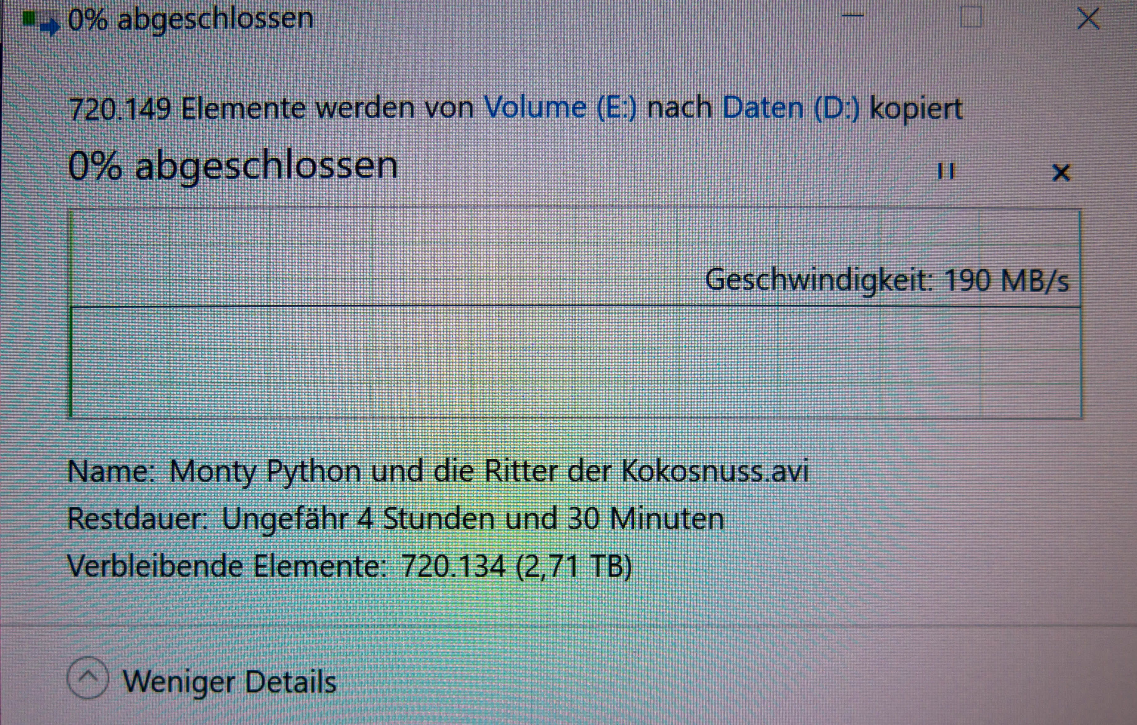

Temporary installing the old external drive internal to speed up the copy, here a random picture from copy process but very funny movie

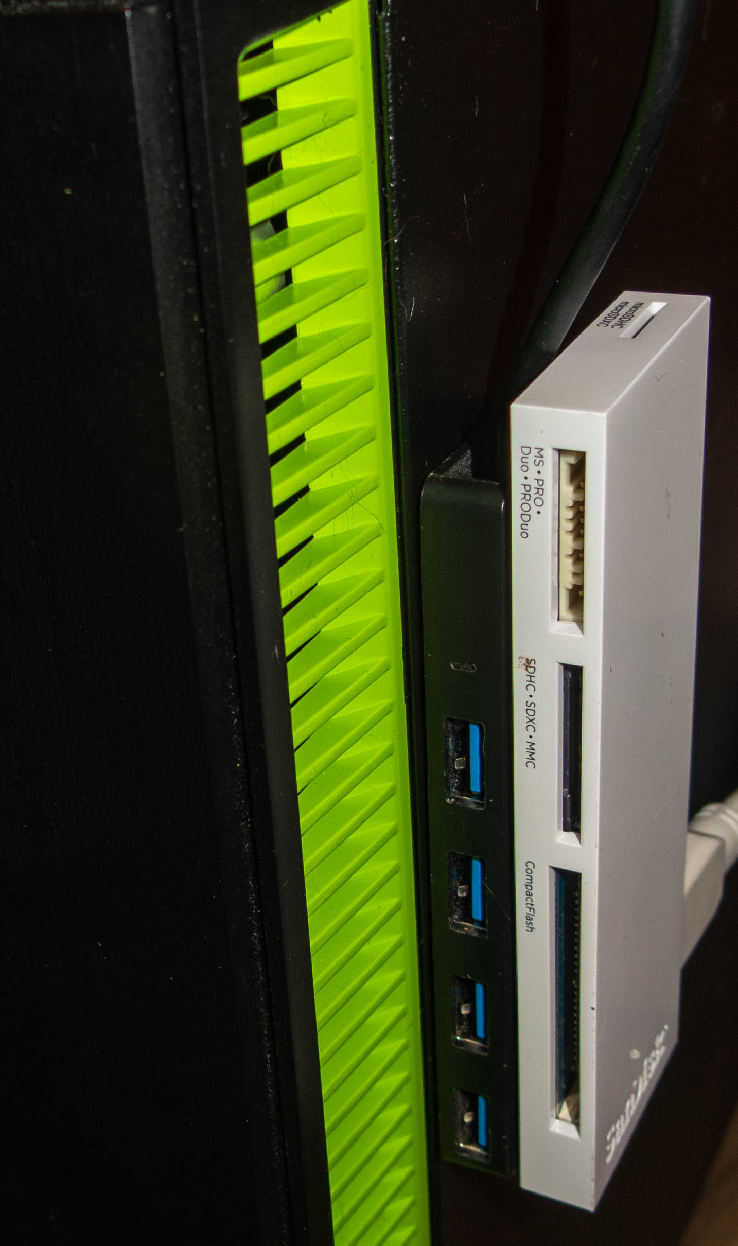

As the 2 top USB ports are not really usable as the PC barely fits under my desk I added a 4 port to the side with 2 sided tape, also a card reader

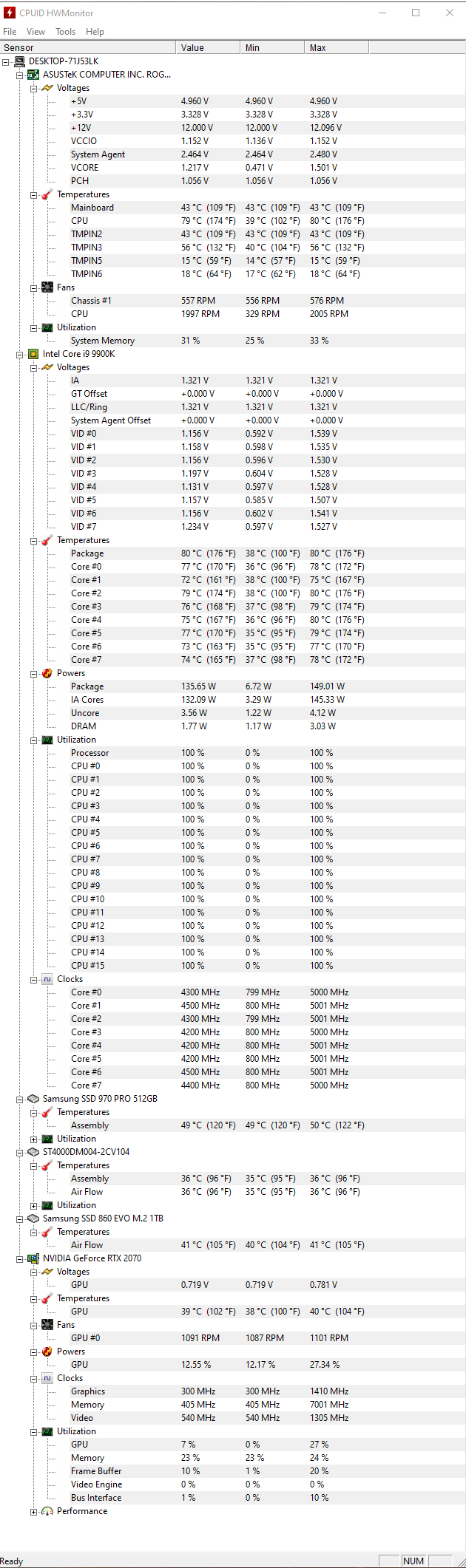

Just did a Cinebench R20 score
I did not very hard overclocking
it is limited on 140% of TDP and 80°C core temperature in BIOS mainly with standard Turbo settings
