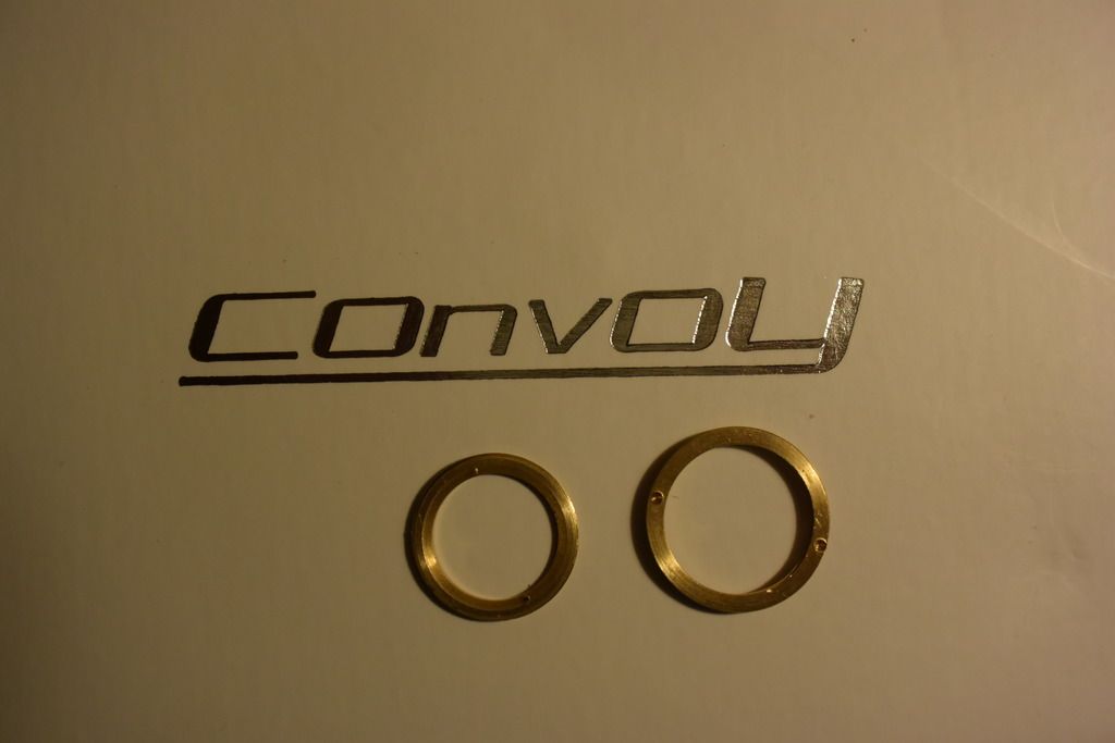

Am I missing something? Having started with P60 pills I was looking forward to being able to exchange a driver without solder mess.
Without a ring
A sizable space around the whole ring.
pg
Thanks for any help
EDIT
I opened up my other L2 and that ring was bigger. I might of got rings switched up.

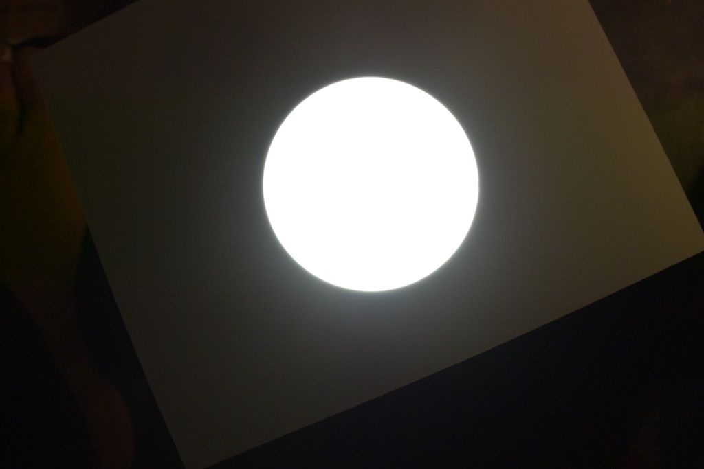

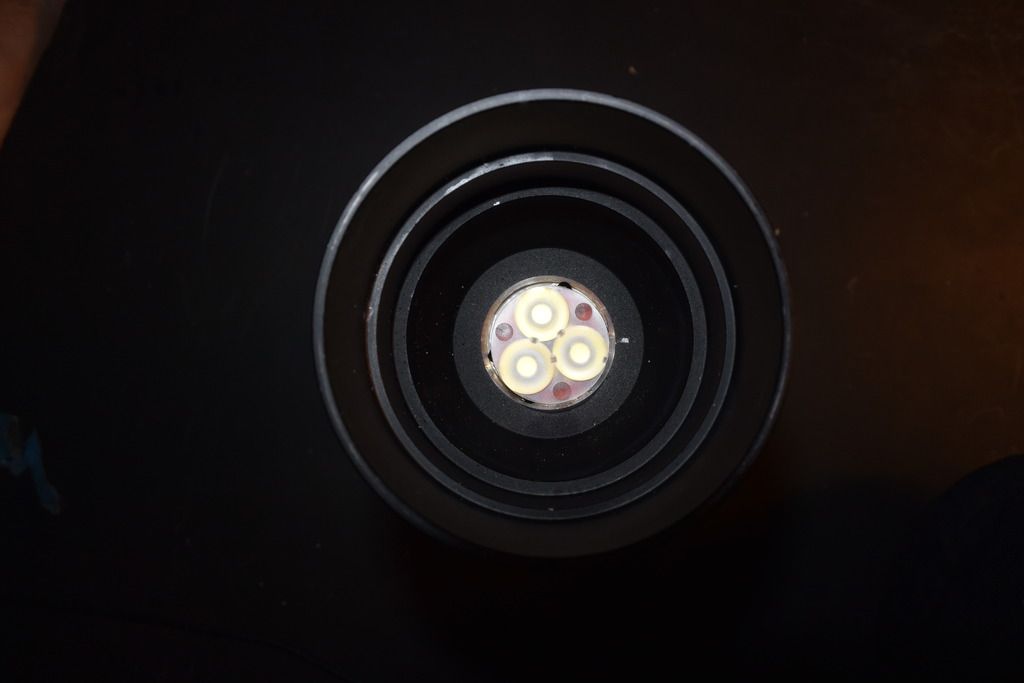

The nice thing about your own mod is that you can do what ever you want.
triple xpl V6 3D, Efest 26650 3500mAh, FET + 7135 Driver - 17mm - MTN-17DDm, and a 10508 Carclo Lens - 3-UP Frosted Medium Spot Optic (xpl mod)
I am thinking about adding a Lowel IP-72 Frost Gel. Heat might be a problem.
Not to sure how PWM will affect pictures, but I would like to use the L2 as way of adding some diffused lighting.
Also thinking about having 5/8” cut off the head. A piece of glass could set on the first shelf up. Without the reflector and bezel this starts to approach a lighter more EDC light. (257.5g) w/o battery
While taking a light meant to be a thrower, and turning it into a flood light might not seem the right thing to do.
The light does have the mass to handle the heat and the Efest has the capacity of the best 18650.
Also the 26650 puts out great amps with less voltage sag compared to an 18650.
I love seeing the abstract ideas that come out of this forum. There is no “wrong” thing to do here. :bigsmile: I love seeing the insanity that mad scientists that make up BLF come up with. That’s what makes this forum so interesting. If you think you can approach an EDC light with this I really want to see what magic you come up with. Carve away and let us know how it all turns out with pictures and numbers!
