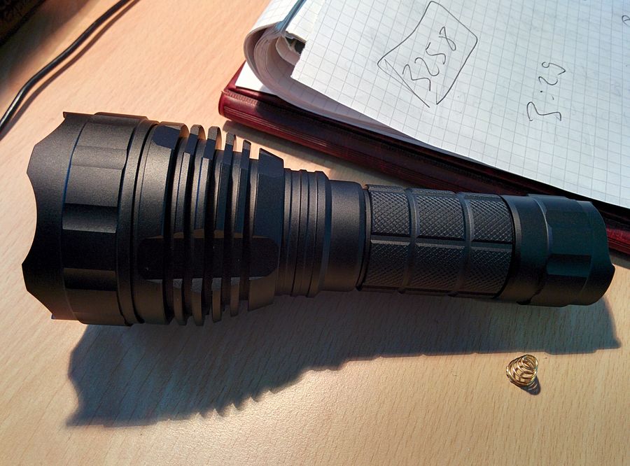

Hi all,
my L2 (new modell from banggood, one cell model with XP-L hi) came today from China and after taking a closer look the spring on the driver side seemed loose and came right of after touching it once, seems they added only a little drop of solder on one corner to connect the spring to the driver… china quality and QA sight so I´m going to do some soldering tonight, I thought about bypassing the spring with some desoldering braid while i´m on it, does this make any sense with this modell/driver or doesn´t it have any effect?
Sorry I´m new to modding…
Thanks,
K.

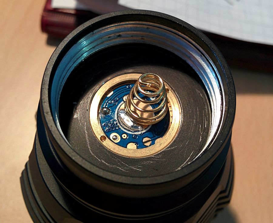

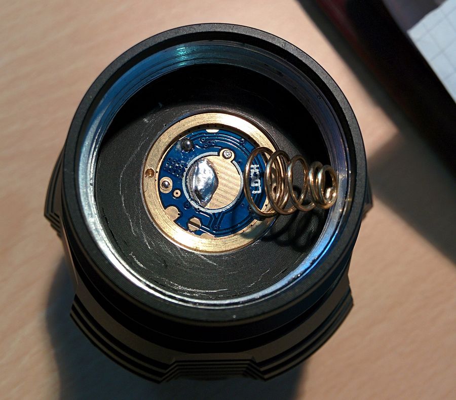

That’s a bit disappointing. If you have the single cell model with no extension tube that’s from the first batch with the LD25 driver. Does it have the block style knurling? I didn’t know they still had any though I haven’t really looked. Could you post a picture showing where the driver spring fell off? If you can solder I suppose it’s not a deal breaker but I would still like to report it back to Simon and show him a picture if possible.

Here are a few quick phone images:

that is clearly not the right spring size for that driver

I wouldn’t call it outdated but yeah it is one version back. The only real difference is the 1 or 2 cell option included in the new model. If you wanted a 2 cell configuration Simon sells the 2 cell tube with two different knurling styles but it would require a different driver. Your driver only supports a single cell. That’s a sloppy solder job on that spring and I agree with PilotDog that the spring looks a little big (diameter-wise) for the driver. I’ll take a look inside mine this weekend and see if that’s a different spring. Yours looks a bit chewed up on the inside too. Was that your doing or did it arrive like that?

The inside is probably been scratched because I unscrewed the tube from the head end several times now, and the end of the tube thread seems to scratch the inside when tightening. I resoldered the spring now (and bybassed the spring just in case) and it works, the spring bottom really fills the whole inner circle completely.
