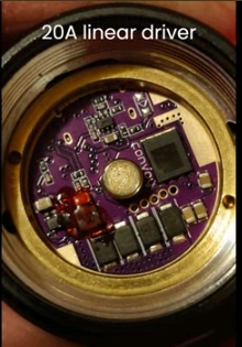

Can I be explained what type of driver M21K uses? Is it linear as this VDO suggests? And super-turbo at 20 A is directly driven?

It’s a buck driver, unsure about the 20A momentary turbo, if it’s still buck or FET (Simon has a tendency to give current ratings to his unregulated FET drivers). I gifted mine before having a chance to open it up.

It’s an asynchronous buck driver ( as expected), with reverse polarity protection.
High/top of the ramp is regulated at 9.85A.
Momentary turbo is regulated at 19.96A.
So it’s fully regulated, no FET direct drive channel for momentary turbo.

do we know if its buck or linear?
Yes, it’s buck. This thread is too long and noone asked Simon so I did. It’s a buck driver.
Asynchronous :-1:, anyway better then linear. :+1:
