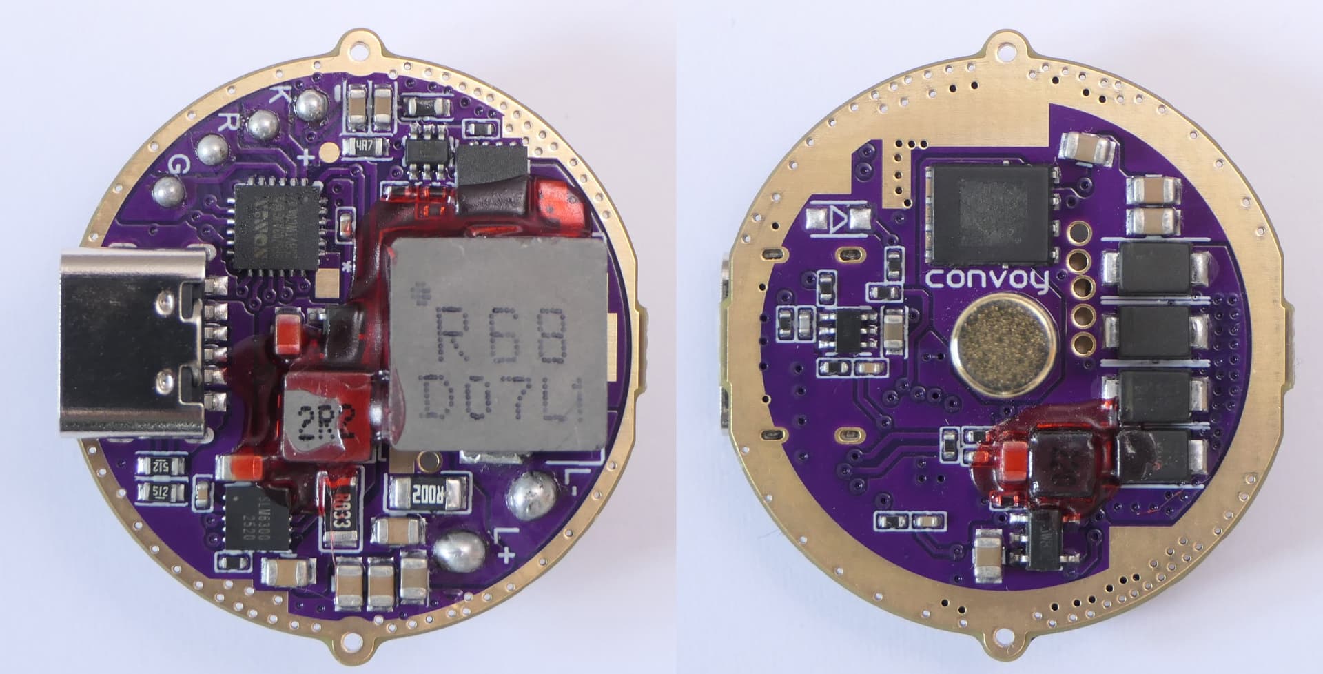

Unless I’ve missed it, the driver doesn’t appear to be available separately, does anyone happen to know the dimensions? I have a short L6 looking for an upgrade.
It’s 28mm, also Simon doesn’t list all the parts he can sell.
Ah, I had hoped for an exact match, if I remember correctly the L6 uses 30mm, this might just work!
I wonder if I can modify a couple of the 20 to 22mm Kaidomain driver adapters to make it fit…
I’ll message Simon asking if he’d be willing to sell the driver separately.
What is this next to diodes? 3th coil?
