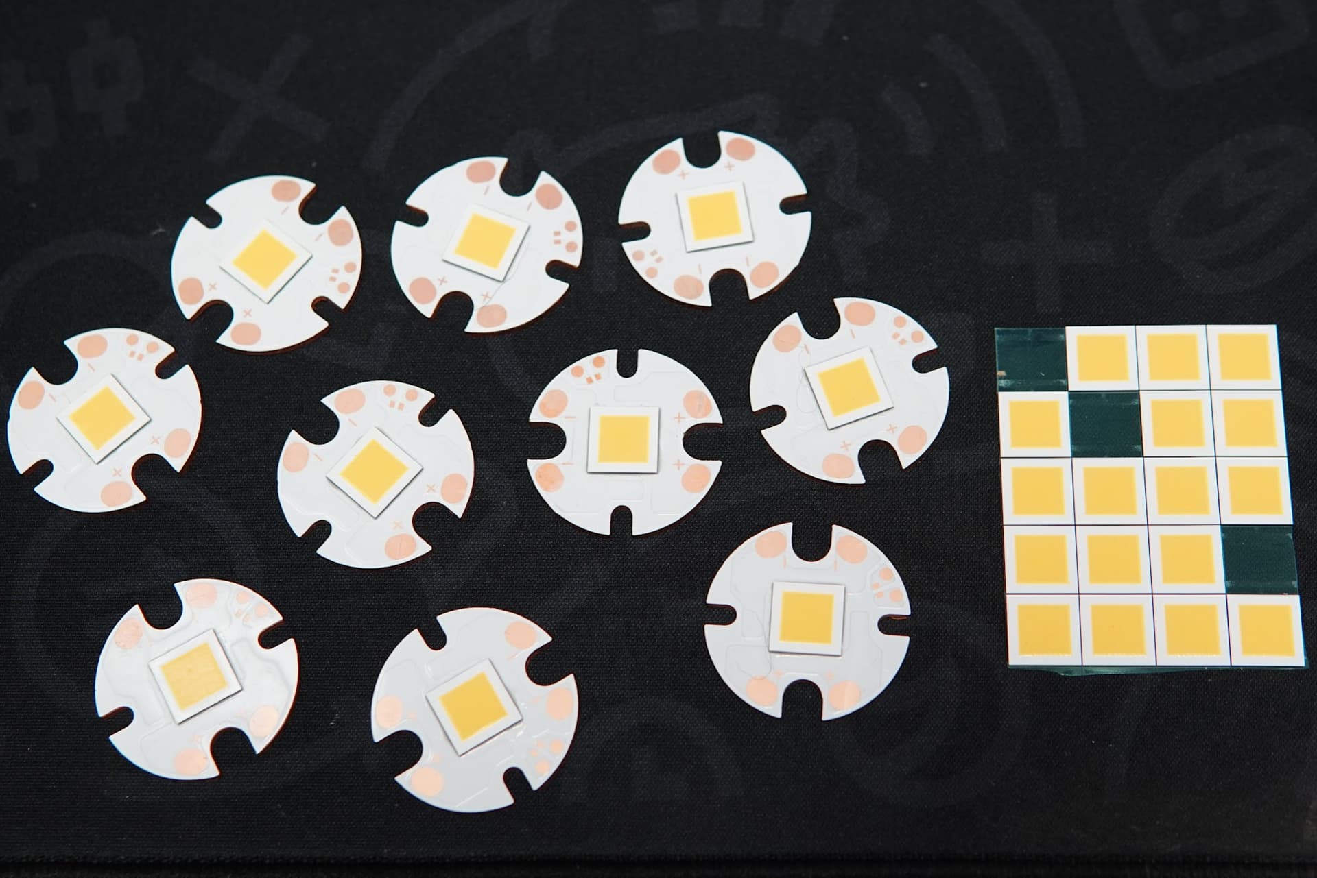

As I’m waiting for the M21K LHP73B, I keep thinking about SFT90 version or a modded SBT90.2 flavour of it.
All other aspects aside, I was curious how these three could compare thermally.
So I looked at @koef3’s tests of the three (the SBT90.2 is not on the master list).
From the 1Lumen review of the LHP73B I figured the TIR efficiency may be some 85% and assumed it applies to other emitters. Then also assumed that the output current to the LEDs on turbo and super-turbo is the nominal 10 A and 20 A (as @thefreeman measured above in this thread for LHP73B) for all on a fresh tabless battery.
Output/Power LHP73B SBT90.2 SFT90
lm @ 10 A 3350 2700 2900
lm @ 20 A 6000 4250 4250**
W @ 10 A 30 31 33
W @ 20 A 63 67 78**
** May not happen in reality as discussed below.
It looks to me that on 10 A turbo they may all heat up at similar rate but the SFT90 on 20 A may be pretty short-lived with the extra 15 watts to dissipate (if the driver can indeed deliver 20 A to it at all).
Does this mean the SFT90 Vf at 20A is 3,9V? Then it doesn’t seem feasible, at least not for longer periods. The driver is buck only, and according to Mooch’s test even the Reliance RS50 drops below 3,9V at 20A in about 10s
