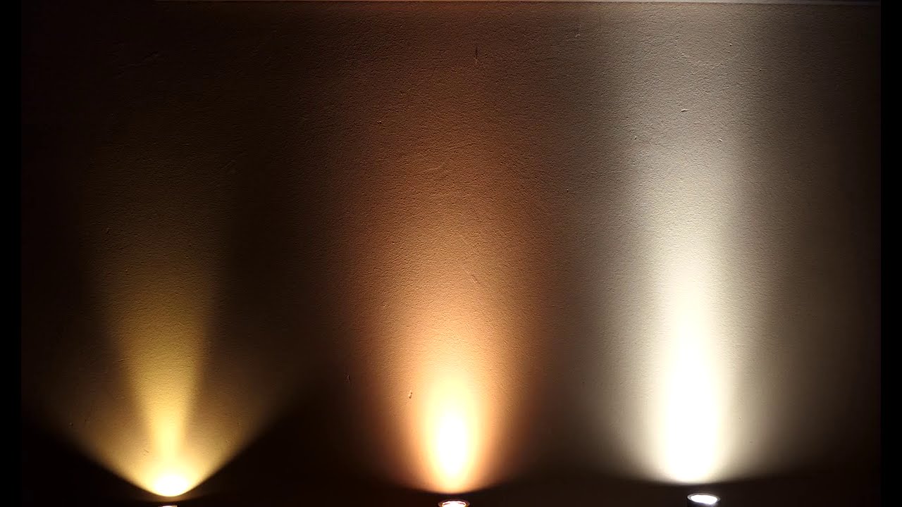

Some wall shot at different tints :
Same but video :
(WB 4500K, left is LH351D 2700K above the BBL, right is sliced LH351D 5000K : 4200K on the BBL)
Color diagram :
Color rendering :
More color saturation in the middle.
So this is much more rosy than my other one with sliced LH351D which is mostly neutral and slightly rosy in the middle. It is very nice but the output leaves a bit to be desired, I could drive the leds to maybe 2.8A (1.4 per leds, max rated) with a 30mΩ current sense resistor (which I dont have
