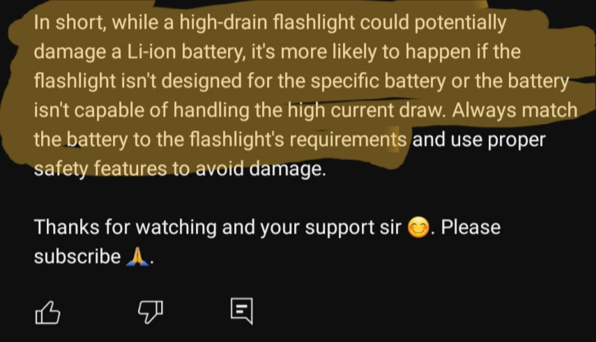

“Ive also had one Lumintop 14500 battery not recover functionality, after testing Turbo repeatedly. I had to dispose of that cell.”
Is that the protection circuit that caused this? or did it get damaged from not being high enough CDR?
I feeel like i keep getting mixed information, or I just keep misinterpretting things…
I’ve been reassured multiple times that having to low a CDR in a light that pulls high amps is not that big of a deal, but now I’m wondering if they’re wrong?
I’m constantly getting information that convinces me that I’m “safe”, and then more information that suggests that I’m not…
Example of that last time I was reassured I was “safe”
Now I’m thinking I will kill my cells trying to put them in flashlights they dont have a high enough CDR for.
I feel like a crazy person. Constantly flip-flopping between - “My flashights are safe.” — “Oh no, theyre dangerous!” — “Oh no, they are perfectly safe!” Im gonna accidently kill my cells" — “Oh, no Im not, I just misinterpreted what I read.” — “Its defnitely possible I’m gonna kill my cells…” :frowning:

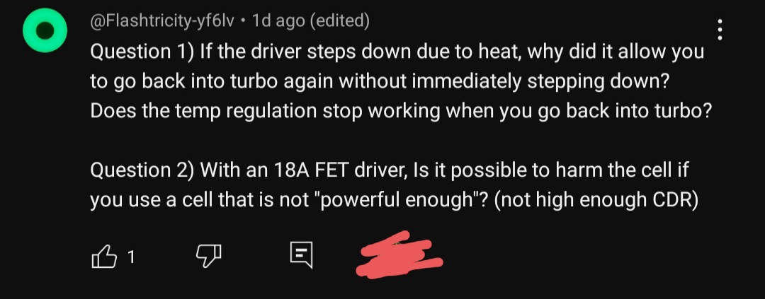

The D3AA draws 3A at level 7 of 7. The Only output on a D3AA that uses more than 3A is Turbo.
imo, Turbo is counter productive. It generates excess heat, so the light has to step down. The excess brightness closes down our pupils so we are less sensitive to lower brightness. The net result is a brief event of excess brightness that is not sustainable, creates excess heat, and leaves us flash blinded so lower outputs are less effective for us. Turbo also drains the battery extra fast ;-(
I am the Anti-Turbo ;-), for me, a better strategy is to just disable Turbo completely. My priority is Sustainable Output, and prolonged battery runtime.
otoh, if Turbo is important to you, the H10 battery w CDR of 10A will achieve a higher maximum output.

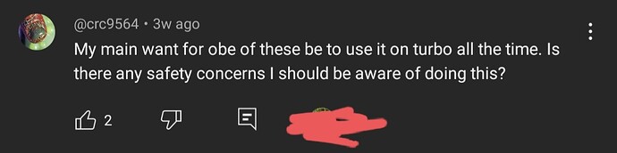

I agree with you on turbo use with certain lights, but with others I plan to use turbo a lot. I want multiple D3AA’s in different configurations.

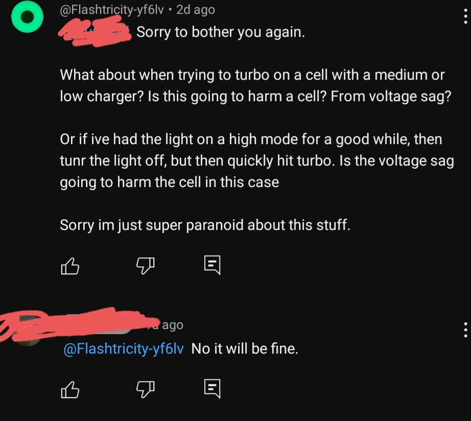

Not having a serious in-depth understainding of how cells and drivers truely work leaves me constantly worried that I might use my lights in ways that possibly damage cells. (From from voltage sag?)
Example - Trying to use turbo on a Cell thats already at half capacity and was just turned off from a long period of use on a high mode where the Cell is already in a state of recovering from voltage sag. Then turbo puts a real strain on the Cell?
And more specifically, with a cell that doesnt even have a high enough CDR for what the turbo mode wants.
I keep being re-assured that I should be fine, so I’m trying to have faith in that and not worry so much about it, but certain use cases are always having me think… Is this where it may actually be harmful to the cell? (like what I just described above for example.)

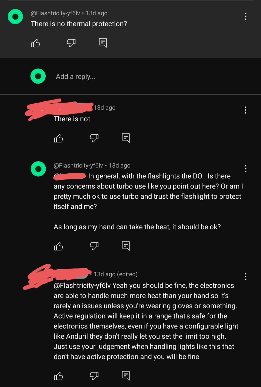

You seem to be assuming that Turbo will Draw as much power from a 3A CDR battery, as it would receive from a 10A CDR. I think that is a mistaken assumption, because imo the Turbo does not Pull power, it just receives the most the battery can deliver.
Please look at these posts…
about batteries in a TS10
and about fire hoses
Im happy to continue to learn more with you by continuing our exploration in that thread
3A CDR doesn’t mean the battery outputs no more than that, it means it’s safe to pull 3A constantly. Battery can output as infinite current as possible (I’m simplifying) and only resistance of the circuit including its own internal resistance stops it.
Vapcell’s H10 has impedance 17 mOhms. Although dc resistance is likely higher, short circuit current still can exceed hundred amps. That current will drop pretty quickly with voltage sag but still will be enormous.
Your 60s test isn’t long enough to see the difference. Also TS10 isn’t a good test stand for batteries as it pulls high current for about 20 seconds and then steps down, so the current remains within battery’s CDR range. And in this test case the flashlight is the main source of heat and not the battery, so in some sense there is indeed no difference between 3A and 10A batteries.

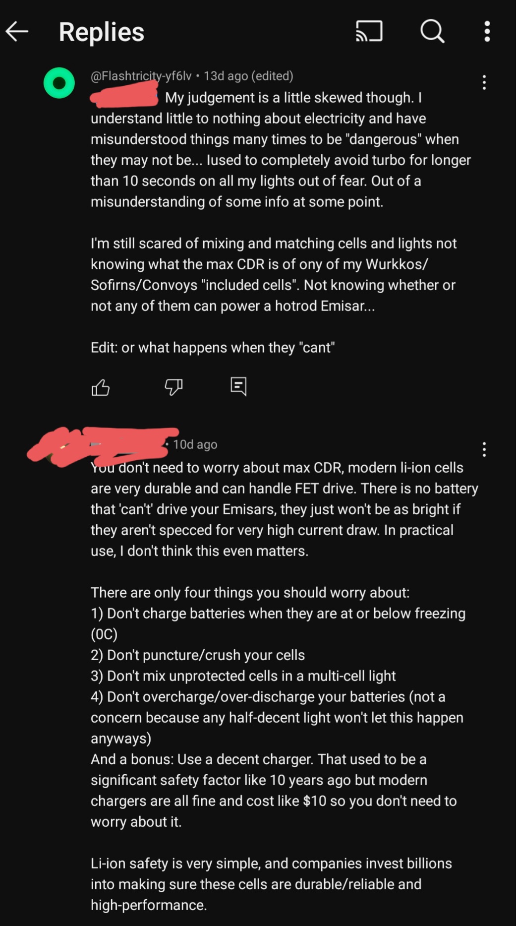

Yet earlier, that same person told me this…

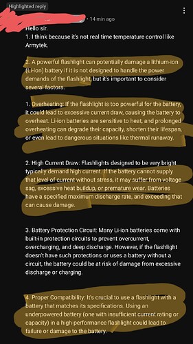

Short of being able to truely ueally understand this stuff myself, im left trying to take others word for things. But I aways get reassurance both ways.
Its safe. Its dangerous. You wont damage anything. You will damage your cells.
I spent the last week over the moon feeling confident that my worries were all misplaced and that I was truely safe to continue foward with all the lights again. I just spent $200 on new lights to re-start my collection again.
Now, before theyve even arrived, im again convinced of theyre dangerous and Im too afraid to even open orbuse them again…
Its just hopeless for me.

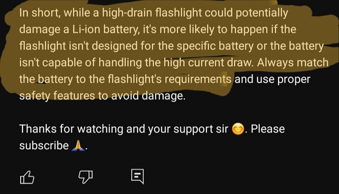

Exceeding the CDR rating of the cell for continuous discharge, as the name implies, will absolutely damage the cell and shorten its life expectancy. By how much depends on the cell chemistry, the amount of overcurrent, the length of the overcurrent etc and can’t be put in clear numbers. Sometimes the datasheets of higher quality cells indicate how many cycles you get at varying discharge currents, but that’s rare.
Exceeding the CDR for short bursts does not really damage the cells, as the CDR is the limit for continuos discharge after all, and most cells have ~2 times CDR for burst discharge. (Note: this does not apply for protected cells, those usually just shut down entirely on overcurrent disregarding the duration).
For lights like the D3AA that can sustain turbo only for a very short time before overheating and throttling, exceeding the CDR should be pretty fine.
In other hosts that can hold turbo for longer times I would not use cells that have a CDR lower than the turbo current.
Protected cells you can just use in any light. If they are overloaded they will shut down, and no damage to the light or the cell should occur.
