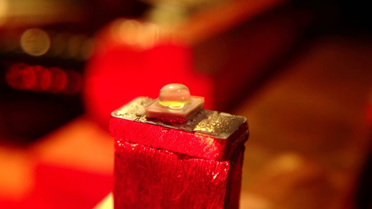

I made an adjustment light from scratch (no, not my entry for the OL-from-scratch-contest ;-) ). It had to shine into the hole on the side, occupying as little inner surface of the sphere as possible. Here's the ugly thing that I came up with, soldered together from copper, running on a 2x7135 board on a 14500 battery, the led is an Oslon Square 5000K that I had spare and is even a bit smaller than a XP-G. It was reflowed on a trimmed 10mm Sinkpad. The 'head' was simply made white using Tipp-ex correction fluid.
I thought it was nice to make a video of the reflow of the led on the board and the board on the copper pillar, so here's some reflow porn ;-) :
