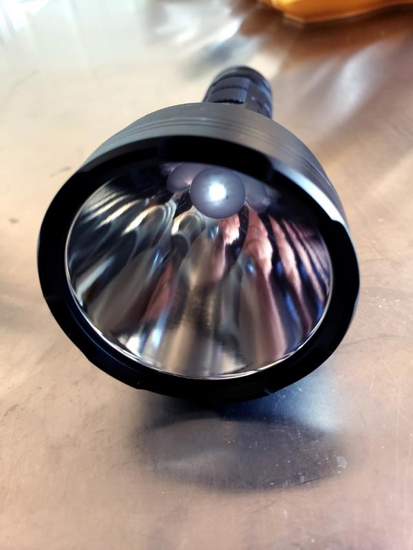

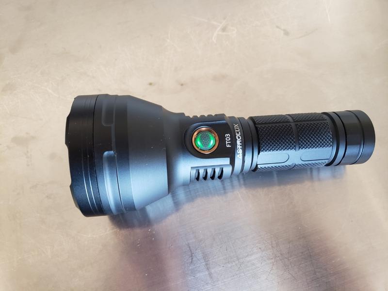

I just received my FT03 which came with unglued bezel and perfectly centered LED…
Then everything went wrong very quickly.
I threw in a Samsung 40T 21700 and turned it on. It responded fine and I ramped it up to the top of the ramp. From my eyes it appeared brighter than expected. I double clicked for Turbo and…
The light shut off. The switch was blinking (I didn’t count how many blinks)
I tried to turn back on and no still off no response. I unscrewed/rescrewed the tail cap and it again responded to the battery offering a blink (extremely dim). I clicked and held for ramp and it does indeed ramp up and down but it’s now only putting out about 10 lumens on the top of ramp and the bottom is unbelievably low.
I switched out my 40T and threw in an LG HG2 and it does the same thing.
If I go to the top of the ramp and double click for turbo (either cell) it blinks but doesn’t change output. If I double click for strobe after turbo it blinks again but doesn’t strobe.
It clearly looks like something fried the second I tried to put it into turbo. I double checked this thread and saw that Tom E did some testing with 40T’s and didn’t experience this issue.
Any ideas? Things I can check?
I tried a factory reset through the UI and it did nothing
also unscrewed the battery tube and tail cap, checked for debris or dust and re-screwed firmly no change
