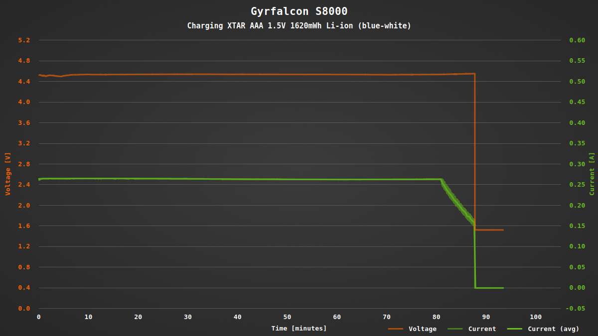

Today I have tested the 1.5V Li-ion charging and discharging program. Here is the result of a charging run:
And here the same battery with a different charger:
As you can see there are some details that must be fixed in the S8000 (like available settings and default value). I will explain the details via email.
