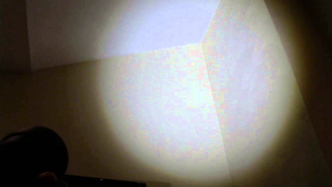

well i got my order from Richard over at Mountain Electronics. 5000K MT-G2, 22mm fet driver. copper braided tailcap spring. running currently off 2 laptop battery pull Samsung 18650 with 26650 spacer tubes. have some unprotected 26650s on order. light turned out awesome till i accidentally de domed it. didnt make hole in centering ring big enough and when it was on it cracked the dome and after a little bit of running and heat it finally came off. oh well, got another mt-g ordered so i will fix the ring and put it back together. took the phospor and all. light still works but its like ultraviolet now. haha. anyway heres some pics and a video
It looks like a UFO where your moving it around on the wall near the end of the video. I've never been game to dedome an MTG-2 so looks like you have nearly perfected that as well.

video was before the de dome. haha ill get some pics
