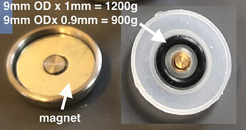

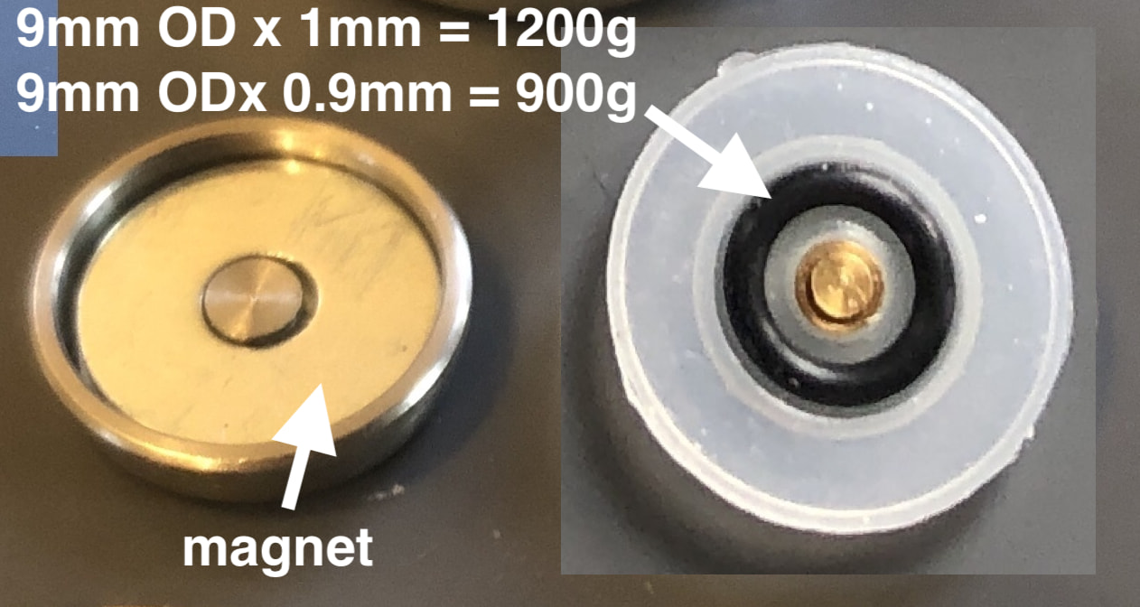

fwiw the new switch from hank has 900gm pressure. I can duplicate that with an O ring that is 0.9mm thick, on the original switch, with a button that has a magnet. It is an easy pressure to use, and is double the stock original switch pressure.
I have been using some O ring mods with the original switch on my V2 that has a magnet.
first I tried an 9mm OD x 1.5mm, it gave very high pressure of 1600gm. This is too high for me.
then I experimented with sanding the O ring to be thinner, which works much better for me.

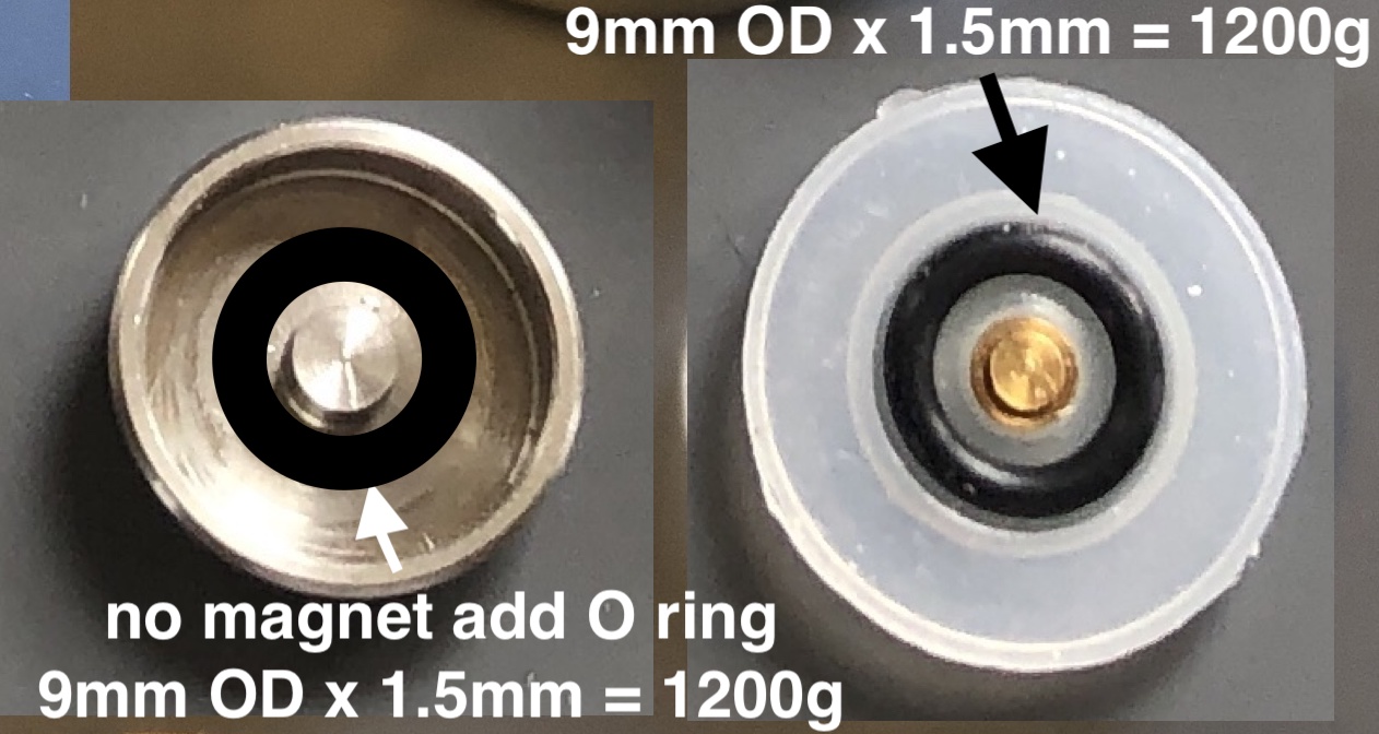

at 9mm OD x 1mm thick the resistance pressure is 1200gm. I like this. It only works if the V2 switch button has a magnet. Or if there is no magnet, use two 9mm OD x 1.5mm thick O rings, one inside the switch button and one on the silicone dome cover.
for V2 button, modify original pressure switch w O ring:
if no magnet on V2 button, add O ring to button cup,
plus O ring on silicone switch cover:
Warning: Do not attempt to modify the switch unless you accept the risk that it wont work after the mod, unless you learn how to adjust it.

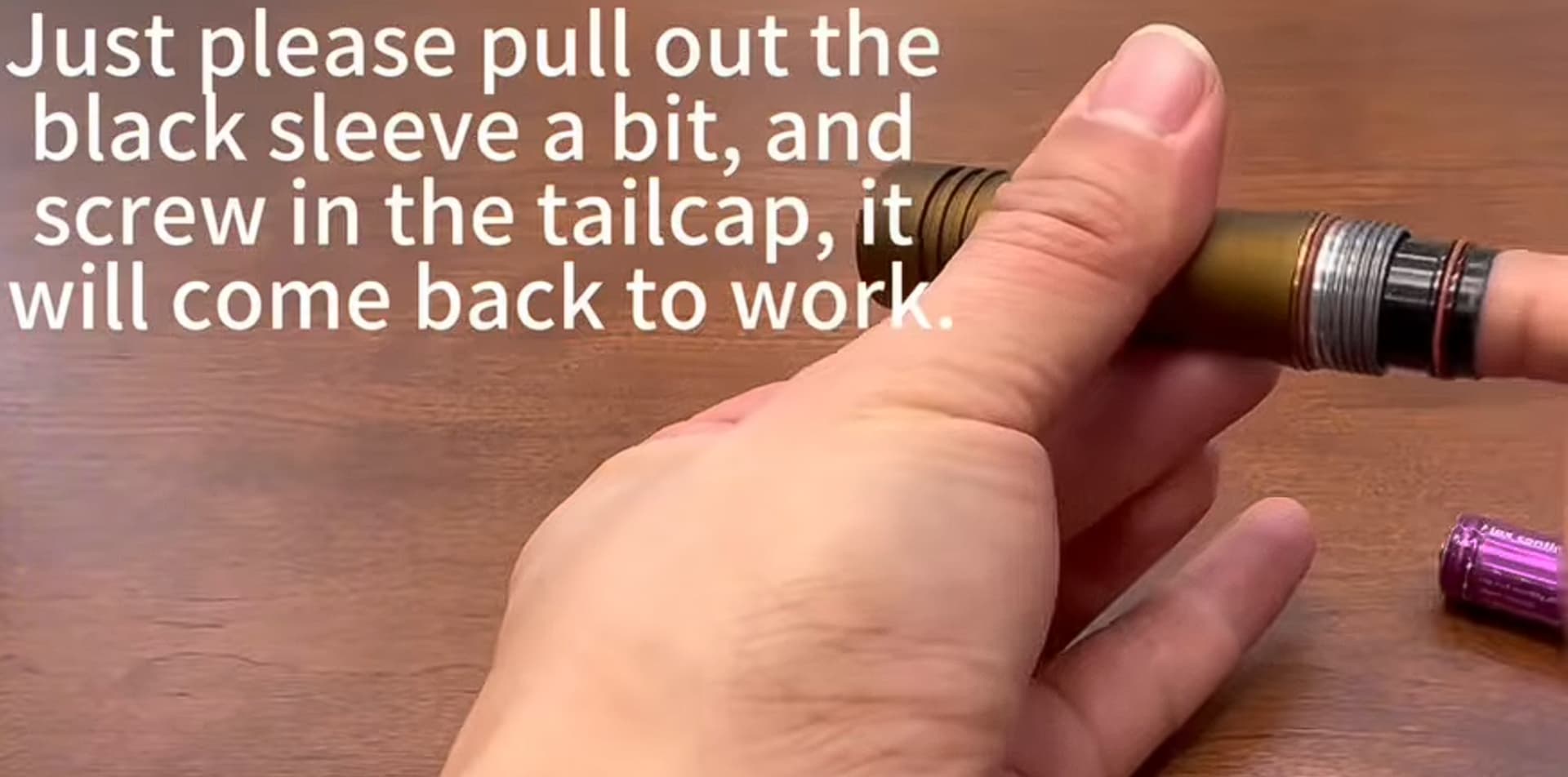

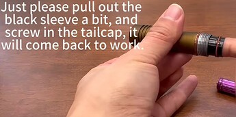

After doing the O ring mod, if the light gives triple blink error when closing, getting the switch to work correctly, requires adjusting the retaining ring tension, and getting the inner body tube set to the proper depth to make good contact.
The main things to keep in mind are, after first closing the retaining ring tight, if the light gives triple blinks, loosen the switch retaining ring very slightly, and then before closing the tilcap, pull the inner tube out so it resets itself at the proper depth when closing the tailcap. We need the light to give one single flash when closing.

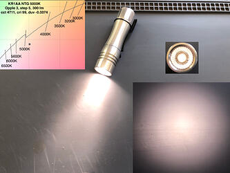

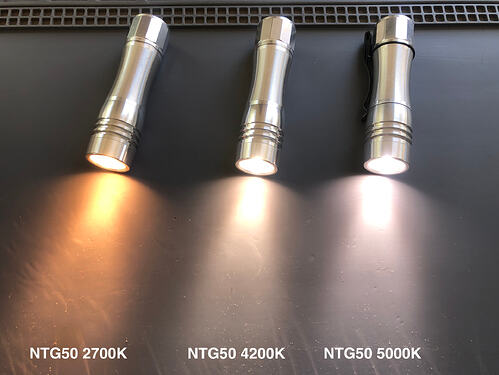

here is the new 5000K:
to me it does not look as rosy as the photo. When I shine it at a white wall during the day, it looks mostly white, with just a slight hint of rosy, if I look for it. Im very happy with it. The duv of -0.0074 is not excessive for my personal preferences.
For daytime EDC I like the NTG 5000K better than the NTG 4200K.

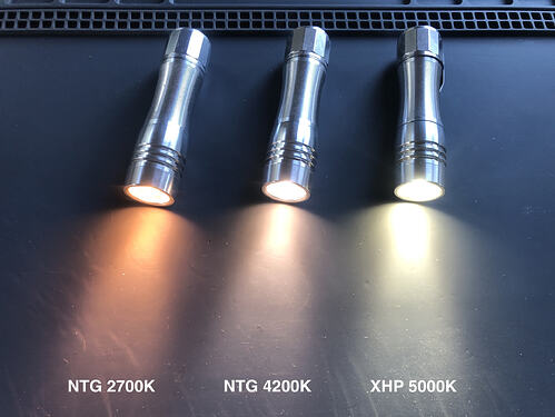

previously my 5000K option was an XHP, on the right:
I did not like the greenish tint so I decided to remove that LED, and install the NTG50 5000K. Im very glad I did.

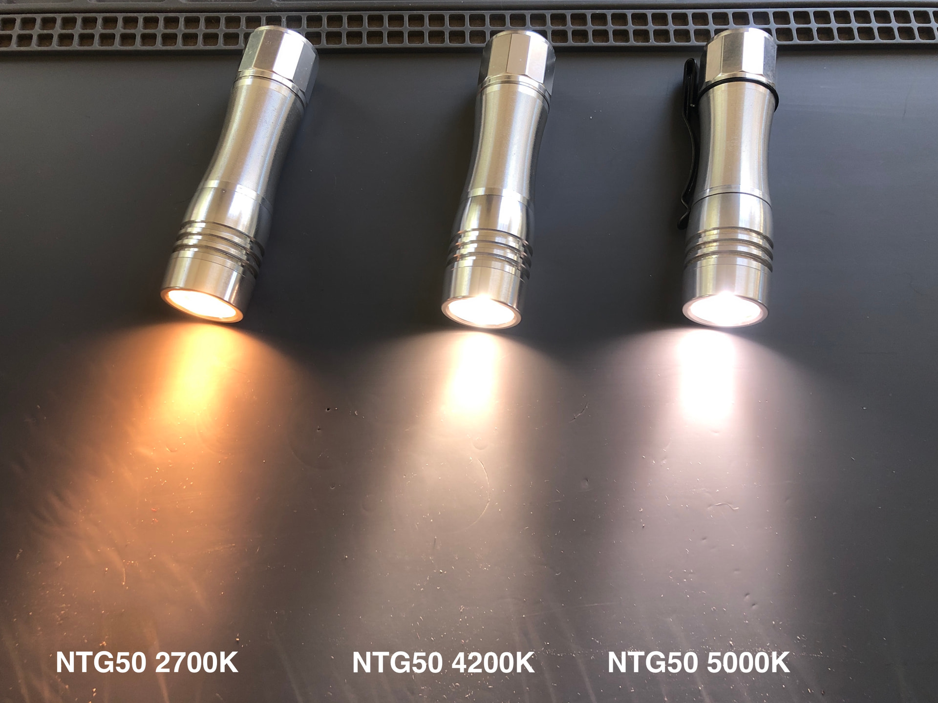

these are my 3 KR1AA now:

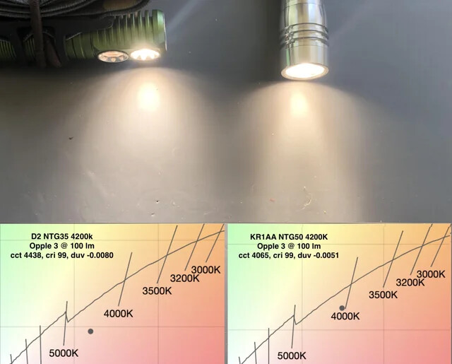

Do you happen to have any NTG35 emitters? To my eyes, the NTG35 5000k is incredibly rosy to the point that it doesn’t really look like white light at all. I’m wondering if the NTG50 would be roughly the same or more neutral.
some people react the way you do..
Im not sure why.
Here is a comparison of 4200K. I dont find my NTG35 too rosy, and I dont find my NTG50 too rosy either:
fwiw, comparing with my Opple 3, the NTG50 4200K that I received last week, is warmer, and has lower duv than the NTG35 4200K that I received last summer.

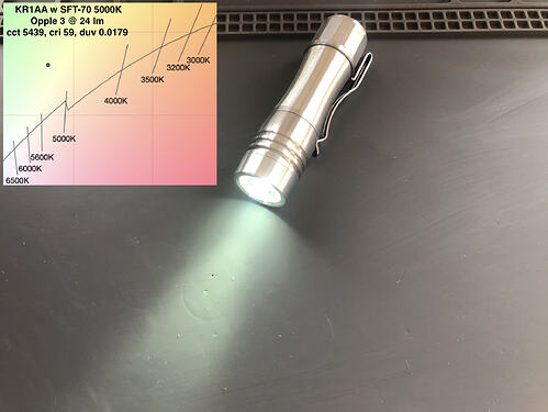

I had SFT70 5000K.. it was greener than I care for:
typical Low CRI and green tint. Works fine outdoors, makes foliage look nice and green, and it is bright.

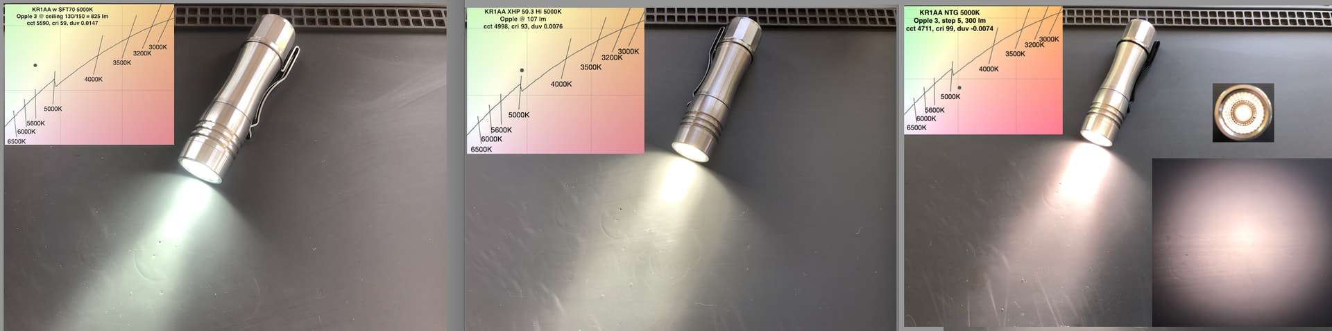

5000K; SFT, XHP, NTG:
