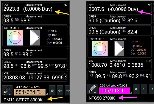

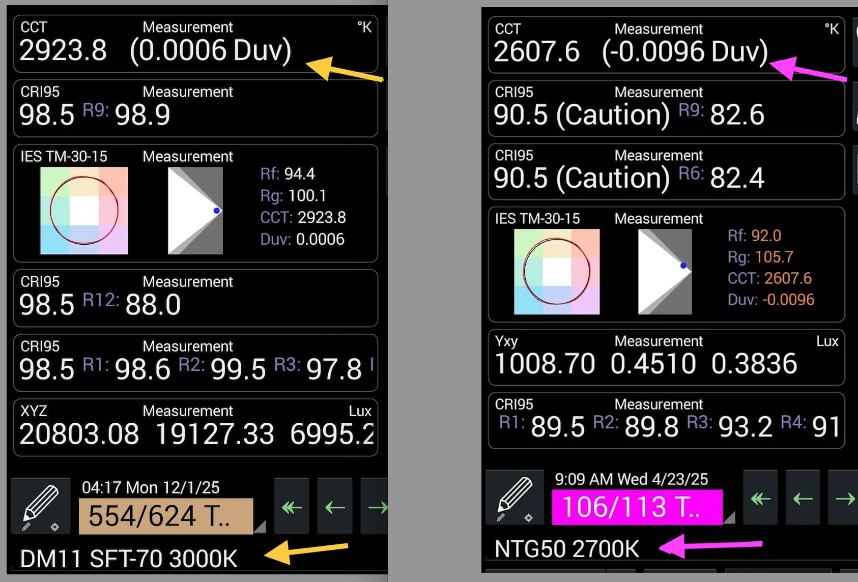

after further research, Im still undecided about SFT70 3000K, and just added NTG50 2700K to my list of possible warm options..
charts from here and here
arrows on the DUV and LED model: (I dont usually like tint at the bbl, I prefer below, heavily influenced by sw45k of old)
Im afraid its already over because the more rosy D200 bin has been gone for a long time. All Ive seen lately are the less rosy D220, which look slightly greenish by comparison.
This is why the NTG 4200K is on my radar.. it has the rosyness of older sw45k
but I already have mostly sw45k lights, and only two 219b 3000K lights (that I wish were more rosy) .. so Im shopping for a Warm KR1AA, for use at low outputs as an indoor and nightstand light..
Since I prefer rosy, NTG50 2700K seems like a better option for my intended indoor use at low outputs, than SFT70 3000K..
