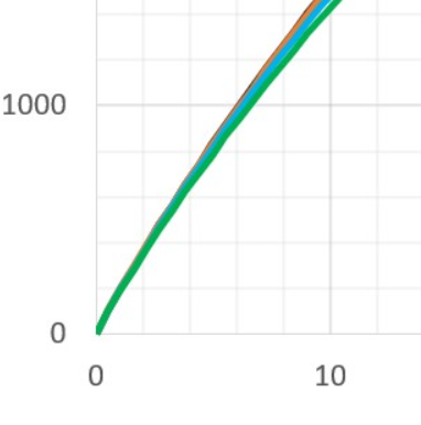

From the power comparison:
This means, they all achieve around 160Lm/W at 10W, right?
So essentially we’re talking about XHP50.3 equivalent when it comes to brightness but with much less throw due to larger LES. All of them also seem to be below the minimum for the W3 bin - 520lm at 1A, 3900lm at 9A, meanwhile your samples scored below 3400lm at 9A. I’m not impressed.
Efficacy at 10 W:
1800 K: 113 lm/W
3000 K: 142 lm/W
4000 K: 148 lm/W
5000 K: 152 lm/W
6500 K: 153 lm/W
The 5000 K variant has almost the same efficacy as the 6500 K variant.
