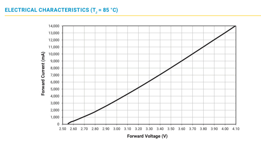

I wonder how the Cree XM-MR compares to sft42r, XM-MR is rated for higher current at 14A but Vf is much higher unfortunately
No, reflowed it myself on Convoy board.
The XM-MR has really high Vf, pretty sure the 14 A are the maximum possible current while using DTP board.

Ok so dumb question: is that 14 amps the “peak” or did you cook the emitter at 14 amps? I ask because I have a Convoy L21B with the 20A driver and SFT42r: I don’t run it at 100% all the time but it hasn’t burned up yet. So, while I am aware the 20A doesn’t actually output 20A, does this mean its output is 14A or lower?
