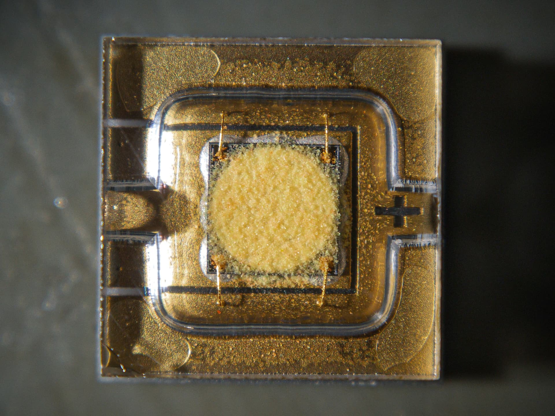

Visually, this color rendering index also seems realistic - because normally LEDs with low color rendering have a yellow-green phosphor layer, while the variants with high CRI have a more reddish-brown phosphor.

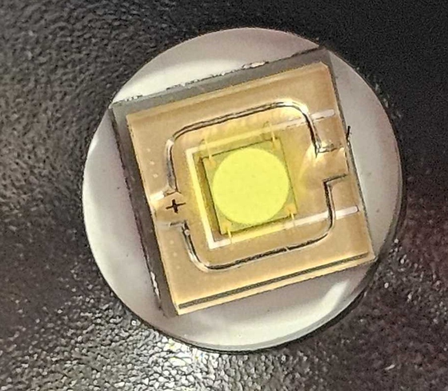

On the left of the LED board is the variant with high color rendering, on the right the low CRI variant, which I had already tested. The LED chip is identical to that of the previously tested low-CRI version. The substrate and the patterns on it, including the plus symbol, are slightly different. It is unlikely that these LEDs were assembled by the same manufacturer. The phosphor is covered with a kind of “glass cap”, which also serves as a lens. The surface of this cap is made of anti-reflective glass (AR).
At low operating current, a highly granulated luminous surface is visible. The phosphor coating is applied very thickly here; this appearance at low current is typical of high CRI LEDs.

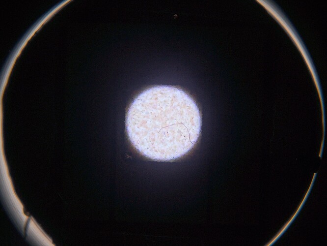

Is that a hair on the phosphor?
Hopefully on the outside of the glass cover :smiley:

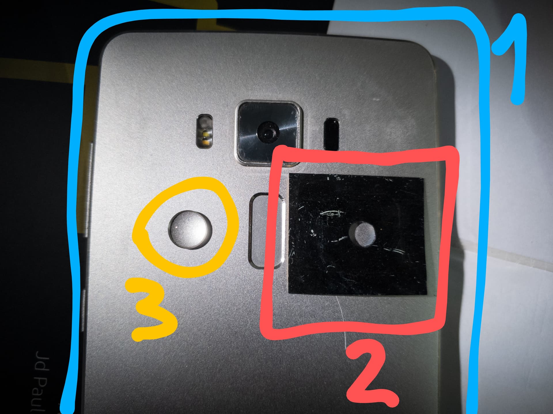

@TUIG101 what device do you use for these macro shots?

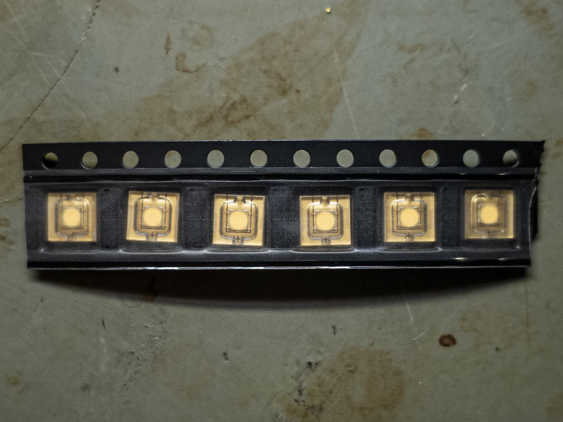

I think these are the LEDs @1stein ordered (5500 K, “only lamp”):
However, it seems to be important to tell the store in advance exactly which LEDs you want (95 CRI, 6500 K), otherwise you will only be sent random LEDs in the CCT range.

Yes, i removed the glass lens from it and this particle got on the surface. Nothing smoked at maximum power so I’m going to left it like this.
There’s these little hand blowers used for cleaning the inside of a DSLR camera, you might be able to blow the hair away using one (or something like it)

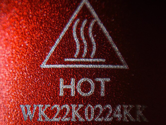

1: Old phone with high resolution (23MP not binned) camera
2: Random piece of black plastic with a hole
3: Random lens from a broken surveillance camera
Device assembled:

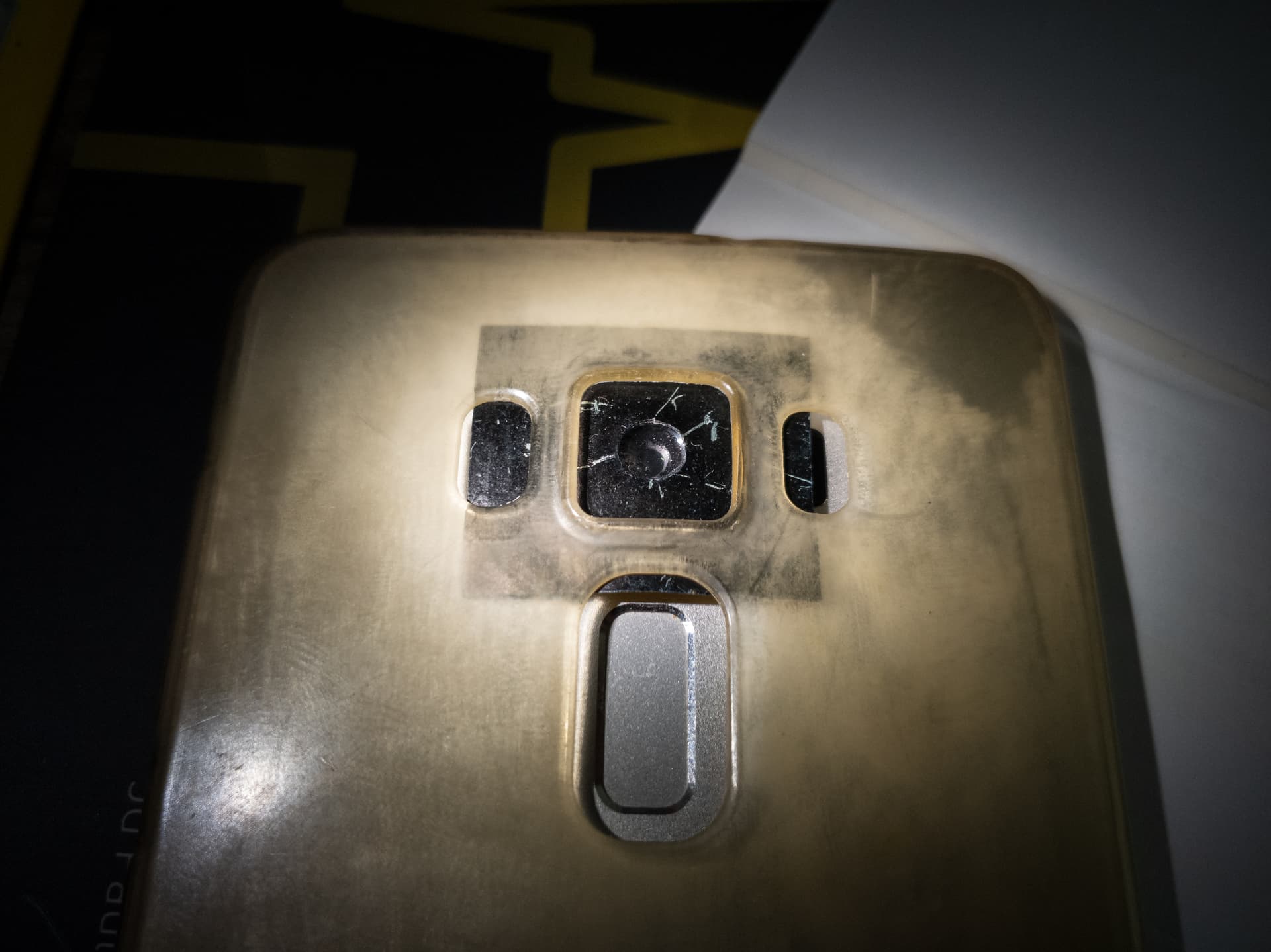

What it can see without my ghetto microscope contraption:
What it can see with the contraption:
2x crop:
I messed up…

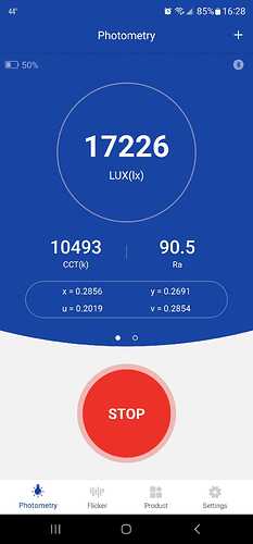

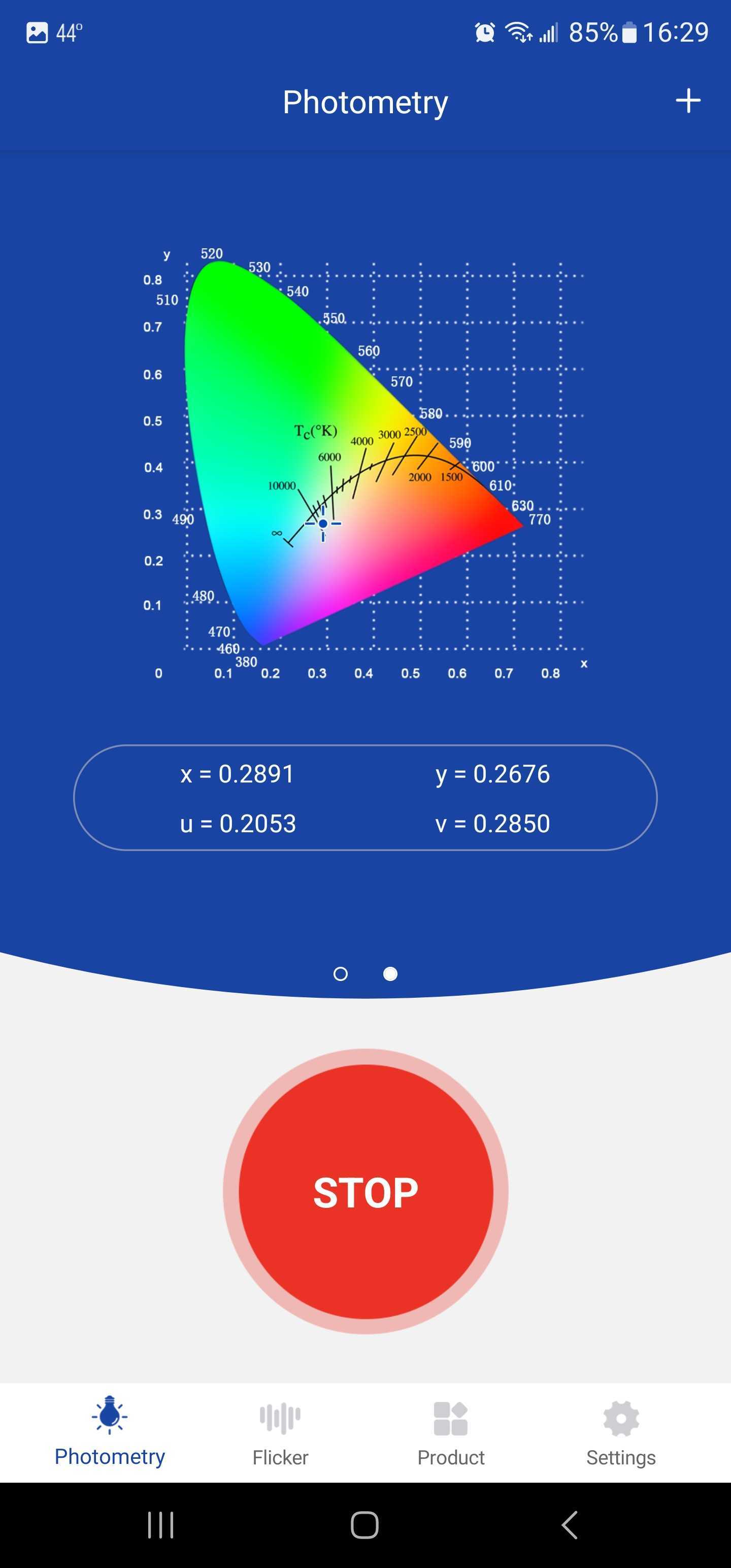

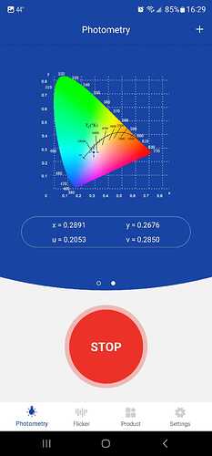

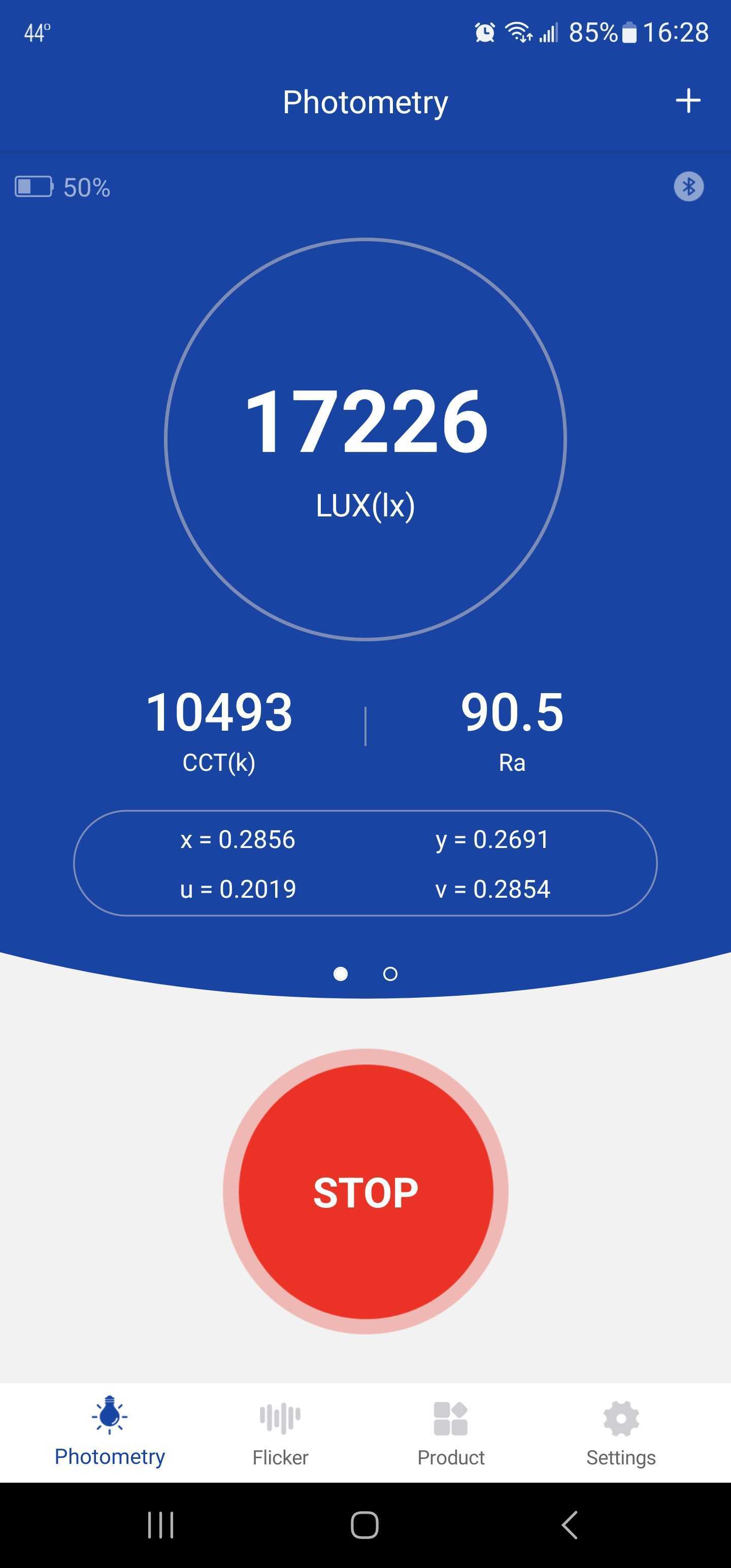

I have in my possession two examples of an LED which appears the same visually, but my Opple tests at close to 90 CRI and nearly 10,000K color temperature. Is anyone familiar with it?
Calculated duv -0.0171 but at 90CRI and >10,000K CCT?!
