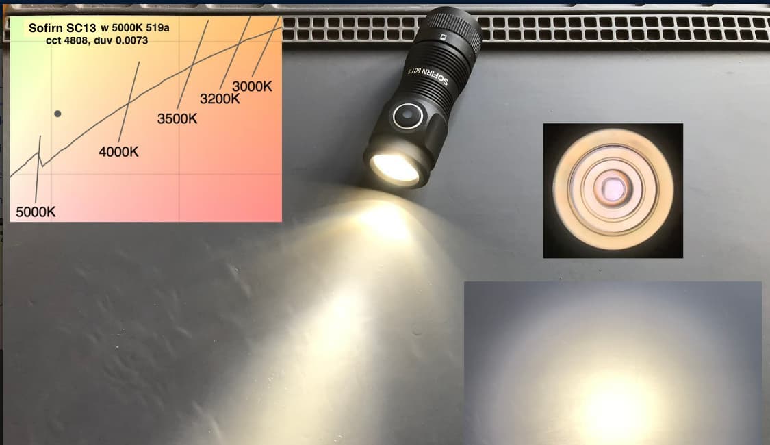

Beam profile and quality
The Fresnel lens gives a decent beam. It has sufficient throw for the kinds of things such a small light would likely be used for. There is enough spill to light up a hallway well enough on moonlight mode to safely navigate around the house. Though I will say that it produces some rings if one is white wall hunting. Nothing distracting in actual use.
SC13 Nichia 519A vs SST40
Compared to the SST40 light the 519A has a much more pleasant tint. Colors are more accurate. I like the beam pattern more as well. You lose some brightness, but the 5K 519A is just much nicer to use.
